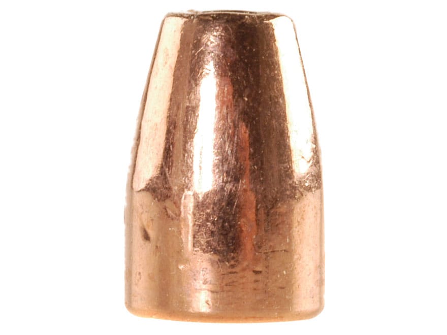

OK. It seems nobody here recommends JHP reloads. I bought a thousand rounds of FMJ a few years ago and that will probably last me a lifetime. But I wanted try reloading my own ammo anyhow and I thought it was a good time to use JHP. You know, use the FMJ for the range and a few JHP for SD. But you guys talked me out of it. Not because of the legal aspect of it, because i really don't find that very compelling, but for reliability as BassBob has stressed.
Is there a bullet you would recommend for FMJ reloads?
Speer TMJ 124gr function the best in my g17, but in my s&w m&p 9mm core Sierra and Hornady 115gr function better. I reload 90, 115, 124 and 147gr in the 9s. Knowing what works/functions best for your gun is key! Even if you find the better bullet you then need too find which powder for best cycling. You're more than welcome too reload hp, but most just use fmj/tmj for the range. I use both, because training for both is good! I'll stay away from self defense reload comments!
Suggest looking for Berry Bullets or other plated bullets based on price; your LGS or online. Check Berry's website because they say you can load their bullets using lead, FMJ or plated data. That opens up other powder recommendations; check the XTP data for 115 and 124 bullets in your Lee manual. Since you want reduced loads, try their starting loads. Don't go crazy, do 10-20 and test before loading up 500-1,000. I've done the latter and regretted it. Berry's offers RN and FP.

Almost all of my 9 124gr and 40 165gr reloads are HP. I use Xtreme bullets or Hornady XTP.
My 45 reloads are 230gr RN until I get comfortable enough before going to other grains.
I plan on building some WC's in 45 just for fun.
RMR makes state of the art handgun bullets that are reasonably priced.
Speer TMJ are excellent for indoor ranges.
For reduced penetration and ricochet, Federal EFMJ are the best thing I've encountered. The LE loads are getting hard to find, but the civilian loads are often sold under names like Guard Dog.

I'm in almost the same scenario just a year ahead. I have been using SNS coated 115 gr or Everglades copper coated. Very low cost for high volume plinking. For self defense practice I use SNS coated 147 gr flat nose or sometimes I'll splurge for Everglades 147JHP. In both of the 147 gr scenarios I developed a load (using chronograph) that replicates the velocity of my go to SD round (Speer G2 147 gr JHP) in my EDC gun. For a 400 rd class, I'll use the flat nose. For a 100 rd day at the range I'll use the JHP. Once a season I'll cycles the G2's in my gun out and shoot them up so 50/year of the real deal and buy a new box. Just economics.

I buy Berry's for range ammo and Hornady XTP's for HPs. Sig E-lite V-Crown for carry. They are the best HP I ever tested. Perfect expansion everytime.

Biggy, lots of comments here and all are worthwhile. Regarding POU (philosophy of use), you should consider reloading your range/practice ammo and use OTC retail ammo for self defense.
Find/choose the round you want to use for self defense by whatever method you wish. Get the specs on that round, primarily muzzle velocity and 10 yards (or whatever distance you want). Choose one that is as accurate as you desire from your specific pistol. You might be surprised how one commonly available defense round shoots 2" left while another shoots 2" right from the same pistol.
Then test out cheaper FMJ rounds that match your "carry" rounds in velocity and accuracy. All shooting should be from a bench during these tests comparing the carry round to the range round.
Then experiment with your reloads that mimic the performance of your carry round, also based on performance of the range ammo. It will take a long time and a lot of money to find a close match...but that is a solid way to match your reloaded range/practice rounds to carry rounds. You could skip the step of finding a factory-made FMJ (practice) round, but you will reload quite a few finding a specific bullet that matches a factory-made JHP carry round.
