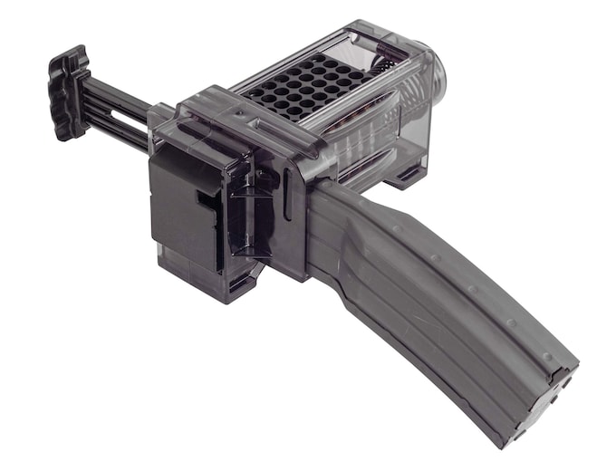

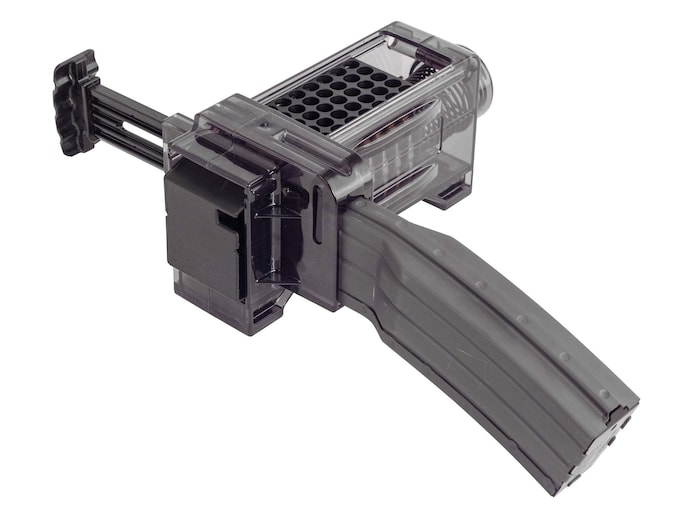

This is an ETS Universal loader for AR15 mags:
It will load 223/556 and 762x39. there are 2 sets of slots in the feed rail. The larger one fits 6.5 Grendel case but it holds the rounds too far forward and doesn't load them.
It doesn't attach to the mag. You load rounds in the rail, either manually or scoop them up in rows from an ammo box. It holds up to 10 rounds and loads them into the mag so easy it's unreal.
