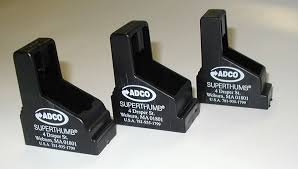

I've used the Adco super thumb for 20+ years. It works but if you're going to shoot a lot in a trip you want something better. After buying the Sig P365 and P365XL guns and mags, I REALLY wanted something better due to how stiff the springs are.

Adco super thumb:
These are inexpensive and lifetime guaranteed. They replaced last christmas one for me that I bought maybe in 1997 or so. They work, are much better than nothing but do take some work and aren't super speedy. Very small so it's easy to have 1 or more in a range bag. I use one on 9mm and 45ACP double stack mags.

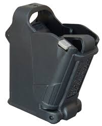

UPLULA loader:
Universal, might work on a 25ACP, dunno. Will work with 380 and up, I use it with Glock 9mm and 45ACP double stack mags as well as Sig P365 9mm mags. Works great. Take a bit of using to get the hang of, a hand-eye coordination thing. Fairly quick but not a speed king.

Uplula for me. Love it.
Another YES for Uplula. I bought one after breaking two cheap ones on my Sig P365. It also works great on 9mm 1911 mags which besides being difficult to load to capacity always seem to have sharp edges.
For pistol magazines Uplula cannot be beat IMHO. So far I have not purchased a loader for AR magazines but I plan on taking a close look at the ETS magazine loader.

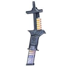

Uplula for me too, for regular pistol type mags & Maglula lula SMG below for my CZ Scorpion 9mm Mags
Maglula LULA SMG Magazine Speed Loader, CZ Scorpion EVO-3, 9mm, Black, LU17B
I usually go to carbine classes with no fewer than 20 fully-loaded AR mags.
I find that my favorite use for the MagLula tool is to speedily strip rounds from mags, to either get them down-loaded to what the instructional cadre may want for specific drills, or if I just fine that I want to practice reloads more. :)
I just ordered it today. After trying to fill several Scorpion mags (2-20's, 2-30's, 4-32's), I yelled "No Mas". I was lucky to get 22 rounds or a bit less into each of the 32 round mags before my thumb started to bleed (spring tension was just too much). I did load up several other pistol mags (P365, Hellcat, Walther CCP, CZ Rami, Glock G43), with my MagLula though. All told about 500 rounds loaded before heading to the range. 🥴
