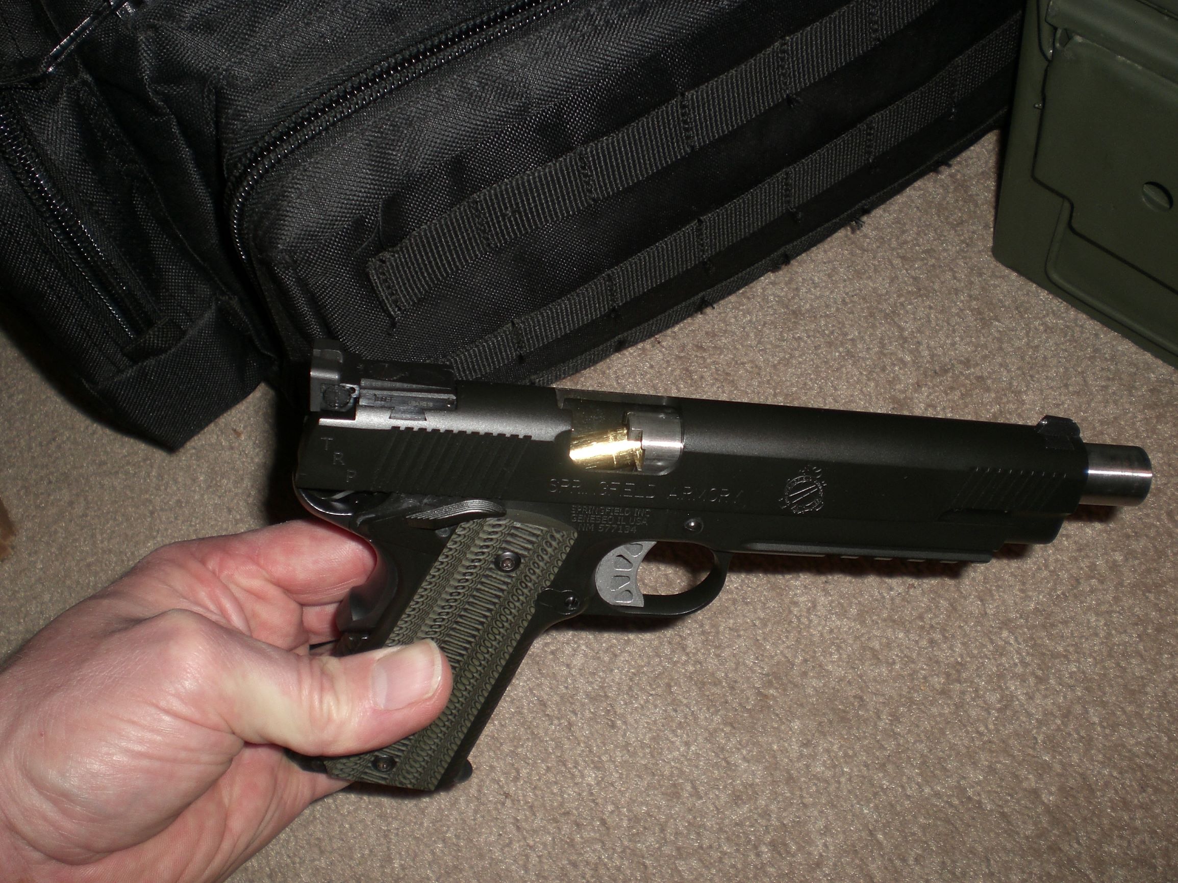

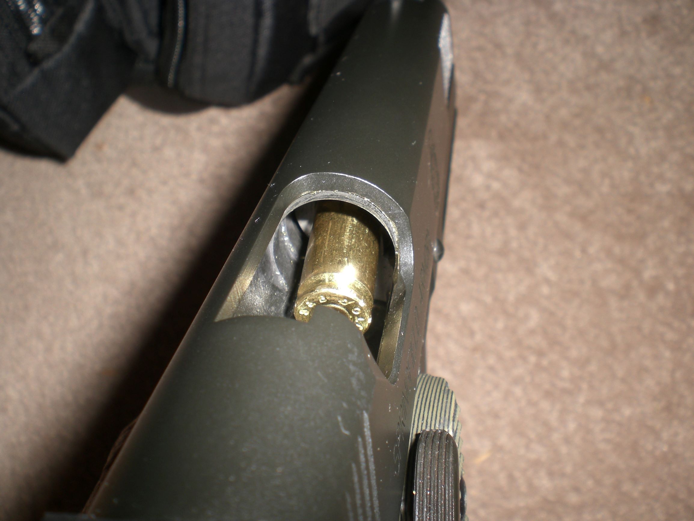

I missed the first part of your question. The jamb would mostly occur from releasing the slide lock or pulling the slide back and letting it go, sometimes while shooting. It did this with all 6 factory mags. It could be the 1st rnd. or the 8th rnd. or somewhere in the middle. The round would completely clear the mag and get jammed between the transition of the throat and the inside roof of the chamber. Both guns did the same thing. The second gun has only done it a few times since getting it back for the second trip back from warranty work.
The transition area from the feed ramp into the chamber was sharp it would gouge and dent the case. You would have to remove the mag and push up on the half chambered round pretty hard to get it out. Most rounds were unusable after the jamb. Like I mentioned earlier, Federal,Armscor and Sellier&Bellot all had these issues. As of getting the second gun back the second time after them doing the work, it's much better, but once in a while, it will do it while releasing the slide.

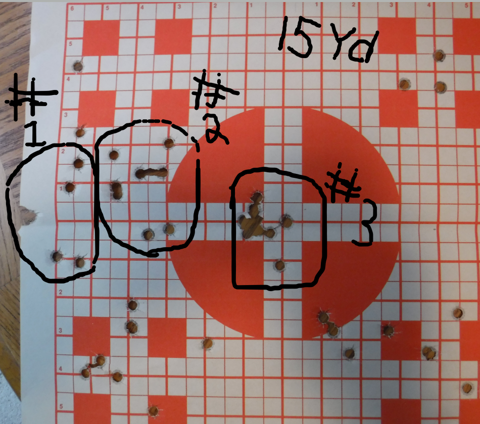

I just purchased the Operator 6" 10mm. It's sad it doesn't have a full length guide rod, I thought that was standard with the TRP series. The worst part, is that the gun was jamming all the time ( failure to completely feed a round into the chamber) and was shooting really far to the left at only 15 yds.. I sent this gun back to them and they didn't even try to fix it, they just sent me a new gun. ... They didn't know that isn't allowed to do in New Jersey with out a permit. ... The 2nd gun did the same thing! So back it went. Springfield somewhat corrected this problem (but not totally) by radius, blending and polishing the throat and feed ramp into the chamber. The 2nd gun still shoots to the left, but not as much. As you can see by the photos, the rear sight shouldn't be hanging off the right side of the slide that much on a $1800 gun in my opinion. ( My Springfield custom carry 45acp. has fixed sights centered on the slide and shoots straight). The 10mm holds tight groups, there just off to the left. Has anybody else had a similar experience?
#1 first gun out of the box.
#2 sights moved to the right.
#3 moved further right
When it would jamb.
The exact same thing happened to my TRP OPERATOR 10mm. I was at a local indoor range (San Antonio TX) and I was charged $108 to remove the live round. It was the first magazine thru my weapon and it jammed. After the gunsmith cleared it, it happened again. I was furious and I even forgot to pick up my ID. I’m calling Springfield this coming Monday. This is NOT supposed to happen in a gun of this quality and price ($1800). I hope this gets worked out!

UPDATE: After getting two additional magazines (both OEM) I did more testing by hand cycling. I tested Magtech, Federal, Blazer and Federal HST. In all 3 magazines the only ammo with feed problems was the Magtech. I inspected the rounds and I believe I’ve identified the problem. The cone of the bullet on the Magtech is a much sharper angle from rim to nose. All of the other bullets have a more rounded cone that is wider for longer before tapering to the snub nose. I think the narrower bullet in the Magtech is allowing the cartridge to feed further into the chamber before hitting the top and being pushed down. This is preventing the slide from being able to complete into battery. Just my two cents. Hope this helps someone.
I had the same problems with Magtech ammo in my TRP. Sent mine in to get the ramp cleaned up and polished. It made a slight difference in feeding, but the Magtech was still problematic. No issues before or since with Sig, Federal or S&B, but it feeds smoother since the rework at SA. I guess I’ll stick with those.

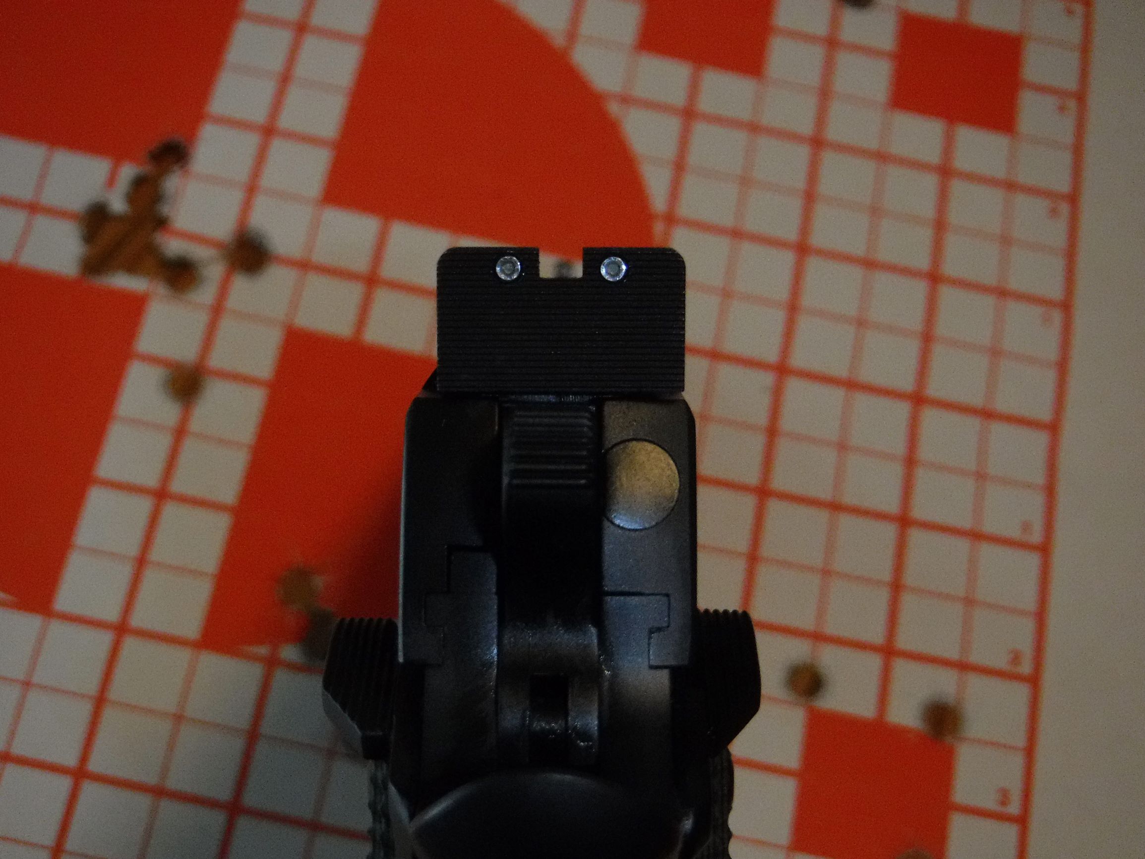

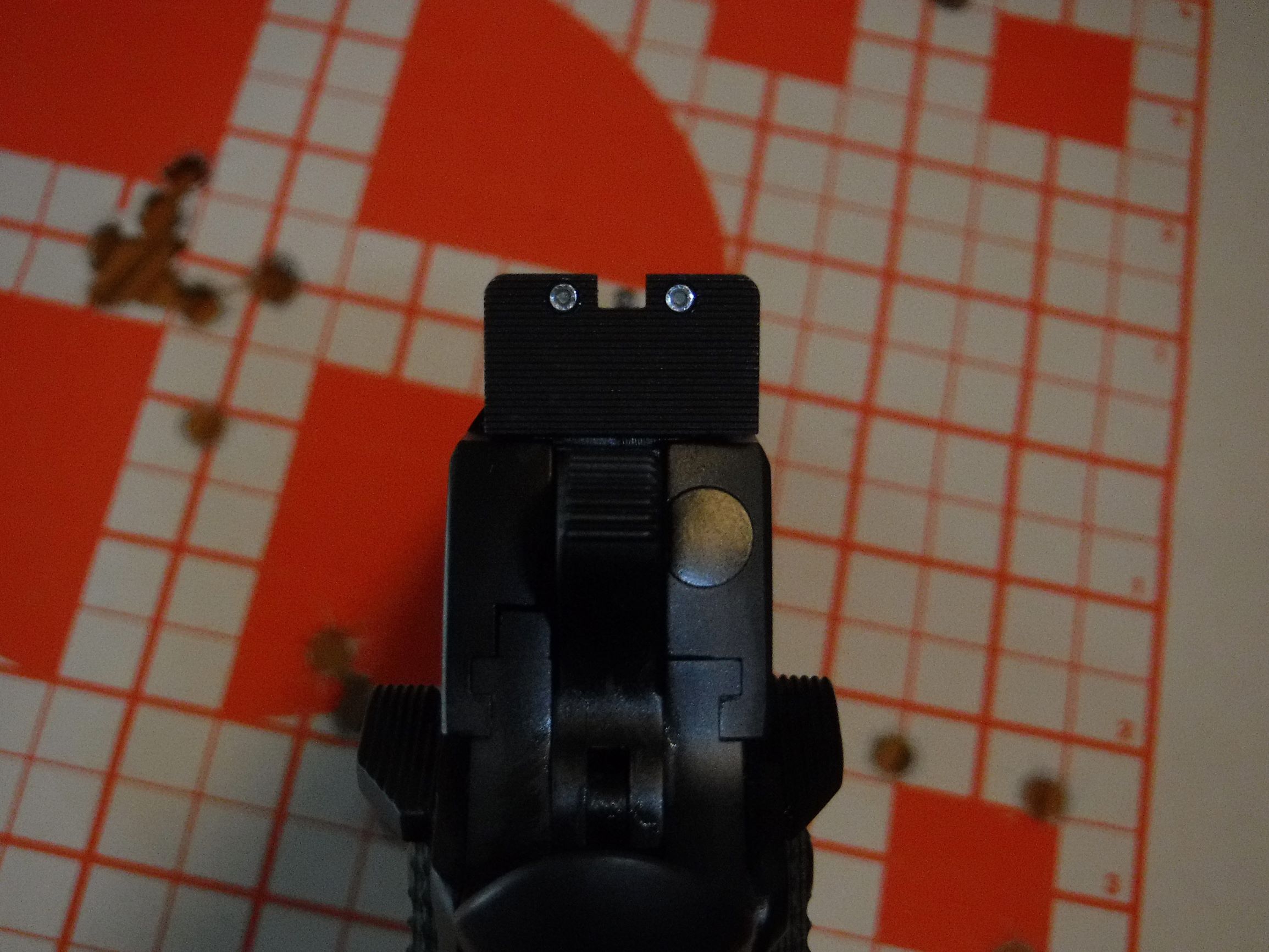

Maybe just me, but I wouldn't accept having to have the rear sight hanging off the side like that from a $500 gun much less an $1800 gun. You can buy a lot of really nice, high quality 1911s in the $1800 price range.
