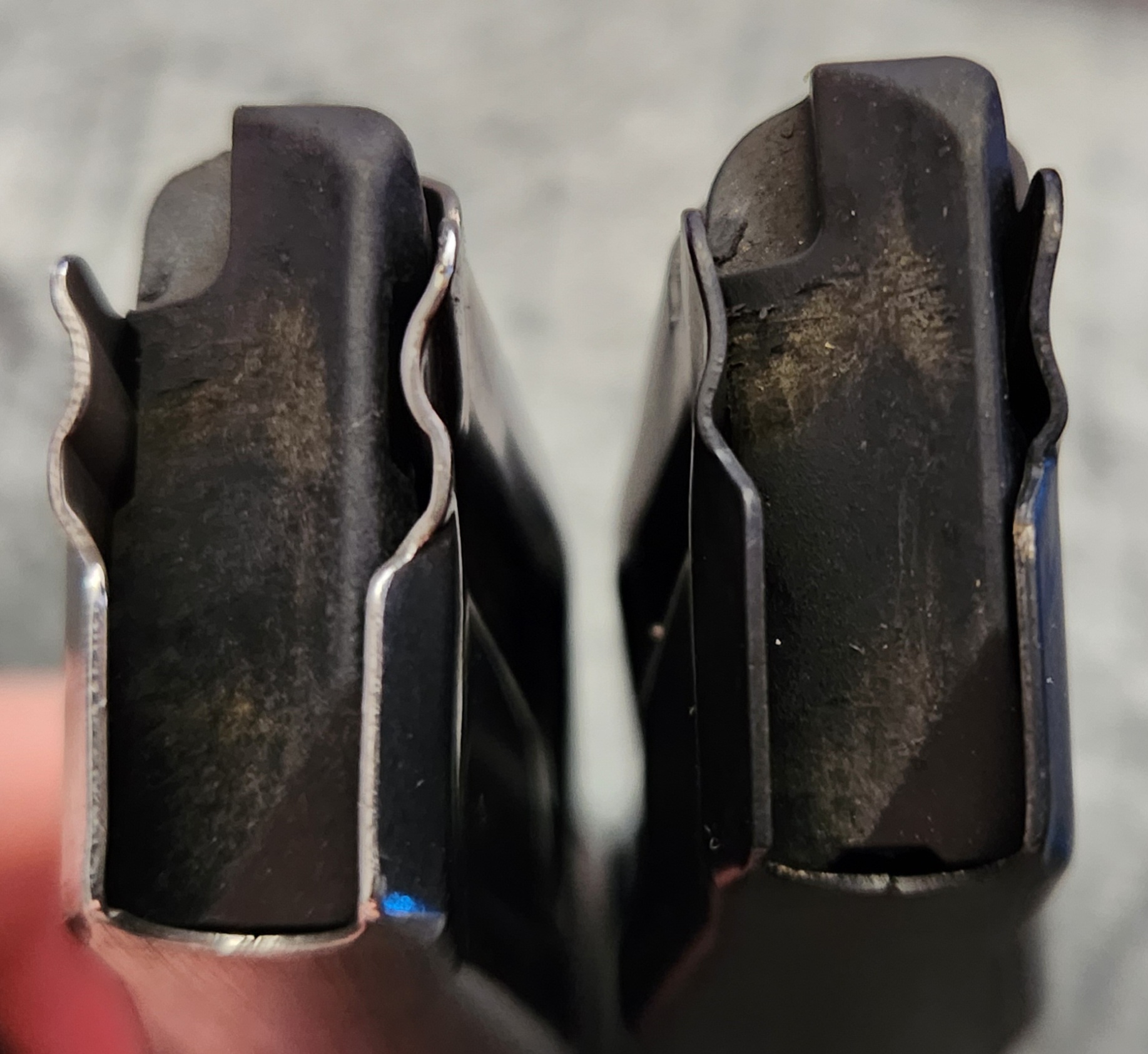

I also forgot to mention that the Staccato mag seems a bit more 'polished', especially the feed lips. (see below)
Feed lips are a bit more rounded than the SA mags and are a bit more 'flared'.
The one big difference is how much smoother the finish on the Staccato mag is, inside and out. The bare metal is very noticeably smoother than the black coated metal. Just take something and run it across the mags and you'll feel slight friction with the SA mag vs zero on the Staccato mag.
I think that friction is causing issues with feeding in the SA mags if the tip of the bullet touches the inside.
