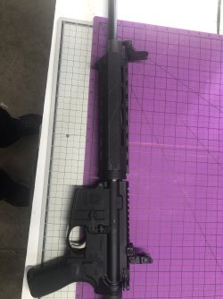

Your handguard is askew, which means your front sight is canted.
New sights won’t help anything; you’ll have to correct the handguard (looks like it needs to be rotated right-clockwise-in the photo).
I suspected as much, hence why I asked for an overhead picture. I recommend better sights because the OP isn't planning on putting an optic on it. Less than optimal BUIS is one thing, but primary sights is a different story.

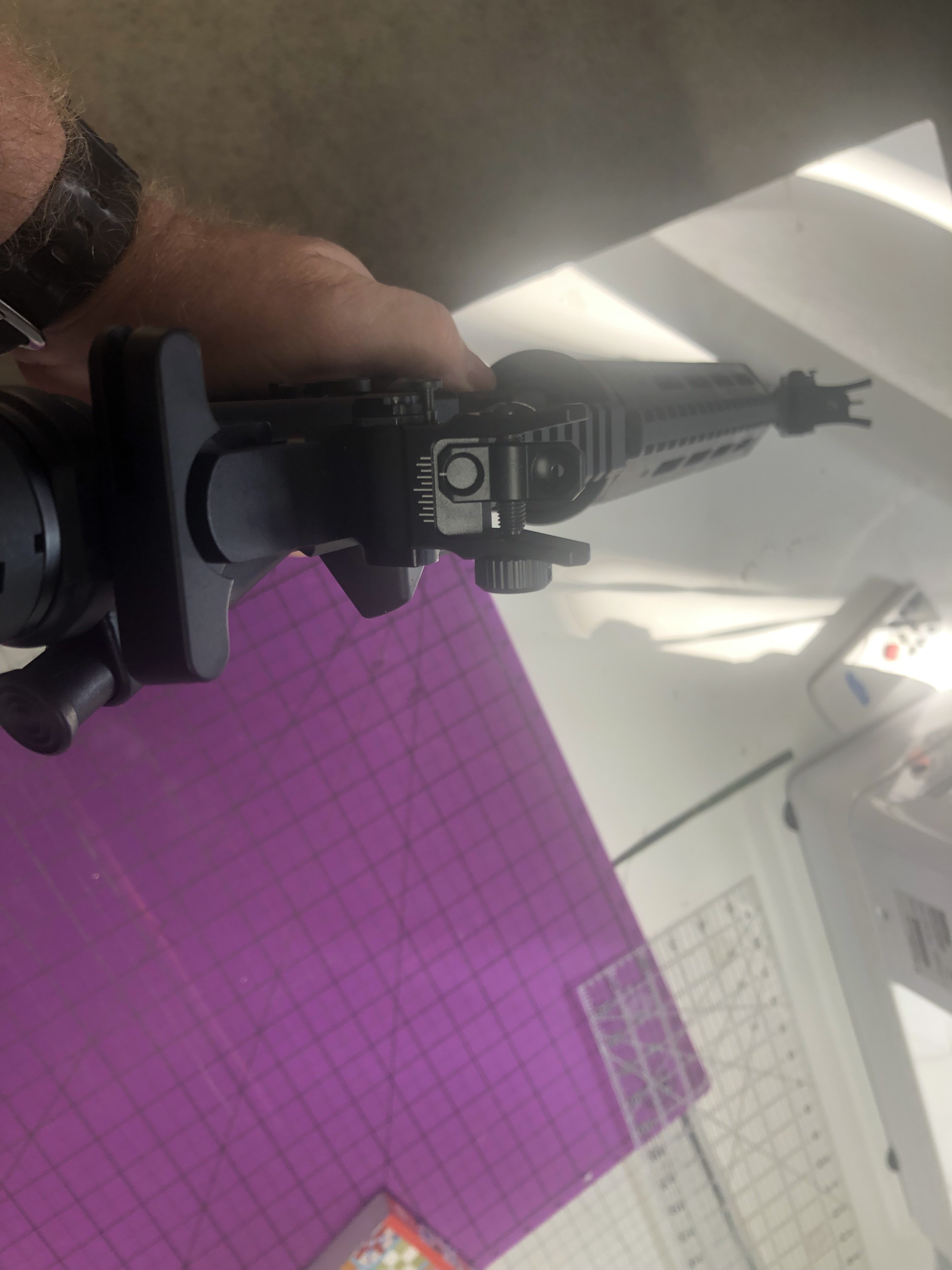

Having sighted in my saint I find that the rear sight is at the extreme left. There is no clicks left so that there is longer any movement allowed. This will hinder future windage adjustments. Can the entire rear sight be shifted to the right?

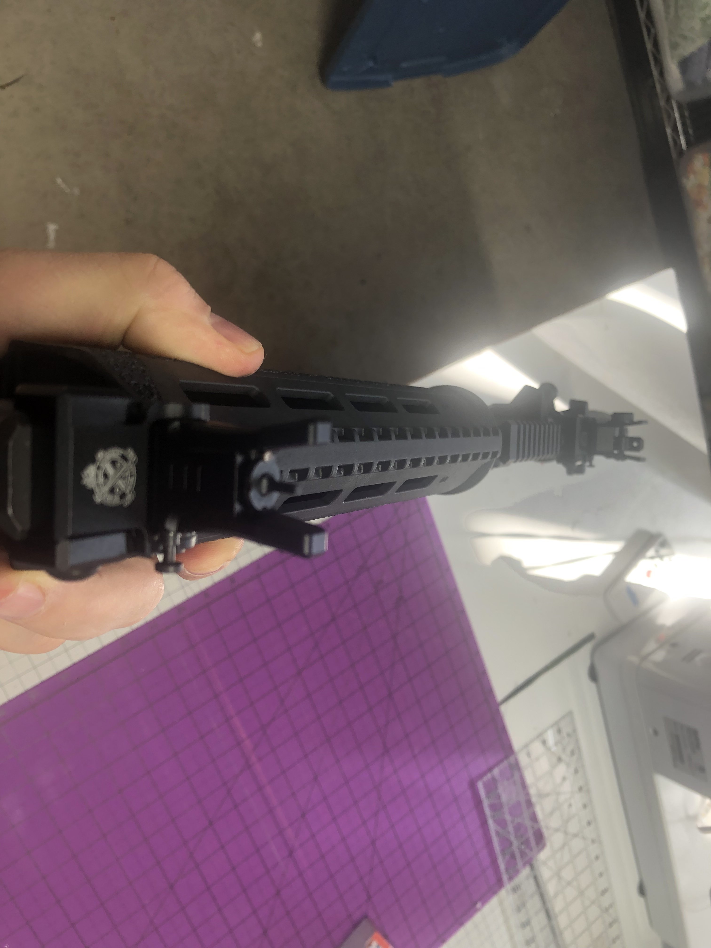

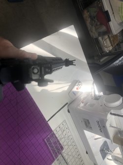

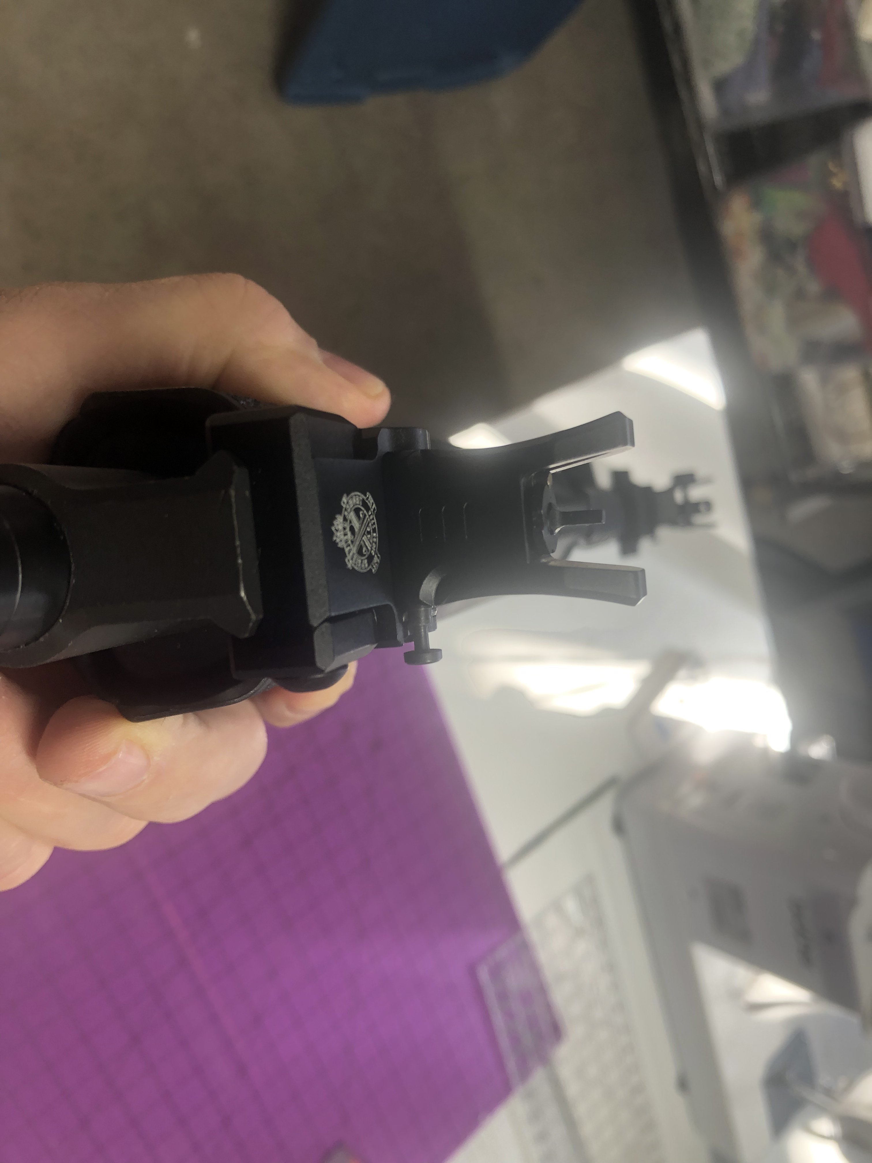

@mwilliams , I know you shared a picture of your current rear sight's maxed-left windage adjustment, but as with a few of the other members who've contributed replies so far, I'd like to get a look at what's forward of the sight as well.
Specifically, one of the current questions is whether your front sight post or gas-block/sight-base is askew, causing you to need to compensate with the rear windage.
It's my hope that you can get some pictures (one from muzzle towards receiver, trying to look down the length of the muzzle so as to verify gas-block/sight-base alignment, another from the top of the front receiver, where it joins the handguard as it looks forward towards the muzzle - the former should help identify front sight alignment issues if your Saint model is one which utilizes a front-sight-base or a gas-block base, while the latter should help identify a hand guard [on which your front sight will be mounted] alignment issue, in case your Saint is one which utilizes a free-floating handguard), but as you work towards that (or even in lieu of it, I'm wondering if you would please address a couple of other questions from me, too?

I do believe you meant shifting the entire sight to the left, I remember the sight is attached using Torx head screws, try loosening them to see if it can be moved however it’s been awhile that I worked on iron sights. That being said do you intend to put an optic on it?
All my long guns have scopes.
I took the rear sight off, and it is not possible to shift the sight

Handguard alignment should be irrelevant with this model, right?.
It's not the free-float rail, this model uses the standard delta-ring and front handguard cap to-capture. The front sight itself is not affected by the handguard or its positioning.
But the front sight base....
@mwilliams , what we're looking for is (not) this -
^ This picture, stolen from a post/thread on AR15.com, is a gun with a full front sight base - on which it is easier to see the clocking/cant.
What we need to insure is that your gas block, on which the front sight is mounted, is not clocked/canted similarly to one side or another. In other words, when you deploy the front sight, that front sight post should be perfectly at the 12-o'clock.
Although your current pictures improve upon the previous, it's still somewhat hard to see whether or not this critical area shows cant/clocking.
If you can, it may help visualize clocking/cant by removing your handguard.
