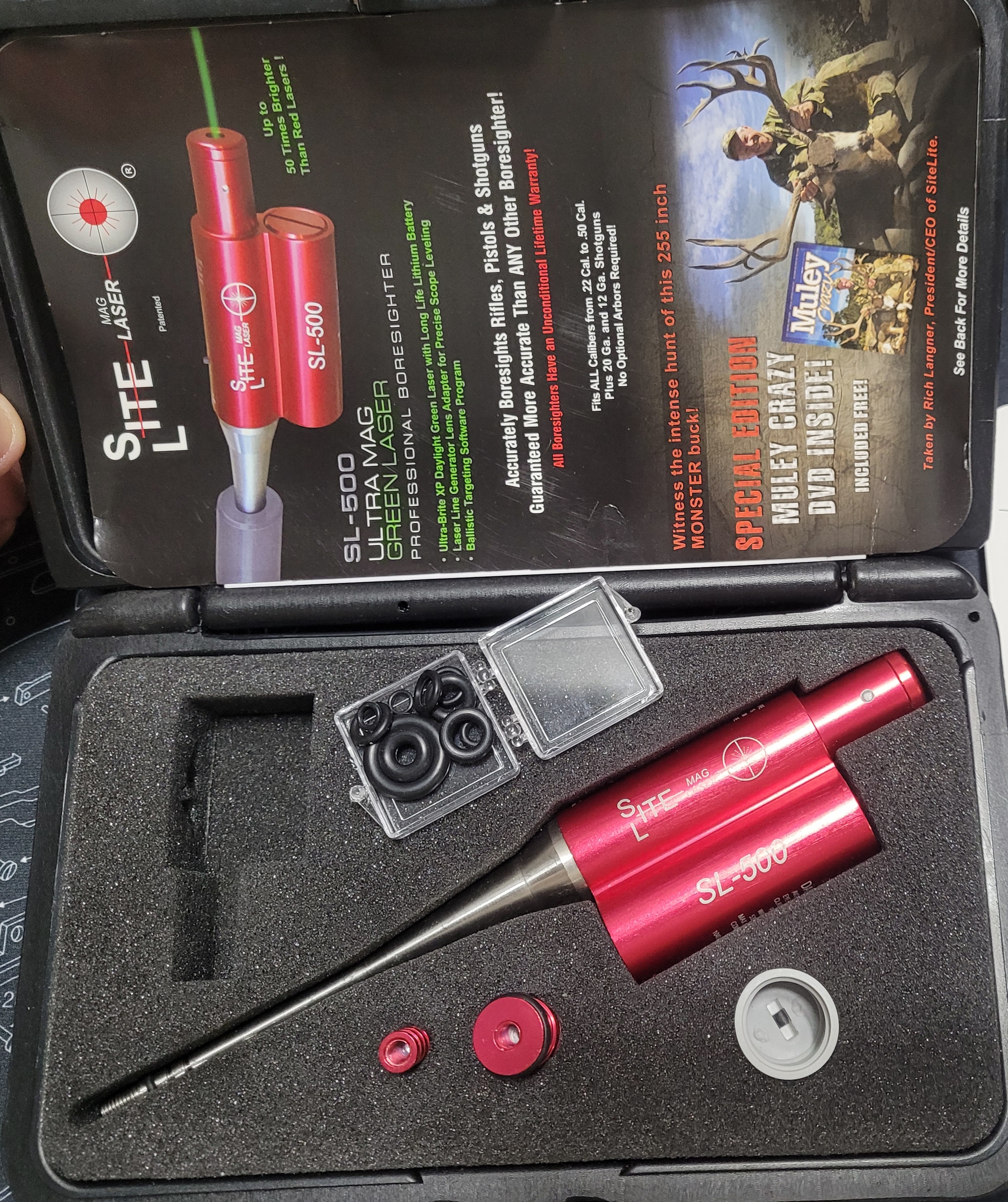

I thought about researching a multi-caliber boresight that inserts into the muzzle but just haven't gotten around to it. Has anyone else used this type of boresight?
This works from 22-50 cal + 20-12 ga. You can download software for zeroing best distance based on caliber and velocity + other inputs.

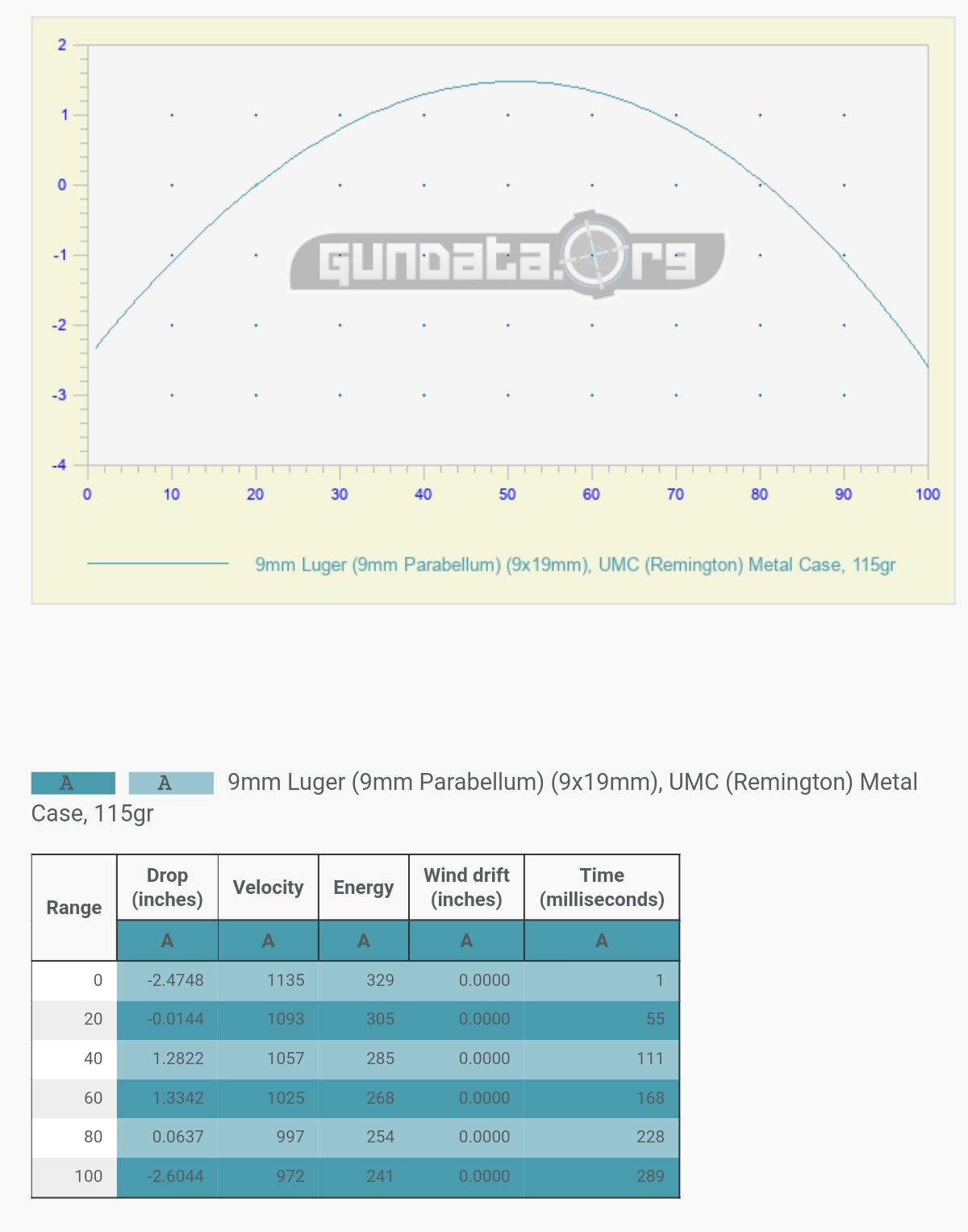

JJ, how fast can you run lol? Sight in distance looks good for your low sights. I did a little figuring for my PC Carbine sighting in distance too. With the StrikeFire II sight height at 2.5" I choose 20 yds sight in distance.
It starts at
-2.5" @ 0yds,
0" @ 20yds,
+1.5" @ 50yds, (peak)
0" @ 80yds ... and back to
-2.5" @ 100yds.
It all made me think about what a good sight in distance would be for the new Hellion. The sight height is probably gonna end up being 5 - 6 inches high on it. 🤯
It starts at
-2.5" @ 0yds,
0" @ 20yds,
-2.5" @ 100yds.
I don't have a calculator real close to look, but yours sounds reasonable. Most or some seem to forget about the 'sight height' when calculating ballistics, but they are as important as any other component. Give me your bullet weight, approx muzzle velocity, and I'll be happy to compare what you got with mine. And while I'm up getting my calculator, I might even find myself a nice warm Jack/neat to help keep me warm tonight. ;) :):):)

I just used online calculator
Well looks like you done good son. From your 20yd sight in range to something over 80 yds your projectile will never be more or less than a little less than 1.3" above or below your LOS. :) :):)

RE: the laser boresighter -
^ As @Bear007 noted, a more rigorous practice of bore-sighting can bring out better results, and the military practices that I cited in that post is a mirror of the rather simplified -but very practical- method that he uses, which actually is what I do, too. :)
The problem with the bore-adapter ones like the one that @TEXASforLIFE pictured above - which is also similar to what I use - is that a lot depends on just how well the adapter fits to the device as well as how the device sits in the muzzle. The methodology that @Bear007 utilizes allows us to somewhat take these errors and aberrations into account, making for a more acceptable final "zero."
I will absolutely admit to the fact that I only laser-boresight in a rather lazy manner :giggle: 😅 , but I typically only use it to insure that I'm "on paper" before I go out to the range.
