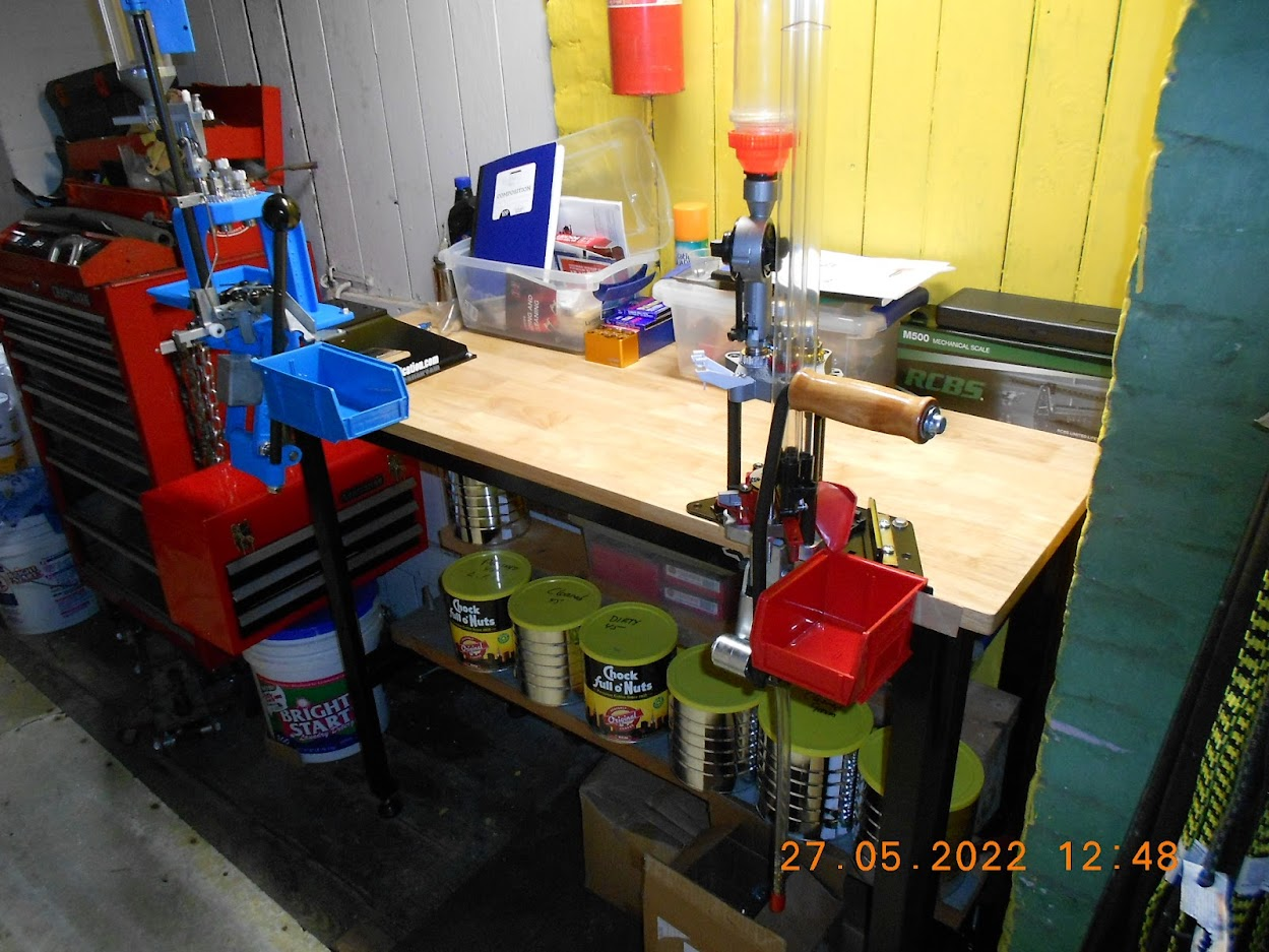

i updated my loading bench, from my home made short one, to a Husky (Home Depot) longer one, and there is a "back story", i'll post in another minute..
it is 4' long, by 20" deep, and 37" tall. channel steel, and adjustable legs.
cost not including taxes, is $125.00
i took me from 9 AM, when i got home with it, till 1PM to finish, and this includes cleaning up, vacuuming the floors, and cutting up the shipping box for the recycling bin.
super easy to put together, i couldn't ask for more ease
the most time taken, was removing the 2 presses from the other bench, drilling holes, and mounting the presses, and of course, putting things back as normal as possible.

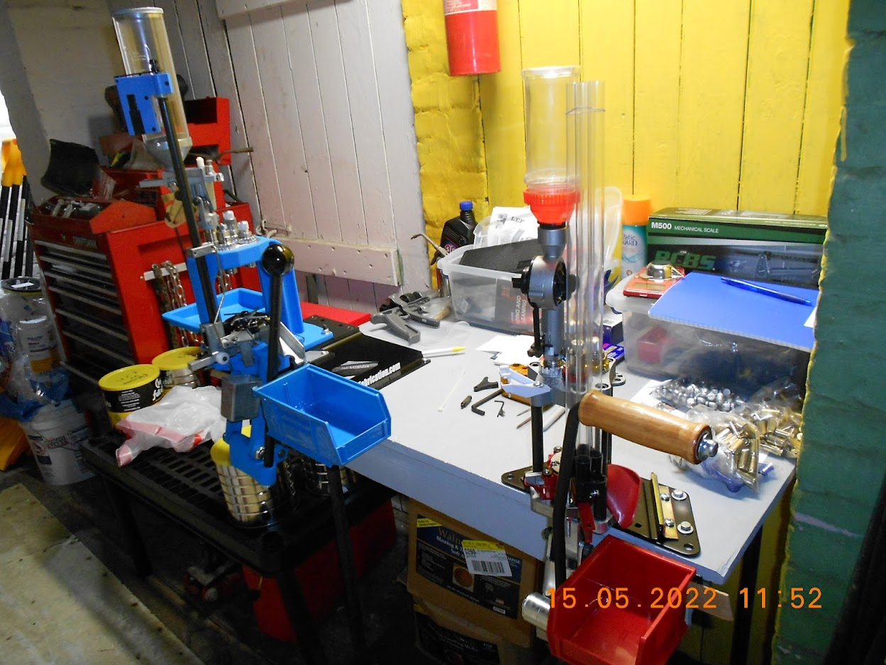

the "old" homemade bench

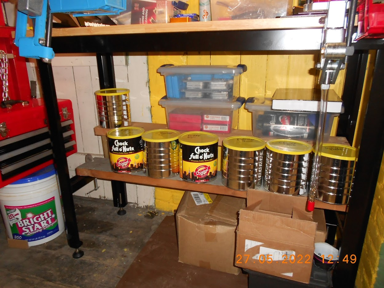

the new bench and "some" shelving i added

Nice bench. Mine is a 9 foot steel Craftsman that I got from the widow of a friend of mine. My other "bench" is the cabinets and countertop from our homes kitchen remodel.

yeah, i wish that i had more room where thigs are now. as it is, the vibrating cleaners are in another room. it's a rather large house, but all small rooms, either in the living areas, or the basement.
an "open concept design" works wonders for a kitchen-dining room and living room, it should work well in reloading rooms too...lol
