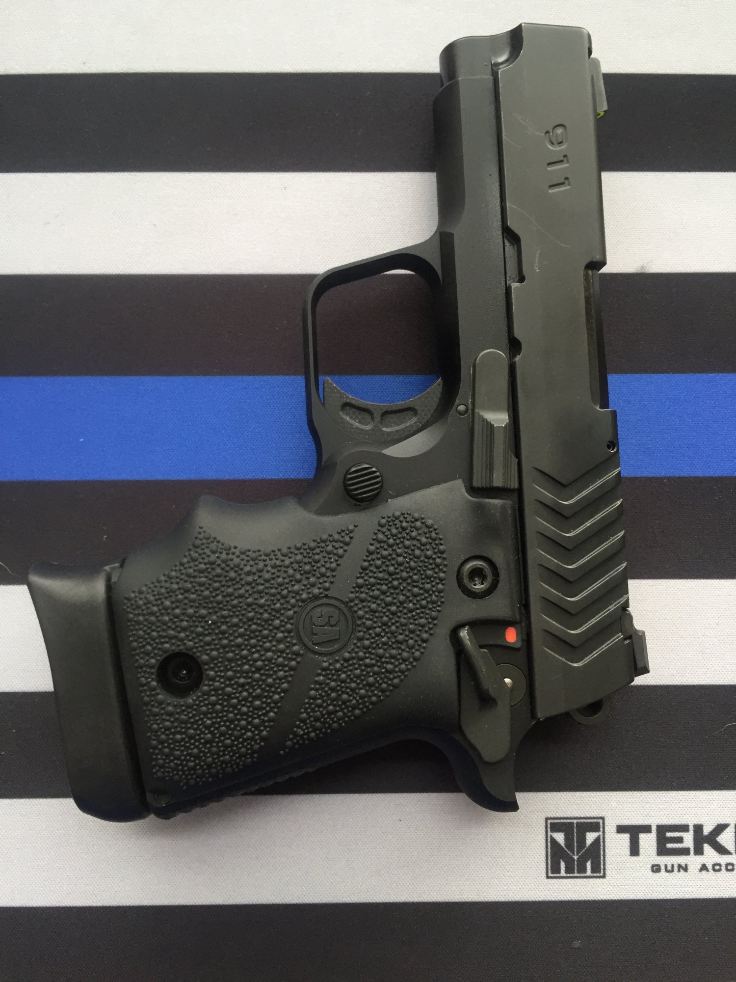

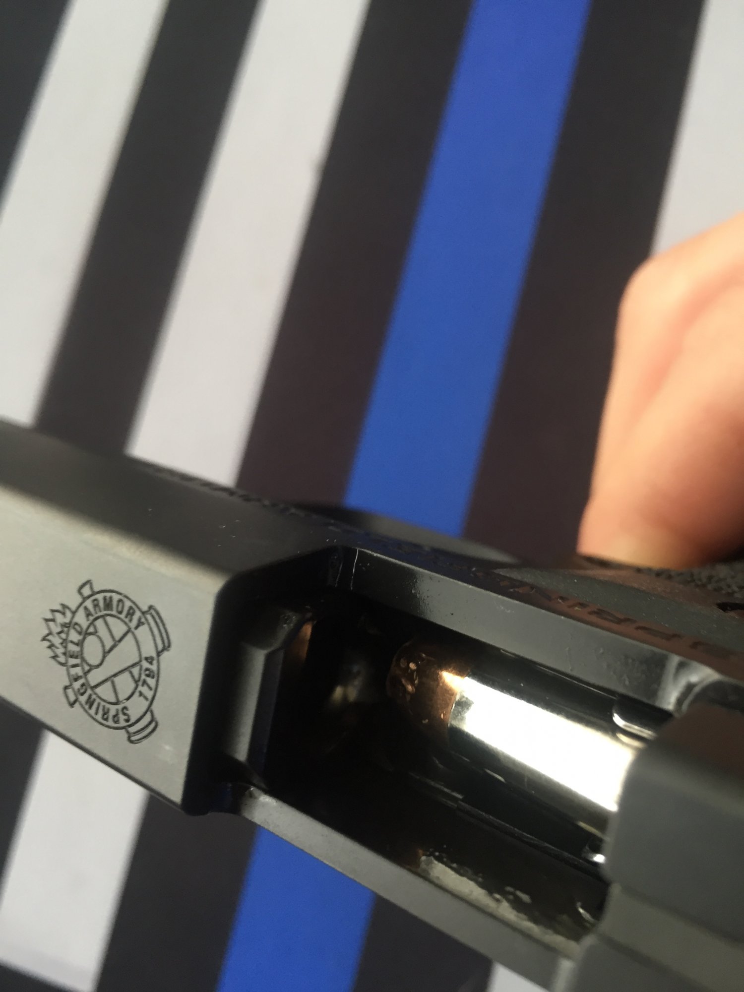

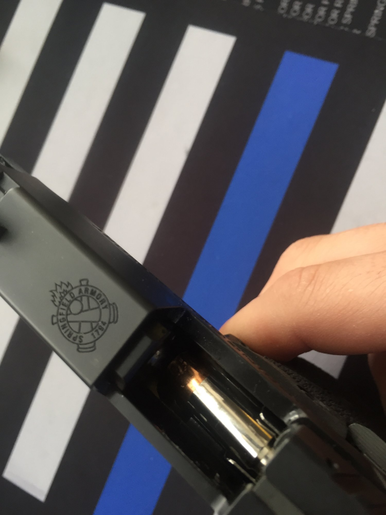

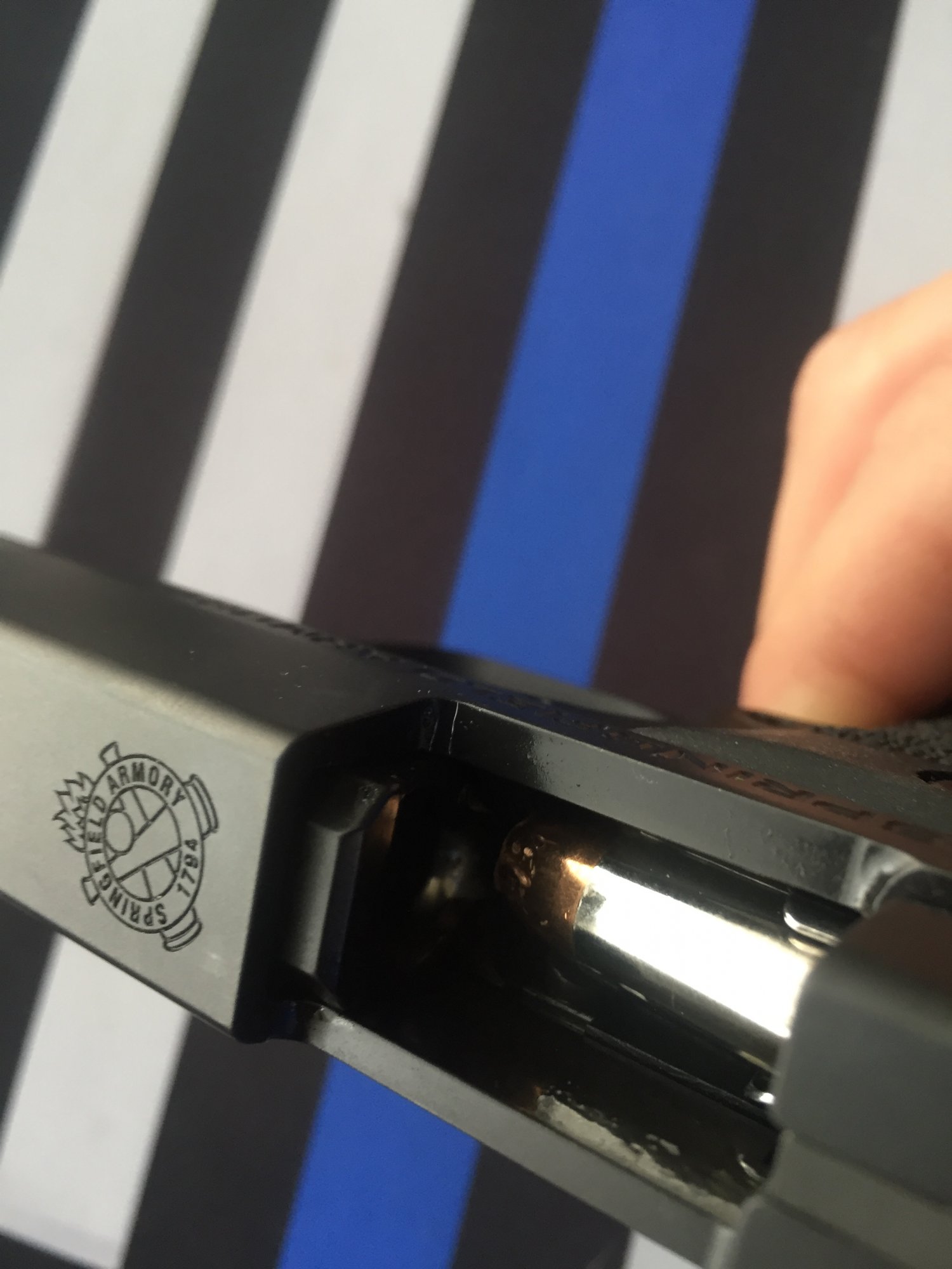

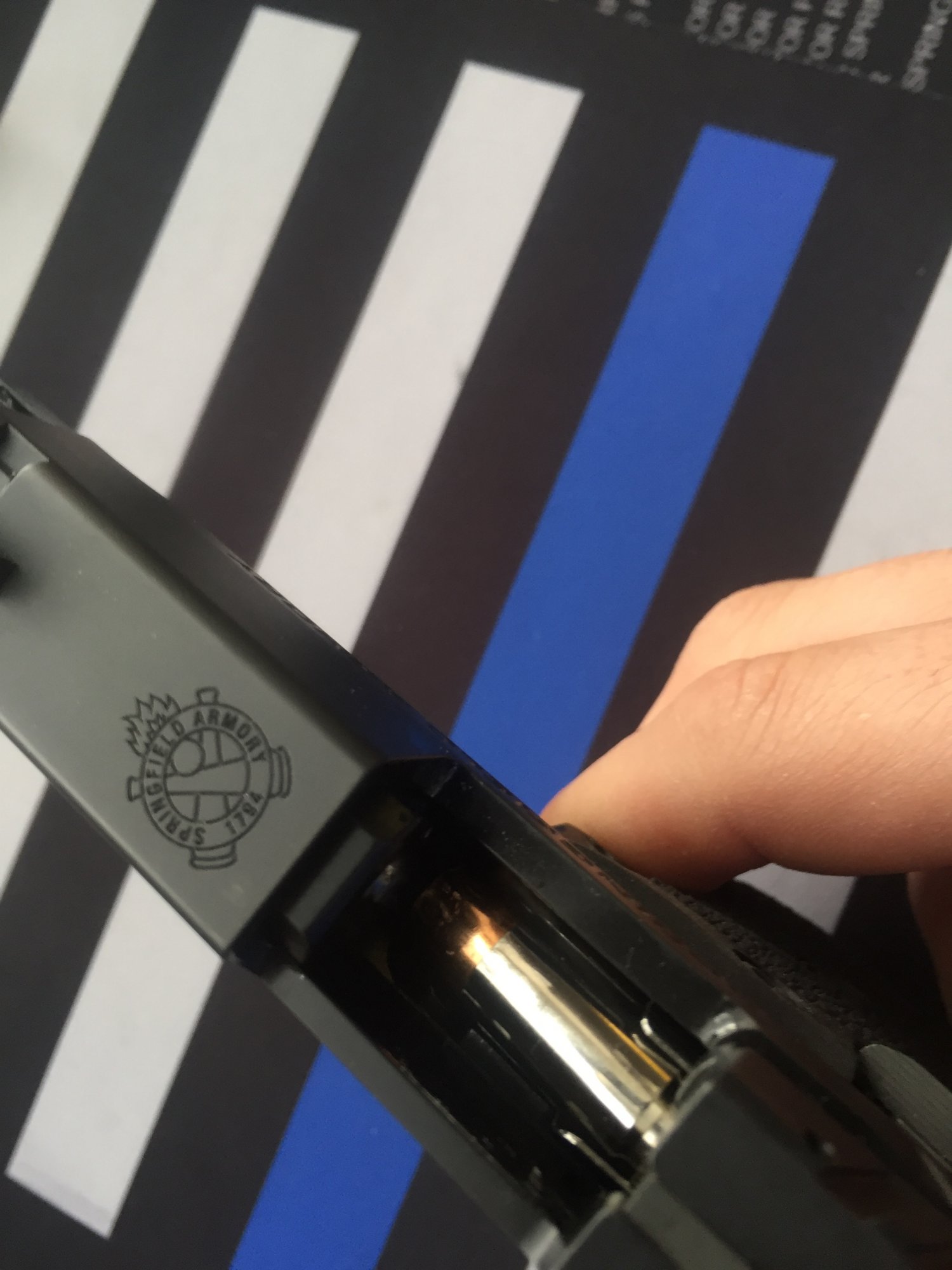

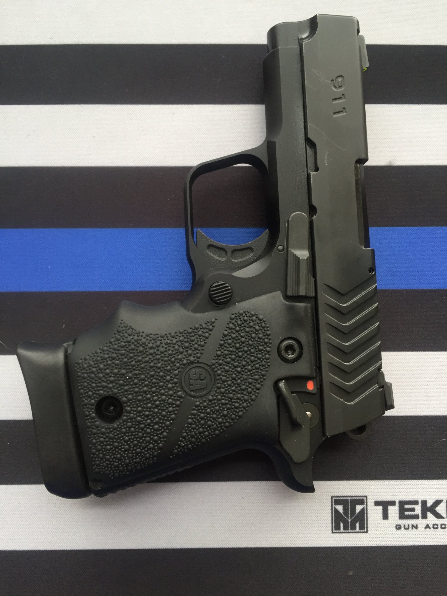

I just purchased one in 9mm and no matter what ammo I throw in there, it will not feed. Nose of bullet below barrel EVERY TIME. Pretty pissed
Try with the mag inserted and slide locked back puss up on the bottom of the mag and disengage the slide lock. I had a mag that sat low and would do the same thing(ramp up). Make sure no finger on the trigger!!!!! Trigger finger below the trigger guard! If push up doesn't work, the slight pull down on the mag and recheck. the angle mine would get stuck is like this (/).

It seems to me that the mag feed lips are a little too far apart. However, it may be that it has rocked forward. The next thing to look at is the feed ramp. I start with some jewelers rouge and polish that. If that doesn't do anything for you then maybe the angle is a little off. It all depends on you comfort level with futzing with it. Otherwise, send it back. I have had similar issues with 1911 barrels. They just need a little massaging.

The mag looks fully seated, but from the pictures it looks real low in the chamber. I would first try to polish the feed ramp if not your follower may be jacked up and I’d call SA and have them look at it.

Sounds like the barrel needs a little work. If it wasnt new I would give it some quality time with a dremel a soft polishing bit then some jewelers rouge. Just get an RMA and send it back.
