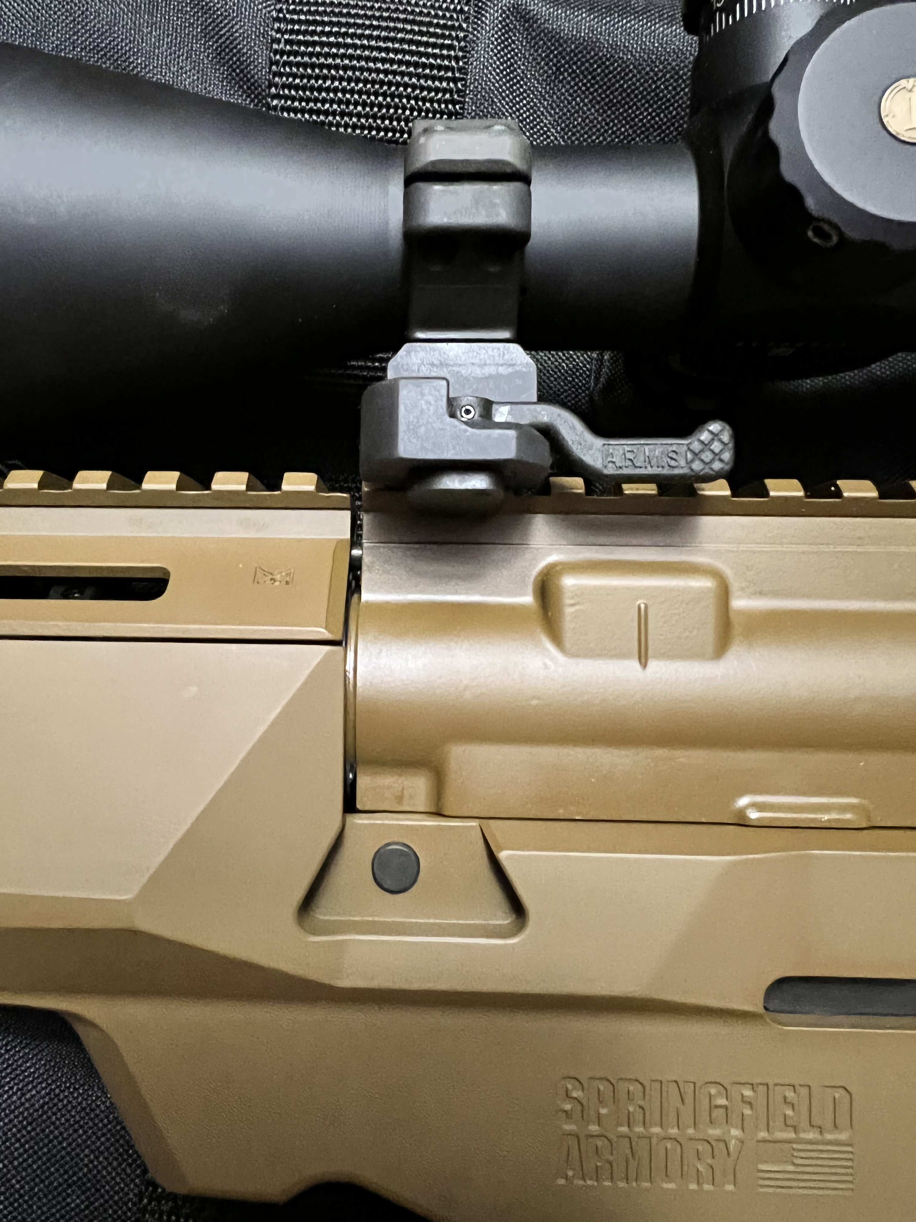

Got my hands on one today.
Have to say disappointed.
- heavy
-top rail above the monolithic lower on the barrel rattled to high heaven. Super loose
- big gap between upper rail handguard and upper receiver
I’ll stay with my other Saint Victor 5.56 & .308

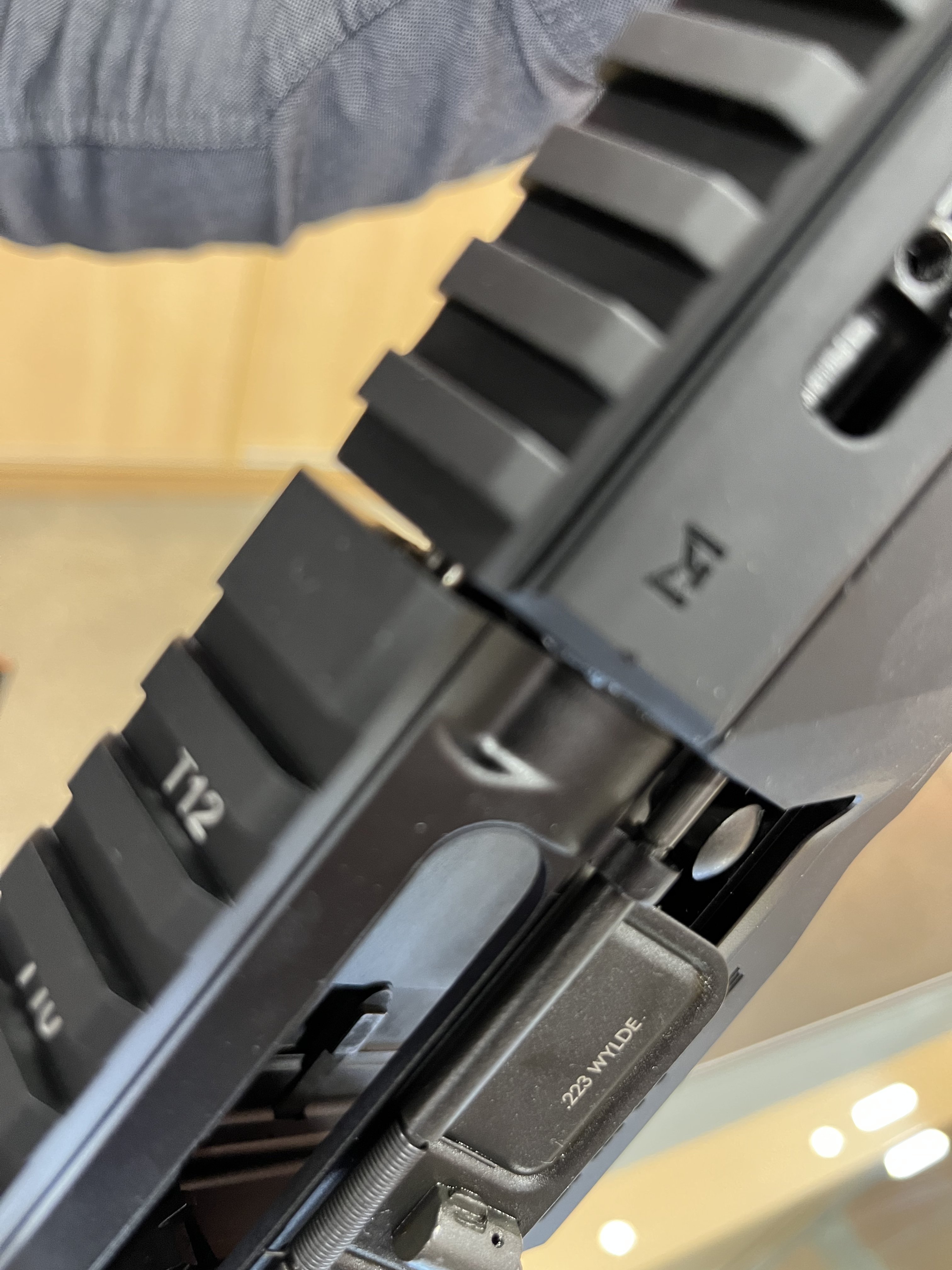

They all have a gap, and a there is a screw that needs to be adjusted That removes the rattle. You loosen it to remove the upper handguard.
if you look at both of mine they also have the gap where the upper handguard does not touch the upper.

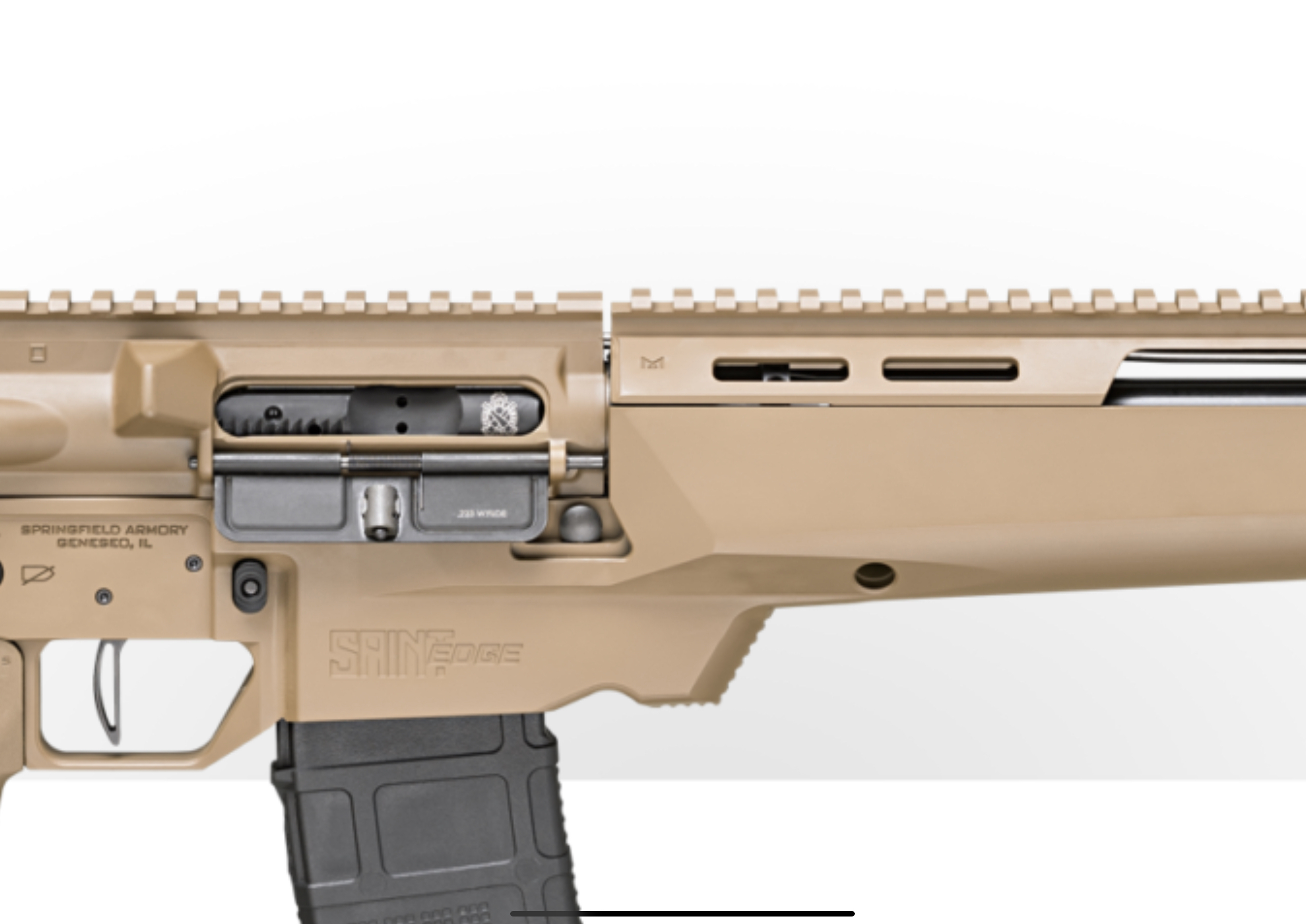

Even in the official SA Glamour shots the gap is shown.

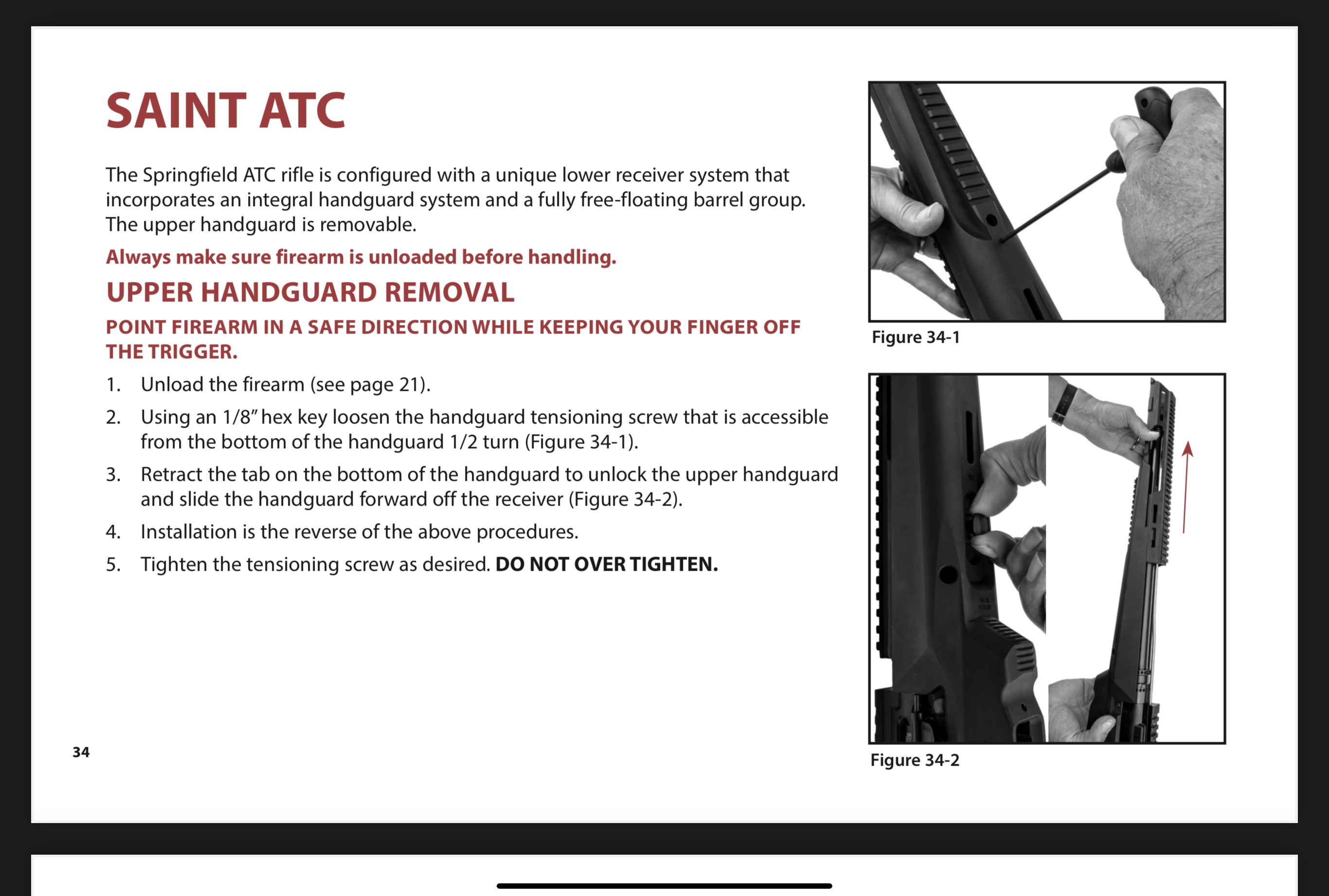

And from the manual they talk about the front set screw, the harder you tighten, makes it harder to remove the handguard.

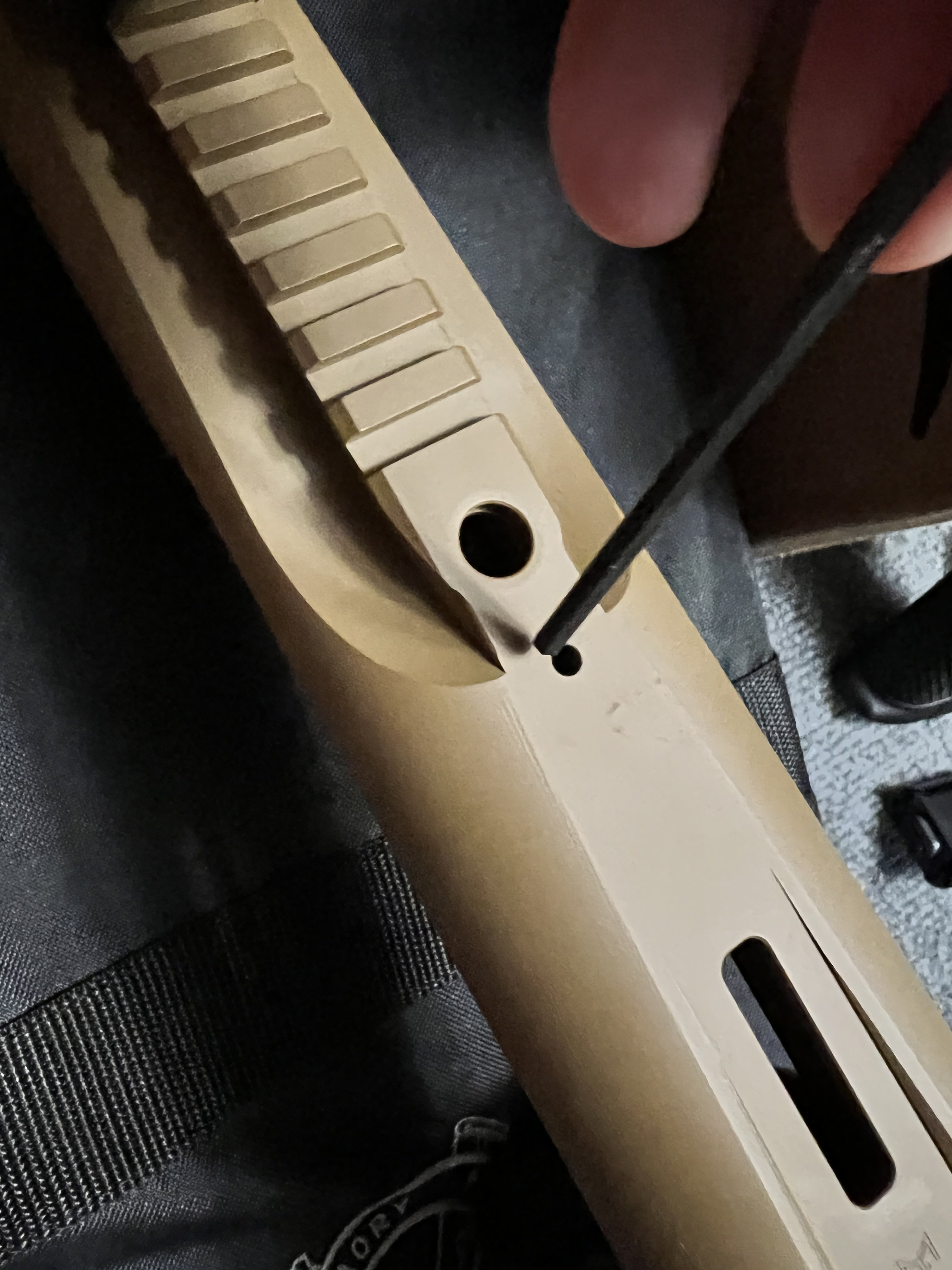

Heres a close up of one of mine, the handguard is free floating around the barrel and does not touch it or the upper at all.
So is there a way to keep it in full contact with the upper making the pic rail touch each other without modification? Or is it just live with the unsightly gap?

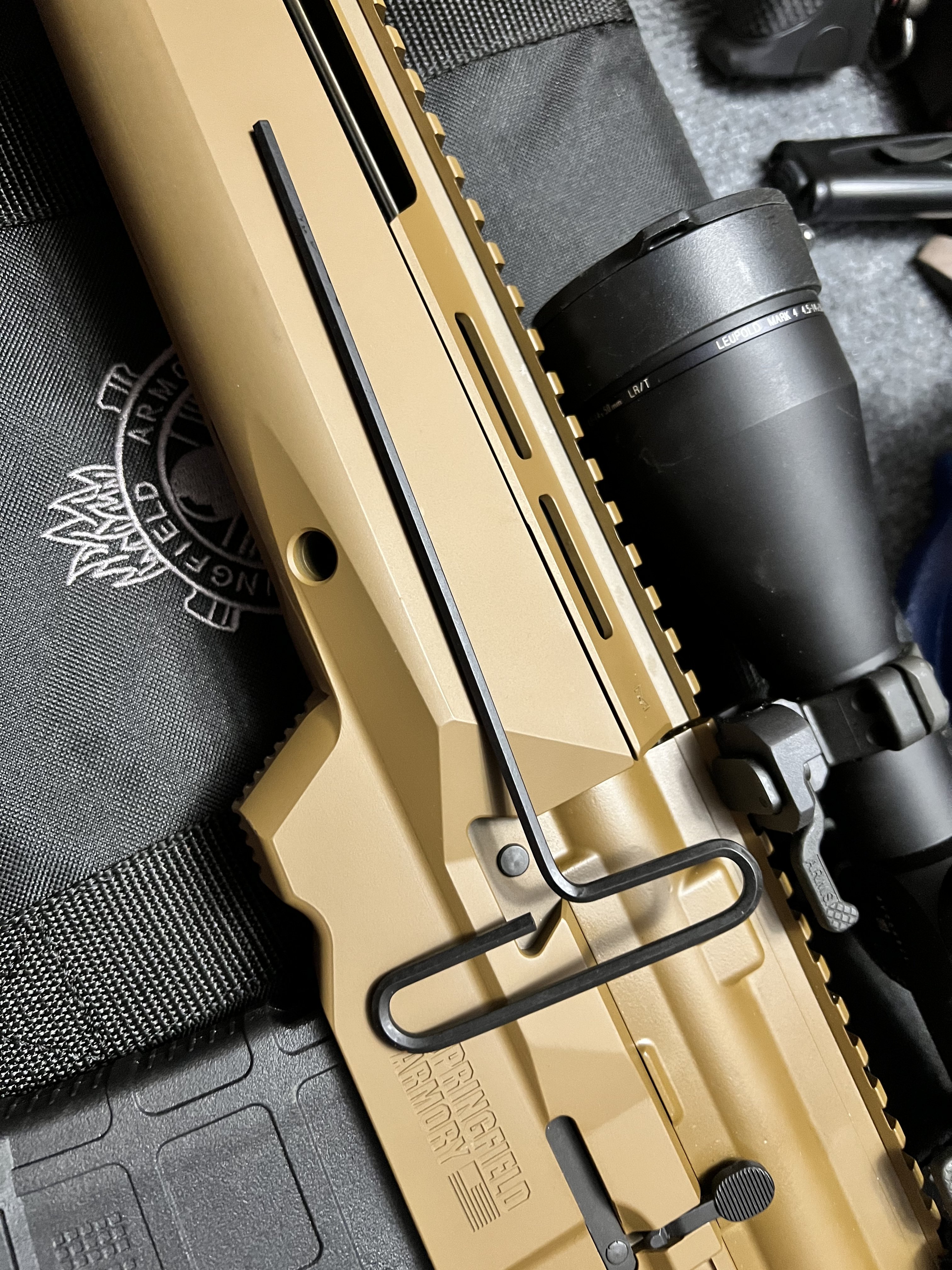

Now to talk about the rattle, the ATC utilizes three accutite screws, the forward one has a polymer bushing, the two rear ones are metal tipped and push into both of the upper lugs. The ATC also comes with a set tool thats extra long. Unlike other Saints you can adjust all Accutite screws without removing the pistol grip…meaning you can adjust it on the fly.

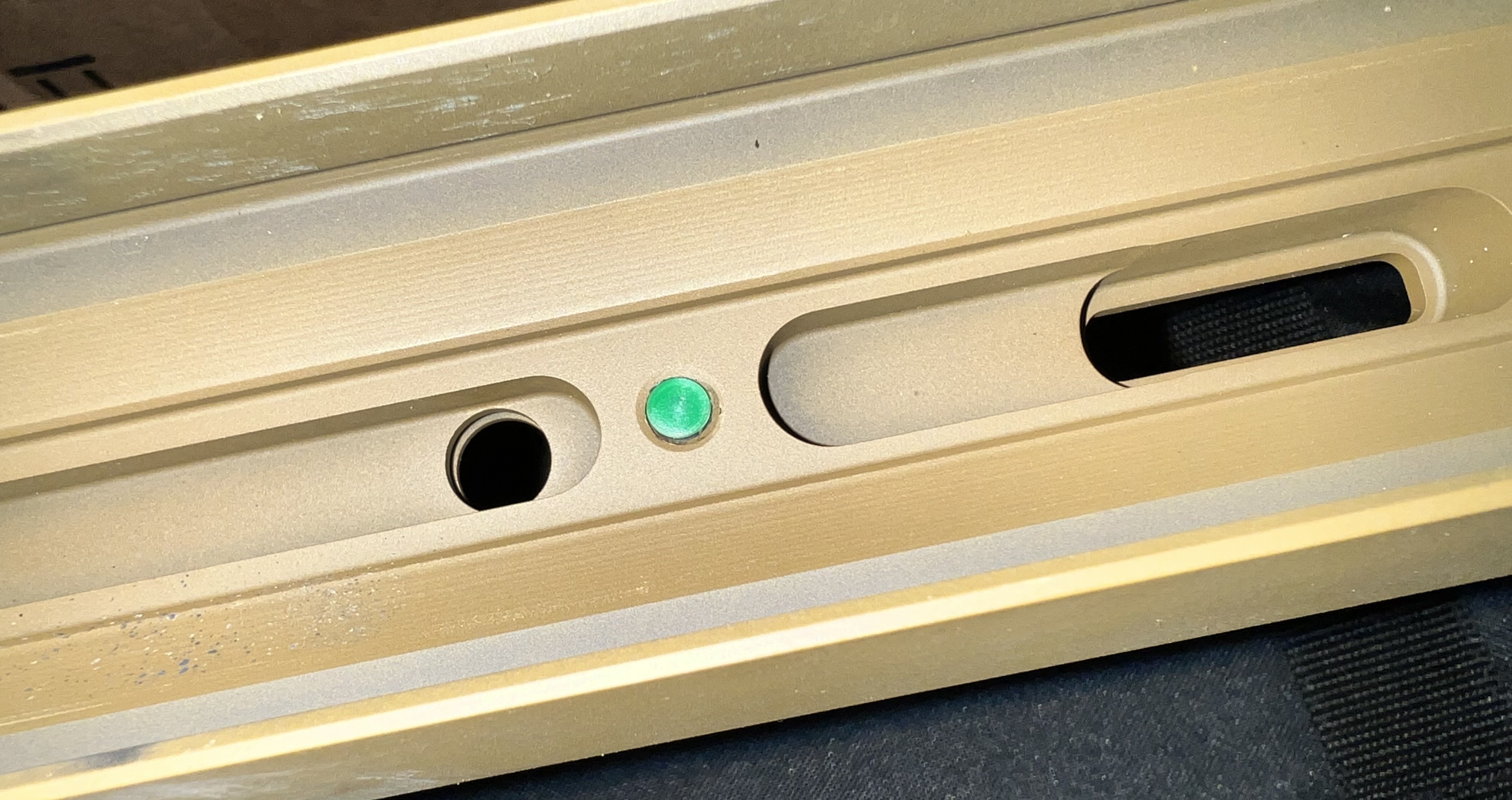

The hole for the front screw, this will make it easier to remove the upper handguard. But if it is loose to be able to easily remove the handguard it will rattle. If it is adjusted tight it is almost i possible to remove the handguard.

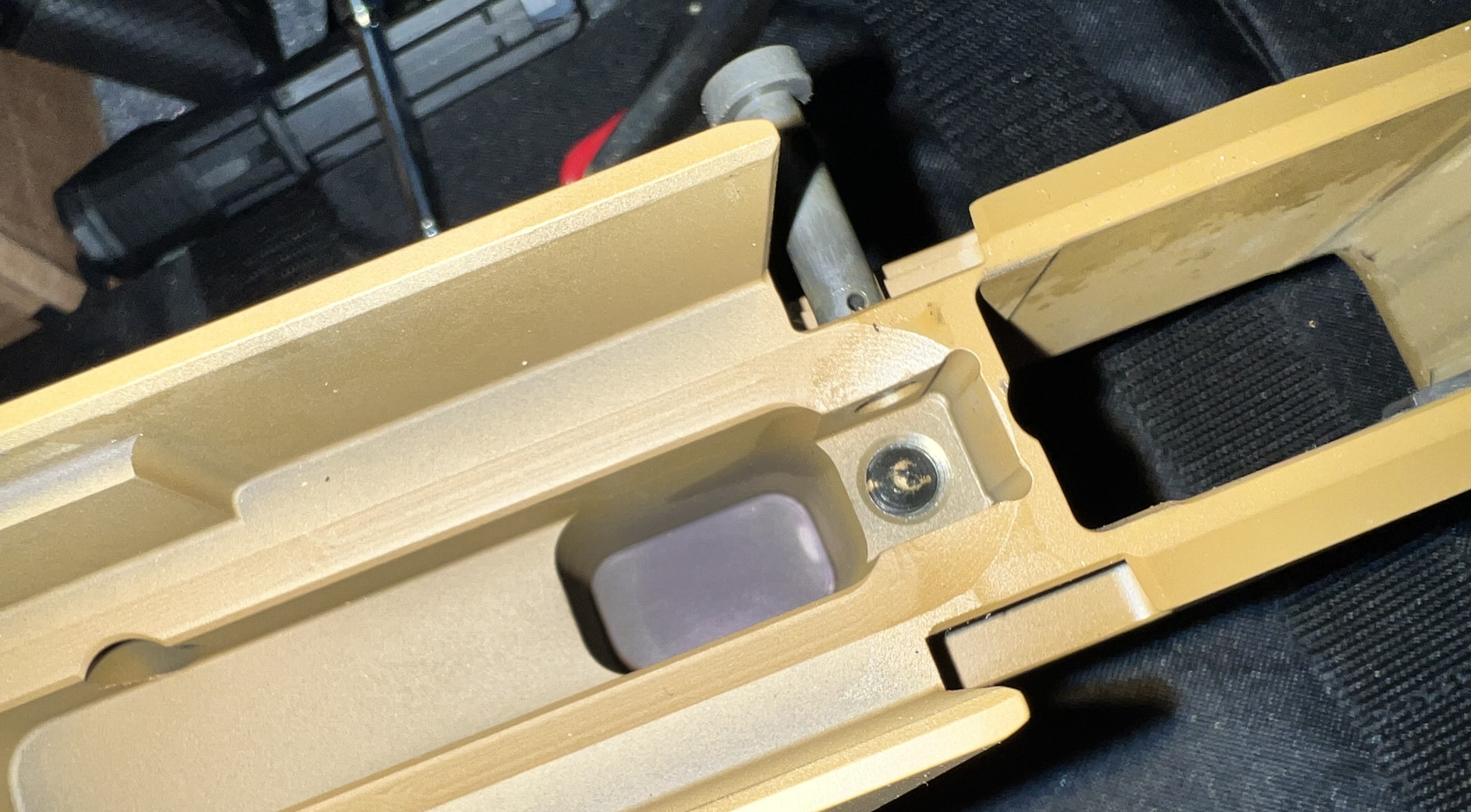

Here is a look inside the lower handguard showing the screw.
Moving back here is the lower by the front takedown pin and the accutite screw for the front lug.
Here is the oustide of the lower showing the hole for the front adjustment screw

An update over older SAINTS you can now adjust the rear screw without removing the pistol grip, thanks to the extra long provided tool. This means you can tighten the upper and lower fit tight tight tight, but loosen the screw on the fly for easy disassembly. Huh 🤔 it almost seems like someone thought about all this stuff.

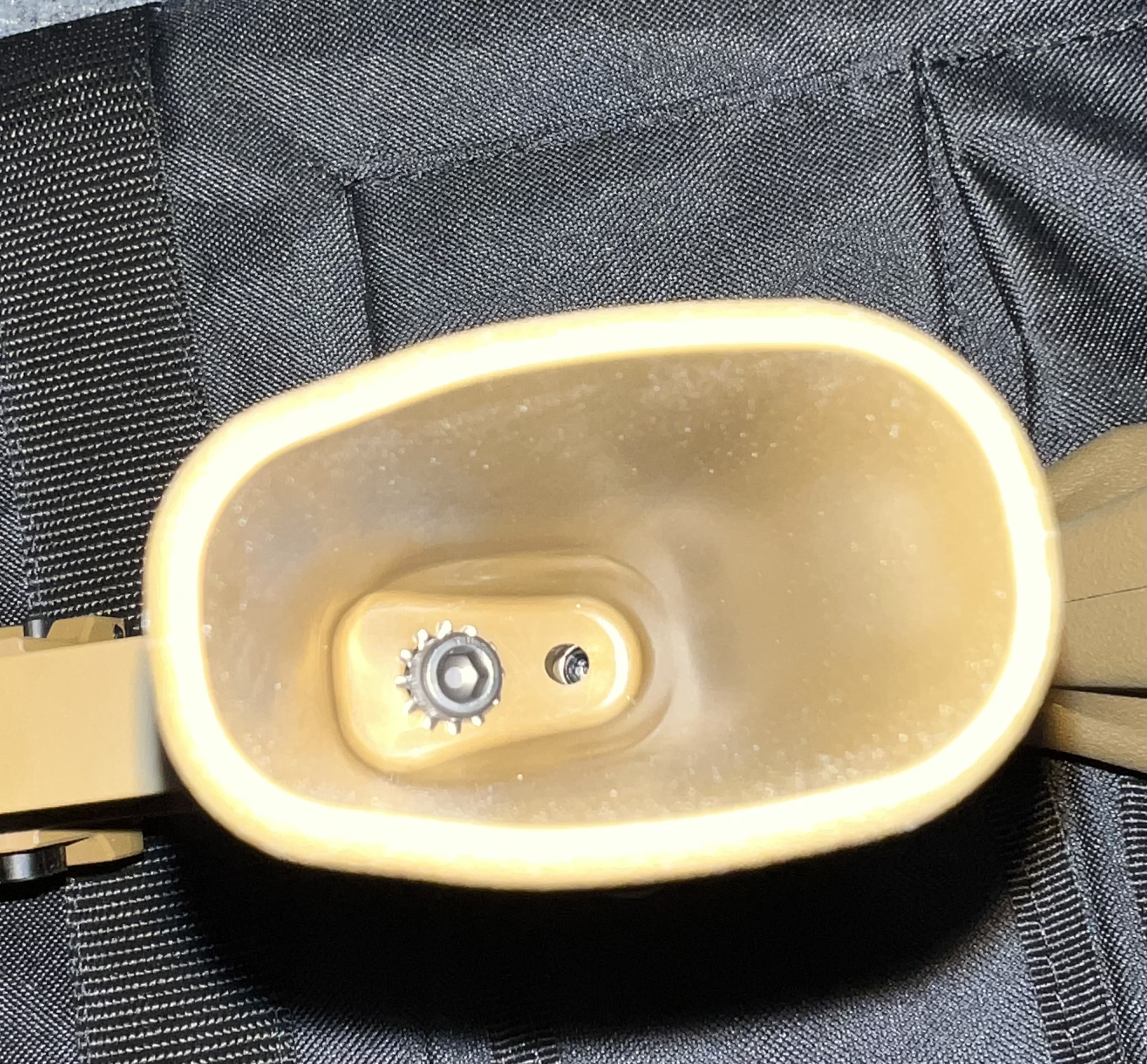

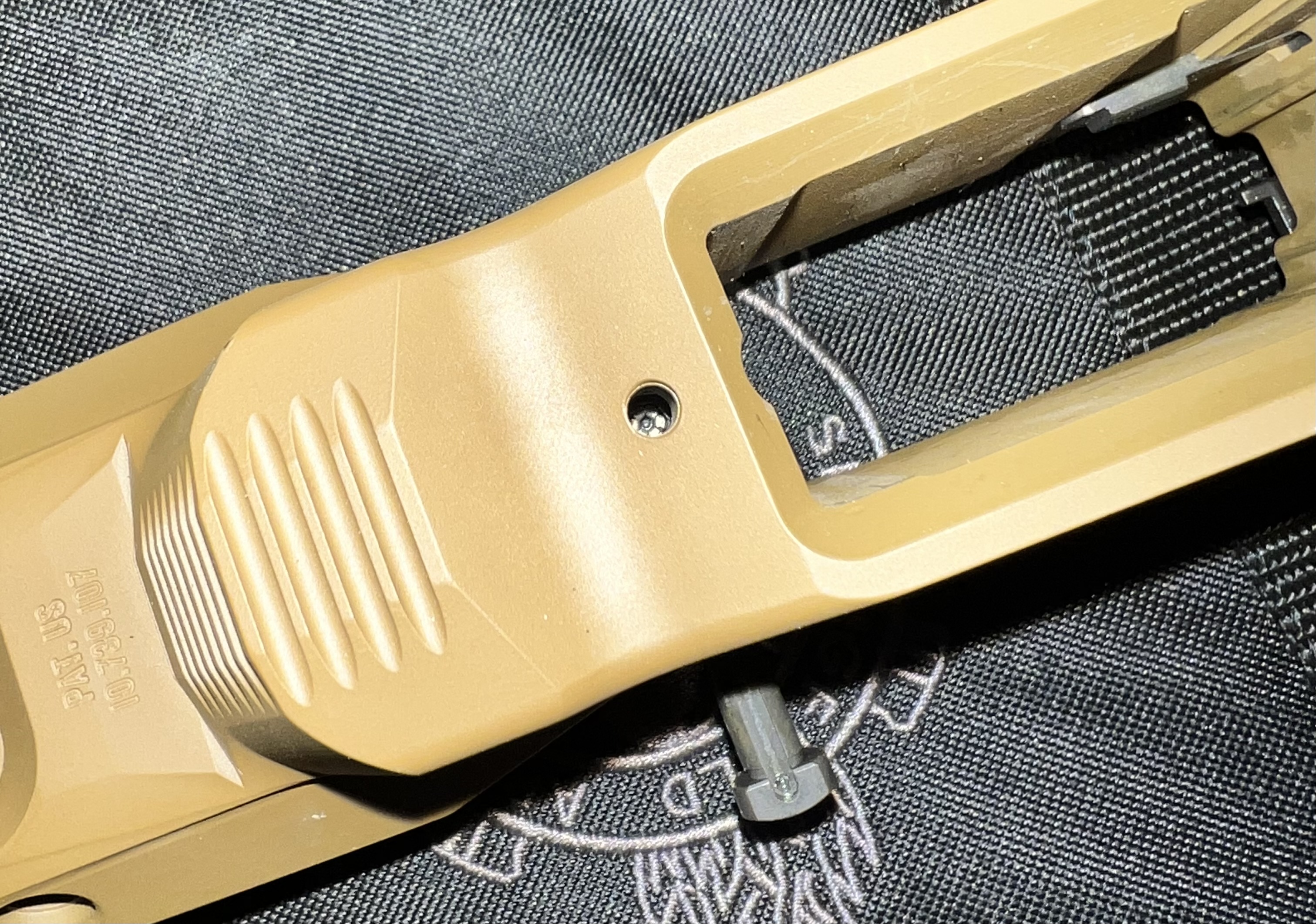

A look down the pistol grip, the small hole in the back is for the accutite screw.

Its in the manual literally the first thing mentioned about the ATC And it’s unique construction. When we get a new gun in the store first thing we do is look at the manual if we don’t know anything about it.
