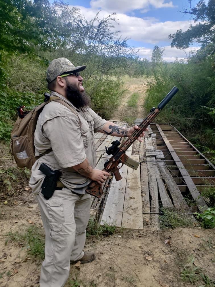

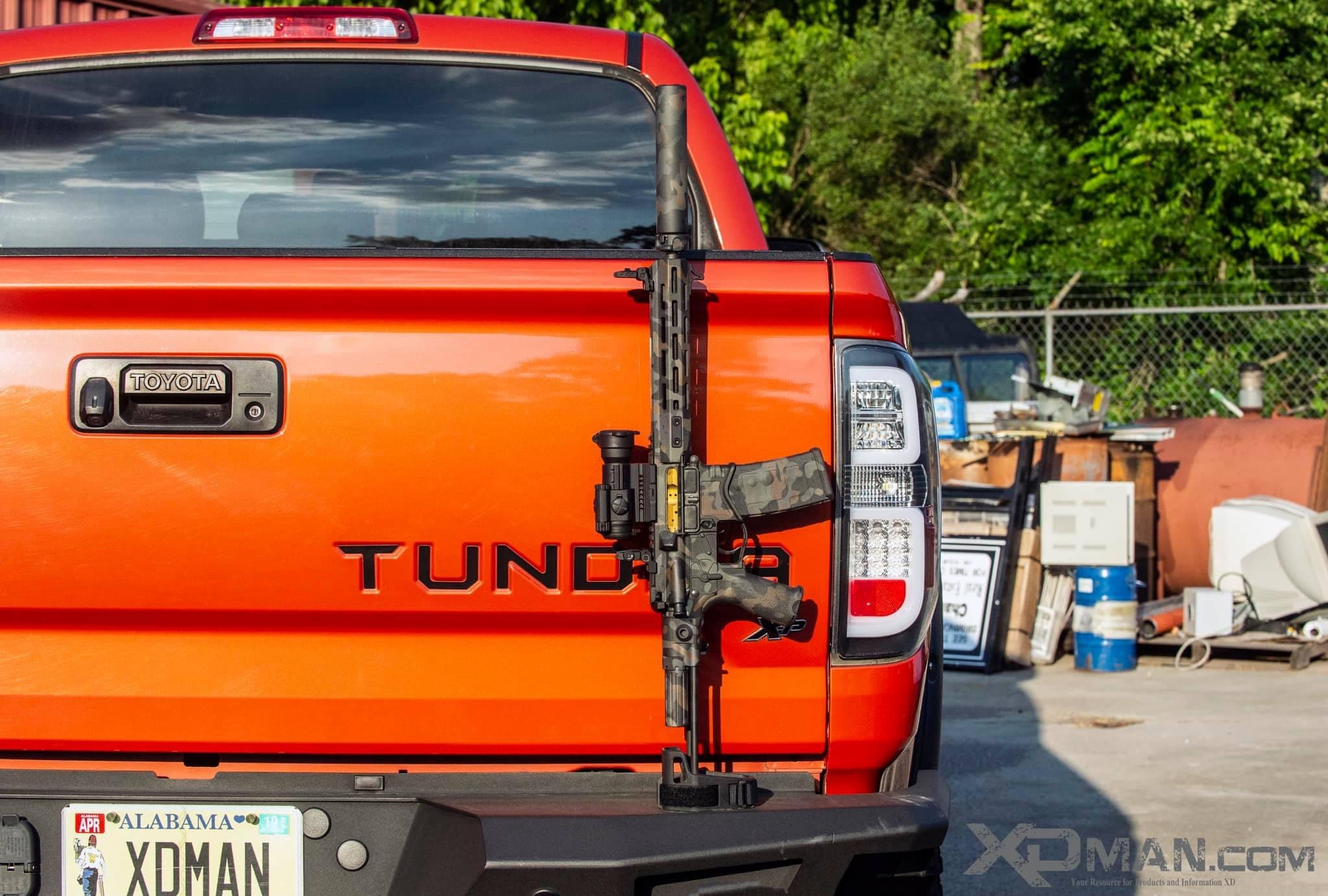

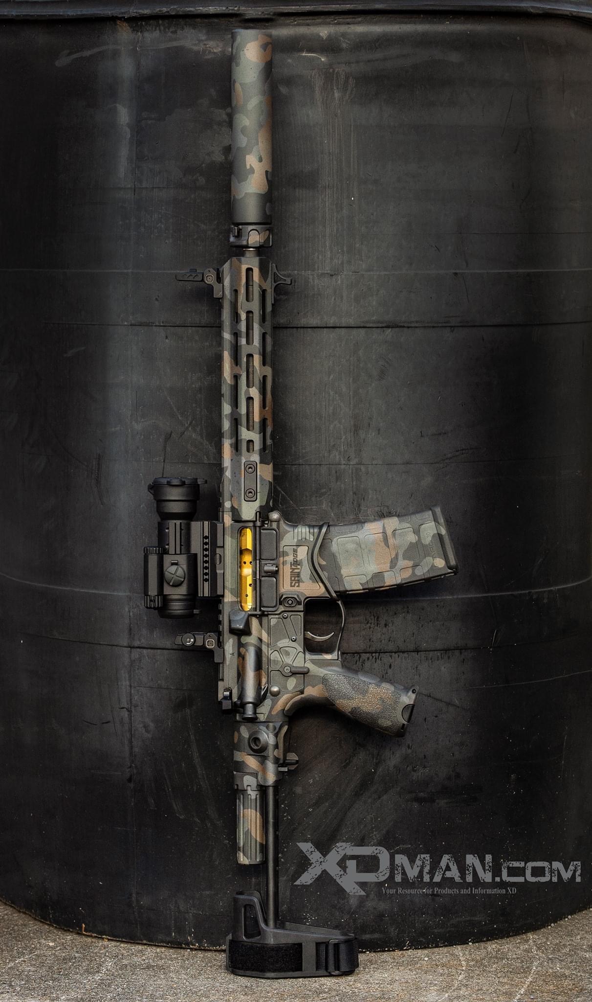

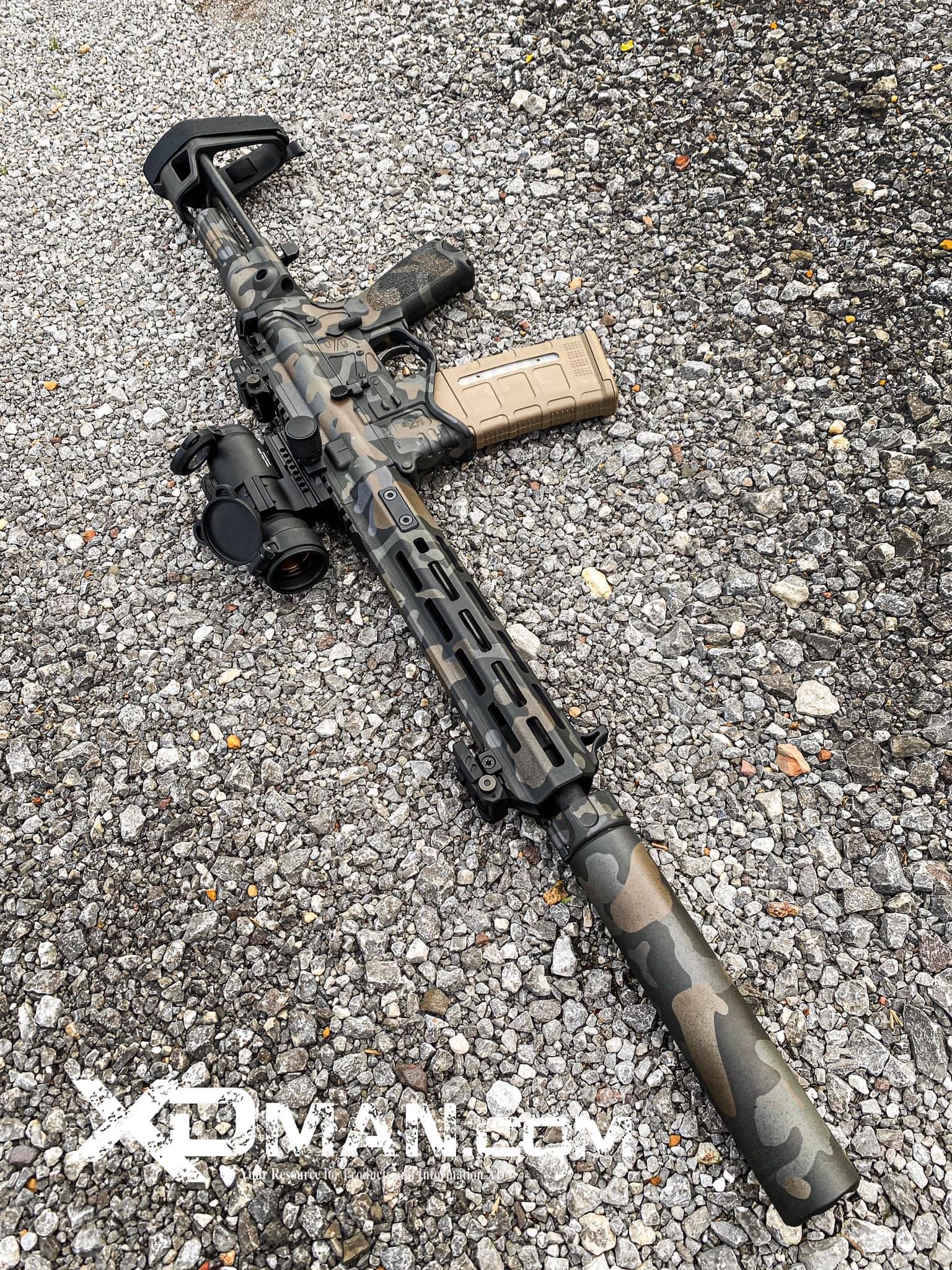

I run suppressors on my SAINTS all the time and a few of them wear suppressors permanently. The benefits outweigh the cons.
One of My truck gun Saint’s. The Edge wears a dedicated Surefire, if I ever need it I do not have time for ear-pro.

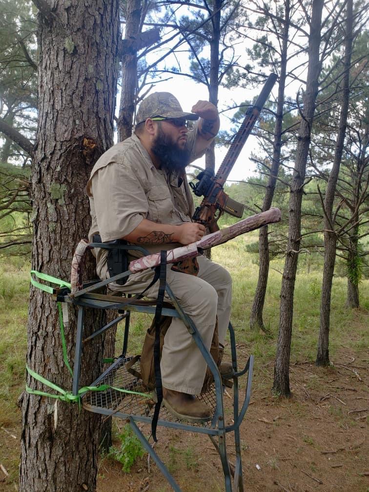

There is no right answer, and so many options you kind of need to narrow things down. Even in these two suppressors one is a fast attach, the other is screw on. One is a 30 cal so I can have the option to fast attach to any of my 30cal or 556 AR’s as long as they have the attachment break. The hunting one is titanium but screw on. So it is slow to attach but light weight. Hunting I wont need fast attach but lighter weight is more important especially at the end of the longer barrel. Then you have cost, you can get great suppressors for really good prices, fully welded all steel full auto rated. But the cost is going to be weight. See what I mean it just depends on what YOU need, want and can afford.
