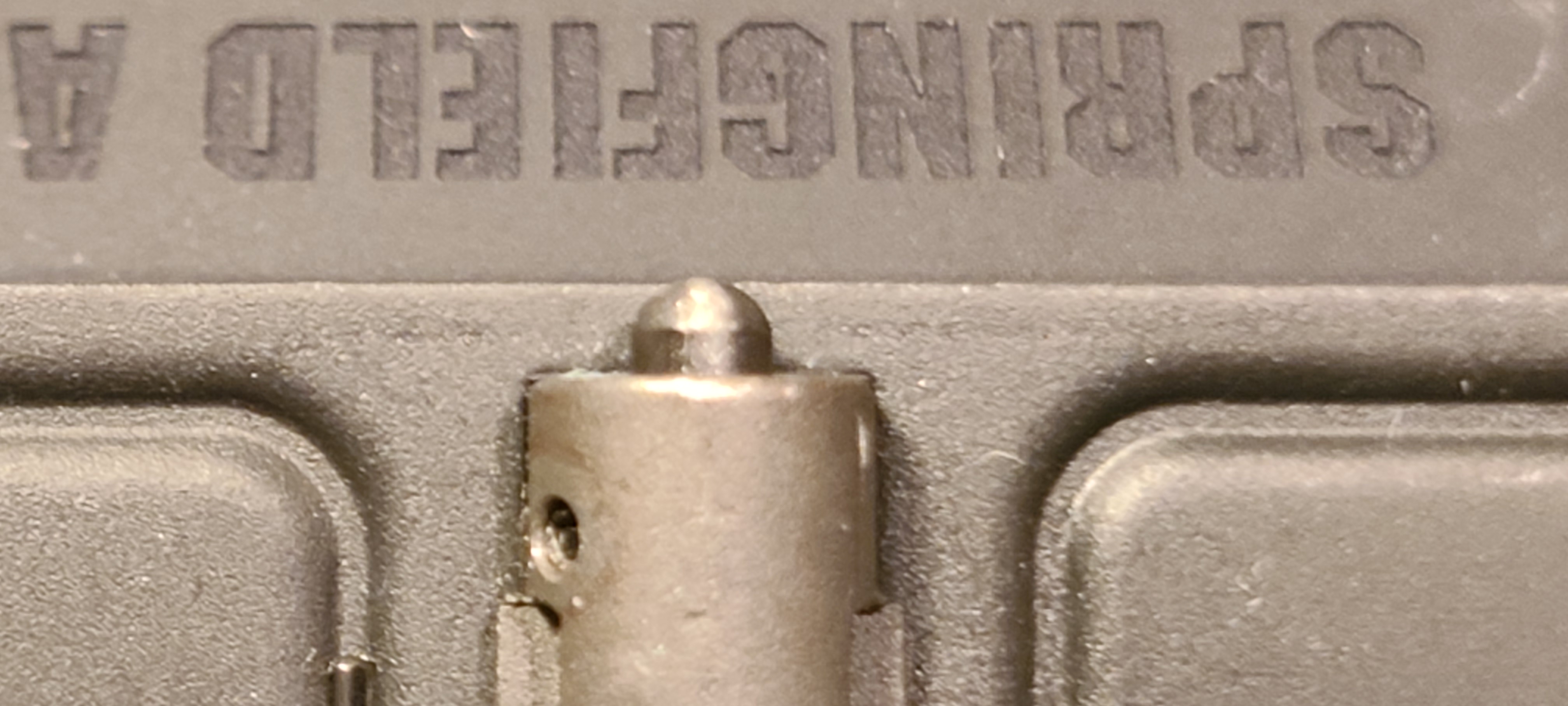

So I did get out the micrometer and do a little measuring and comparing. The rifles are my SA ar10 compared to my Ruger ar15. I know the action/dustcover is a little longer the height dimensions appear to be the same.
#1, the top of the Pin housing to the edge of the dust cover is approx. 0.003 closer to the edge on the ar10. Not good
#2, the Pin extends out approx. 0.0025 further on the ar10. Not good.
#3, the bevel on the Pin appears much less on the ar10. Not good.
AR10 Pin Picture
AR15 Pin Picture
#4, the dust cover when closed appears to be a nicer, though ever so slightly, closer fit on the ar10. Again not helping the problem.
#5, the grooved cutout appears slightly smaller on the ar10.
I would say all 5 observations contribute to the dust cover not closing though #3 is probably the biggest cause.
