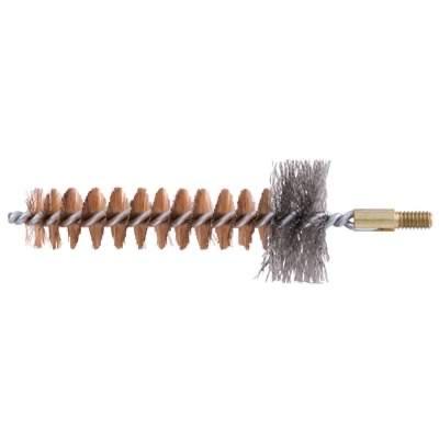

I’d give the chamber a good scrub then make sure the bcg is oiled and that the extractor thingy is setting in there correctly... when the issue happens again, I’d take the gun apart to see if it’s dry.

THanks I will give the chamber a good cleaning.
