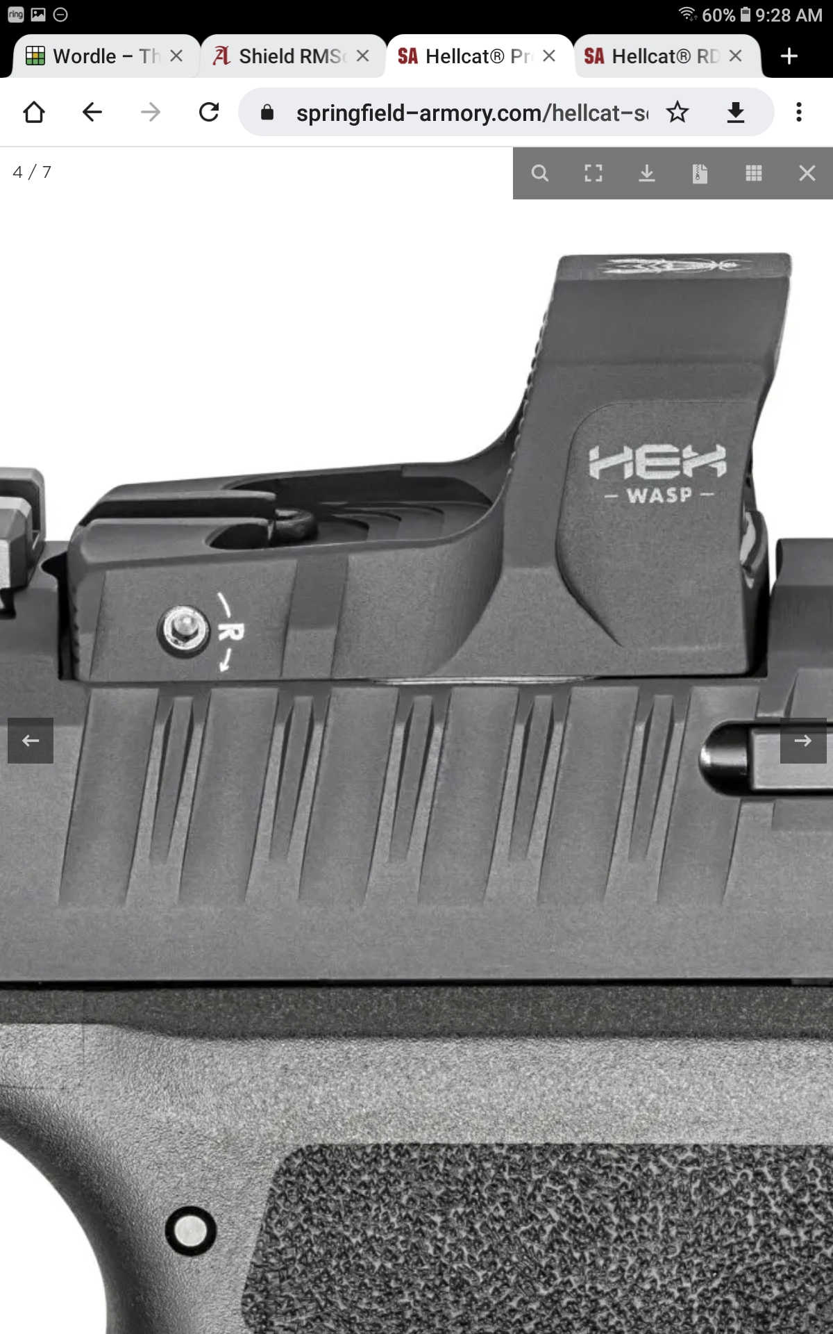

I just noticed on the SA site for the Hellcat Pro there is a single picture of a Pro model with the Hex Wasp attached. There does look to be some sort of thin plate added. Never noticed that on the other Hellcat models before all the Hex Wasp models were discontinued.

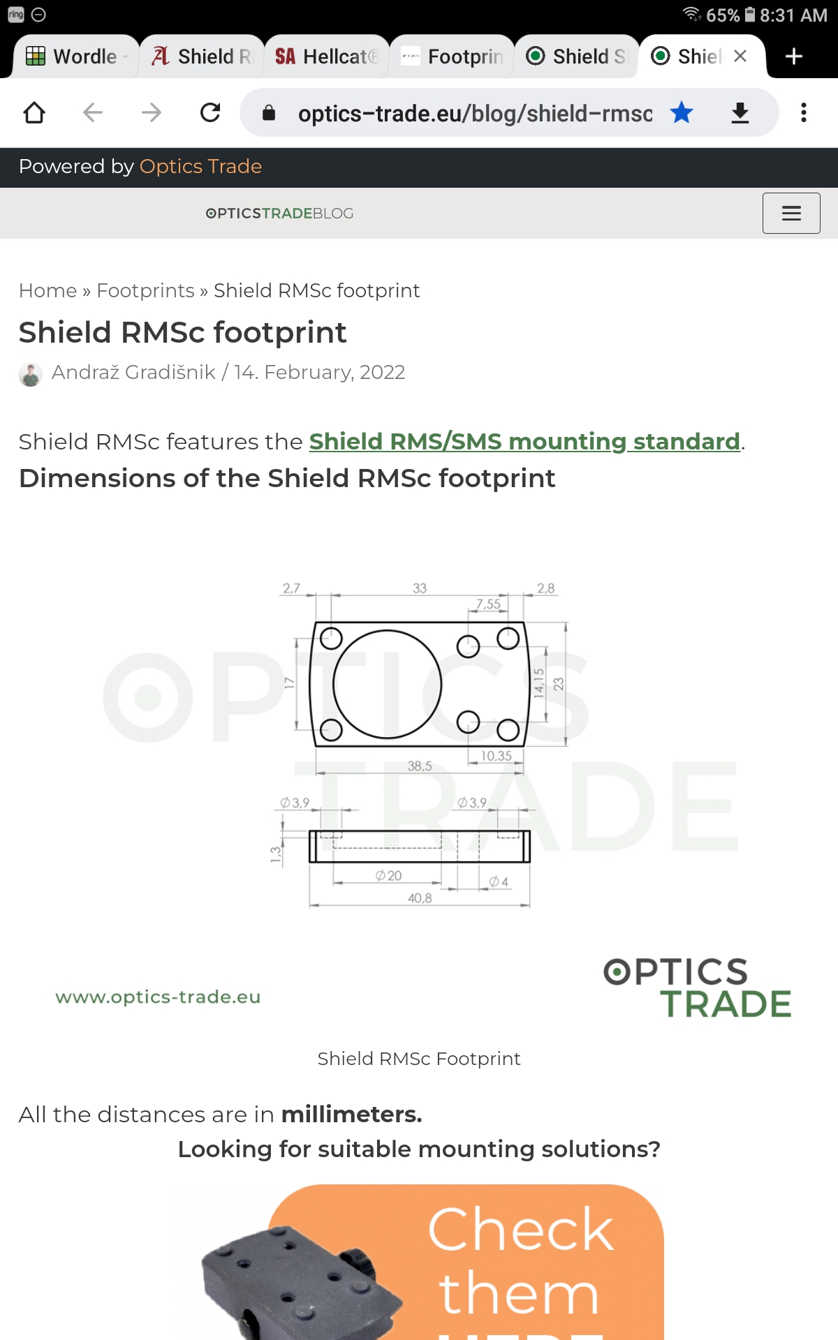

The RMSc would fit two of the posts, either front or back, take your pick, but the other two would not engage. I do not know if the distance between the front and back holes in the sight are further apart or closer together than the posts on the Pro. I believe the post on the Pro are a little further apart than the holes on the sight. I did see a post on another site in which the person said the used their drimmel to take a small portion of the material on the sight to get it to fit, which it did according to his post. I just can't bring myself to use a drimmel on a $300+ new sight. I would be interested to know if the posts are further apart on the Pro. From the picture you post, the rear of the sight sits flush, but the front is raised a little. This is what I experienced when I attached the RMSc to the Pro and tightened the screws, the rear sat flush but the front had space. This photo seems to fill that space with "shims". This shouldn't be so as it would seem to throw off the alignment of the sight from front to back, rising the front of the sight. I hope we can get some answers. its a very nice firearm, and I really would like to have a red dot on it.

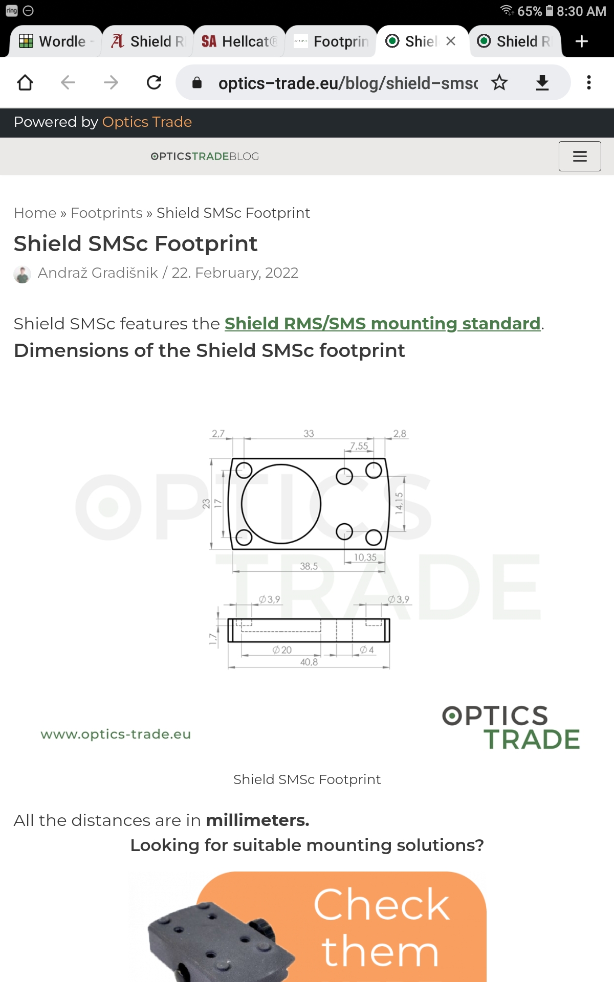

I thought I would get out my cheap micrometer and see if I could measure a few spots first to make some sense out of this.

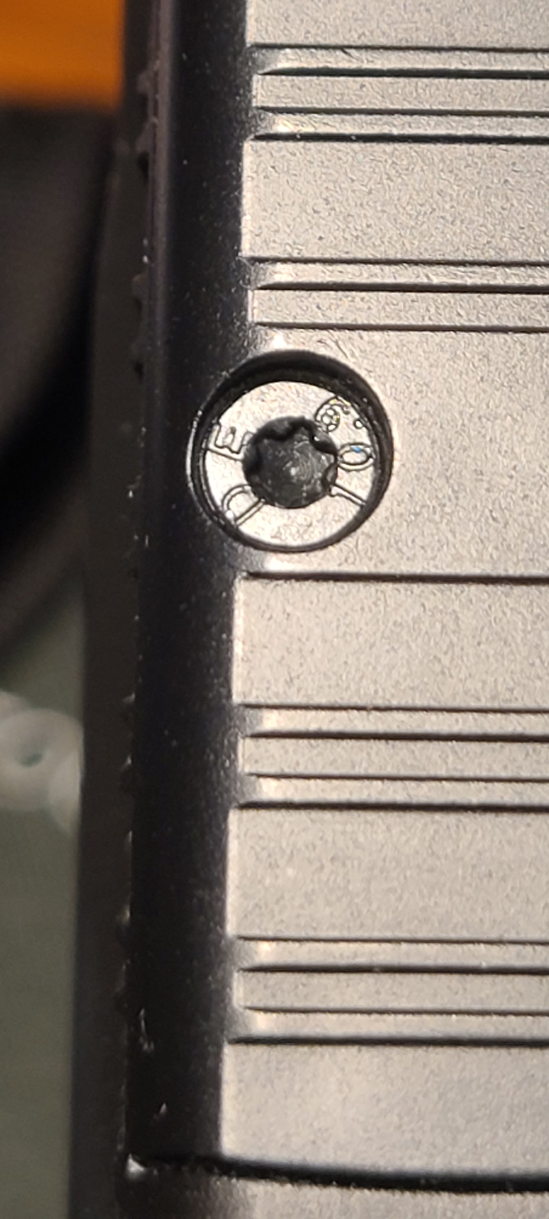

New problem - the screws holding my plate have a Torx pattern but my size 10 Torx fits too loose to be able to put any torque on the screw without stripping it. It appears the points in the screwhead are rounded a little so the Torx wrench can twist back and forth about 15-20 degrees before make contact in either direction. I don't know how tight they are and I don't want to strip them so I guess I'll try and find a Torx that fits a little better first. Where do they find these things.
Found a #10 Torx security bit that fit better, got the cover off.
I called SA and got a nice lady that said she believes the Pro footprint is different from all the other Hellcats. So I asked for both footprint diagrams and a list of compatible red dots that will direct mount on the Pro model. She didn't have any of that information available to her so she will have it emailed to me when they find it all.
I told her we were discussing this problem on "TAL forum" and that it wouldn't be a problem if we could just get the info. I'll post whatever I get.
Great, thanks. Nice to have confirmation so we are not all thinking we are doing something wrong. Why isn't this information on their web site so we are not spinning our wheels.

I was going to say that looked like a security bit screw. I know there is definitely variance between bits and frankly for removing these screws I would use actual hardened drivers instead of bits in universal drivers. My guess is there is LocTite on these screws
