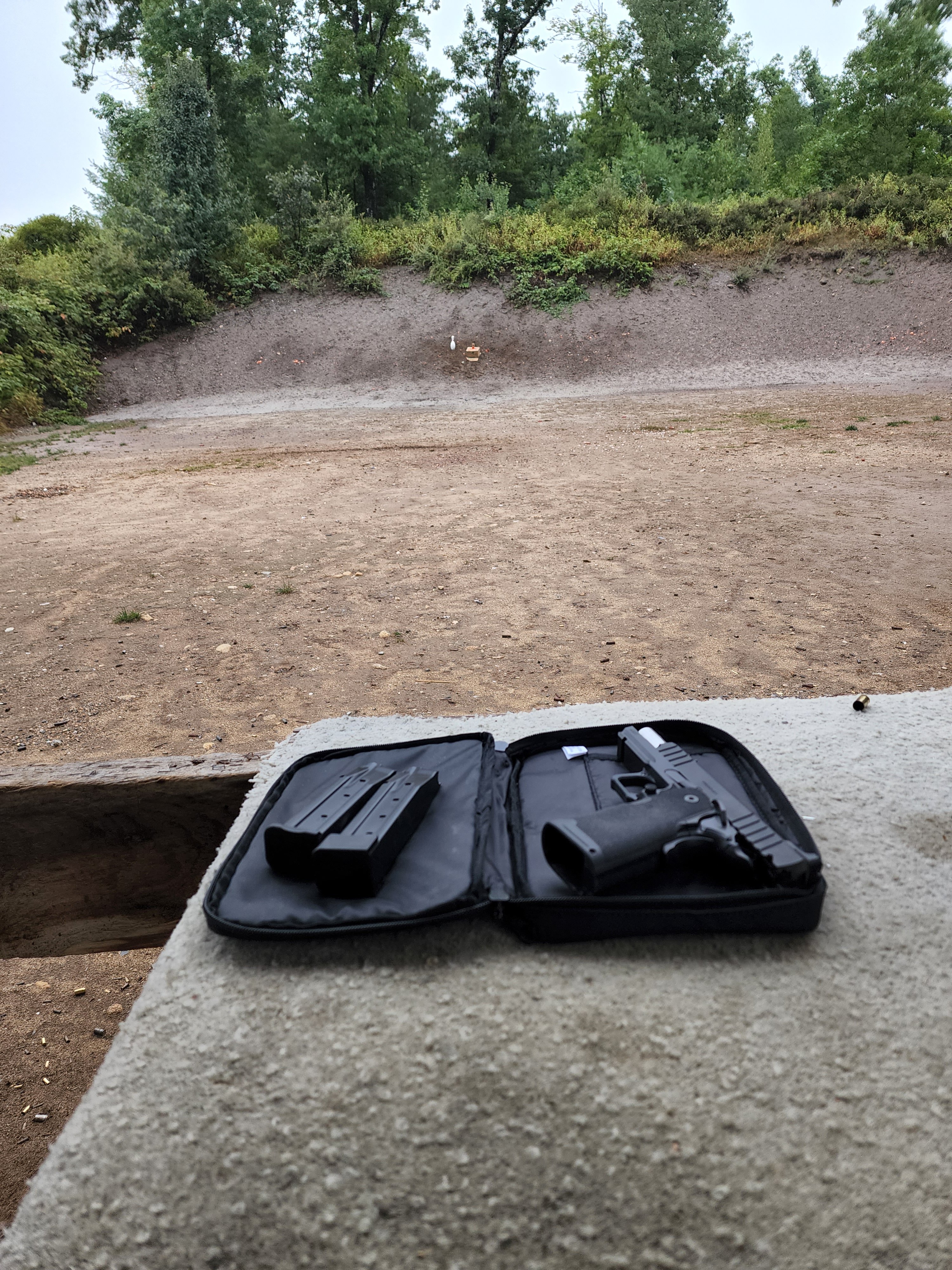

I had a brief trip to the range this afternoon and only got to run a 50 round box of 115gr Herters ammo. The pistol worked flawlessly and I was nailing target clays and a bowling pin with ease at 25yds placed on the berm. This pistol made hitting the small clays at 25yd way too easy. Covering the target with the front fiber sight was a guaranteed hit for me.
I didn't have much time at the range tonight with sunset approaching so I'll be back at the range later this week for group accuracy testing.
