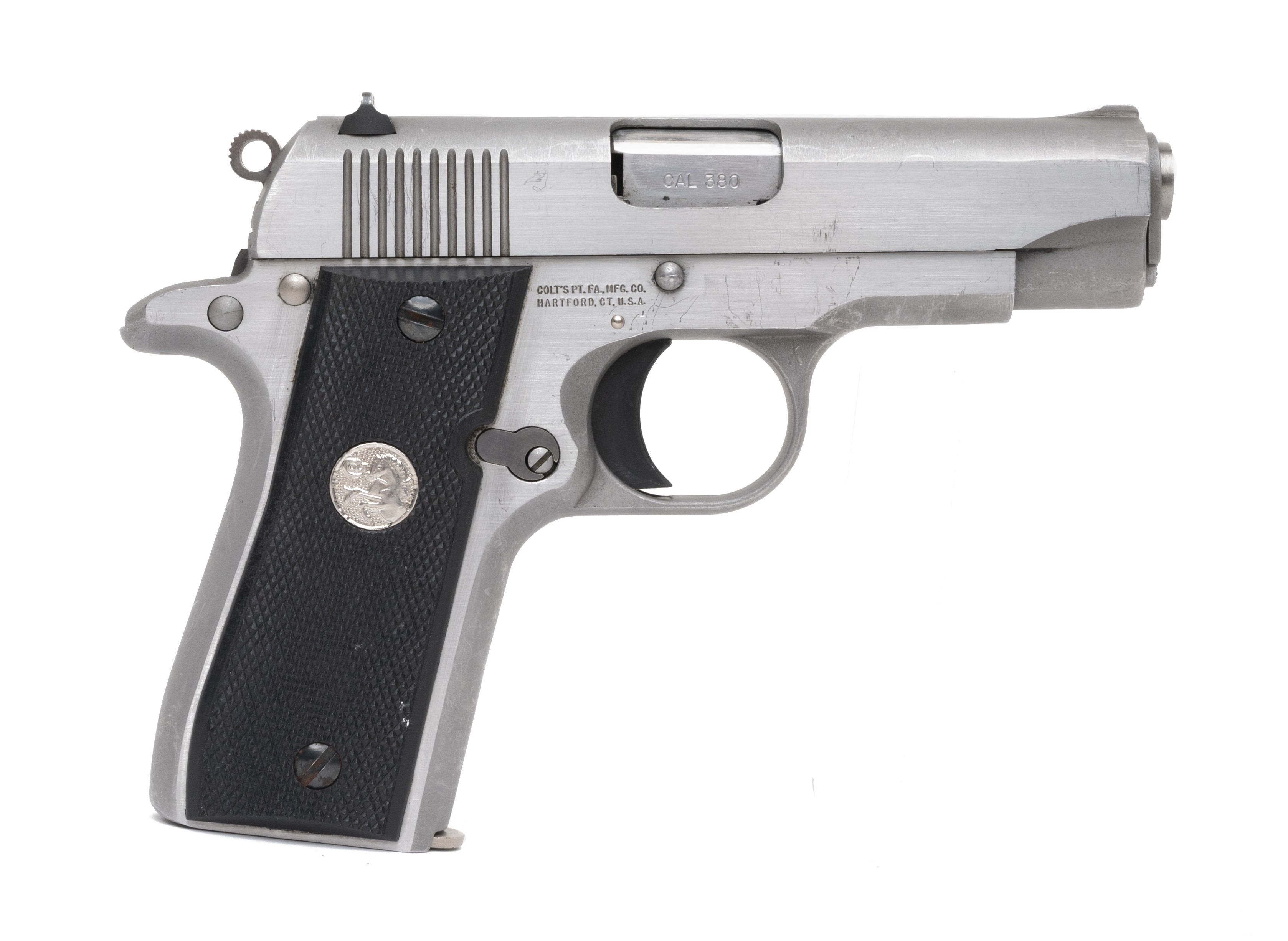

My meaning was the 911 wasn’t a true copy of the Colt 1911…….but somewhat close in visual…..hence my term a mini 1911…….
This is the Colt I was referring to, not the Mustang as a 1911, I never owned the Mustang, but I did own the .380 Govt model and the Kimber Micro, the 911, Sig and Kimber are basically the same
