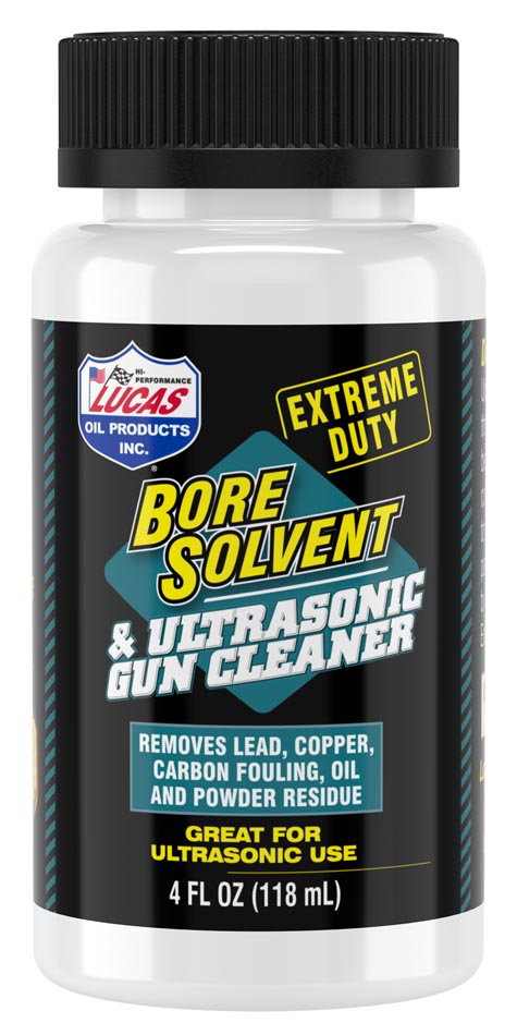

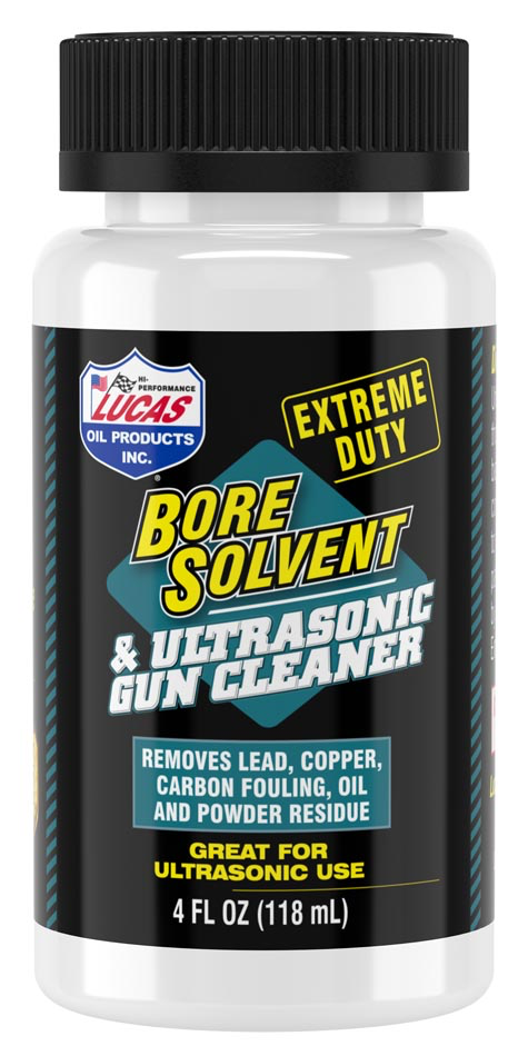

Yes, I am aware of the limitations of Gun Scrubber. Of course for the bore I use solvent: Shooter’s Choice MC #7 to be exact. Stinks like hell but very, very effective. And you just completed describing my initial problem, in that yes, I was using Breakfree CLP.Gun scrubber is a degreaser, it’s not an actual cleaner, does not remove copper fouling, lead, it will remove build up crud and any lube, you still need to use a bore cleaner, some kind of oil to lube and protect the gun, only CLP I ever saw that would have a build up was Breakfree CLP, plus you definitely have to watch Gun Scrubber on polymer guns, even the so called polymer safe version, they will attack the polymer.
Yep, used that in the past till I came across this, works real good, just a FYI for you........plus it doesn't stink really, almost smells like grapes....Yes, I am aware of the limitations of Gun Scrubber. Of course for the bore I use solvent: Shooter’s Choice MC #7 to be exact. Stinks like hell but very, very effective. And you just completed describing my initial problem, in that yes, I was using Breakfree CLP.
I don’t own any polymer guns. Not my thing.
Is this stuff safe for chrome-lined bores?Yep, used that in the past till I came across this, works real good, just a FYI for you........plus it doesn't stink really, almost smells like grapes....
