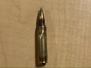

I have a Springfield Saint AR-15 that keeps jamming. It jams so bad I have to have a gunsmith unjam it.
Attached is a picture of what the bullet looks like when I get it out.
The gun was professionally cleaned & it jammed after only 10 rounds.
Does anyone know how to fix the gun or a good gunsmith that might fix it?
Thanks

Did you load that same round into the mag after it jammed?
The 2 dents seem kinda strange on the same round I've seen a BCG cause a single dent on a failure to feed but not 2.
What brand of ammo are you using? Are those reloads?

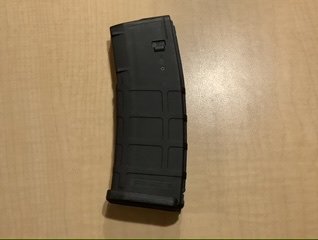

How old is the mag you are using? And if it is used, have you kept it fully loaded for long periods of time?
I would start with the mag by trying another one. If the problem persist, I would change ammo. If problem persist, throw a different bolt carrier group in it, if problem persist send it in to SA they are fantastic with warranty.
Have you tried loading one round at a time in your mag? Also how are you charging your rifle? The charging handle or the bolt release? When it gets “stuck” do you have a picture of the round through the ejection port? Pmags are usually very good mags and are recommended, at least for me as quality mags. You could most definitely try different mags and try to recreate the problem. Looks like geeen tip/Lake city Ammo. (M855)

I was having this exact problem with my PDW. I found that the lug was out of spec. The first round would go in fine, but the lug was damaging the second round which would cause it to jam in the chamber. Springfield ended up replacing the entire BCG and I haven't had a problem since.

Looks like the same cartridge dent (1) that was on the first round that chambered after removing a Hornady Rapid Rack device from my St. Vic. Don’t recall now if the PMag was filled to capacity (rather than 2 less) but since it jammed the casing twice on reload, I felt the Rapid Rack wasn’t ideal and no longer use it for anything more than a range safe chamber device as it may have impeded the feed delivery of the new round into the chamber as it sat (maybe askew?) in the pmag.

I also don't think there's a problem leaving a P Mag fully loaded. I've never had one anyhow.
