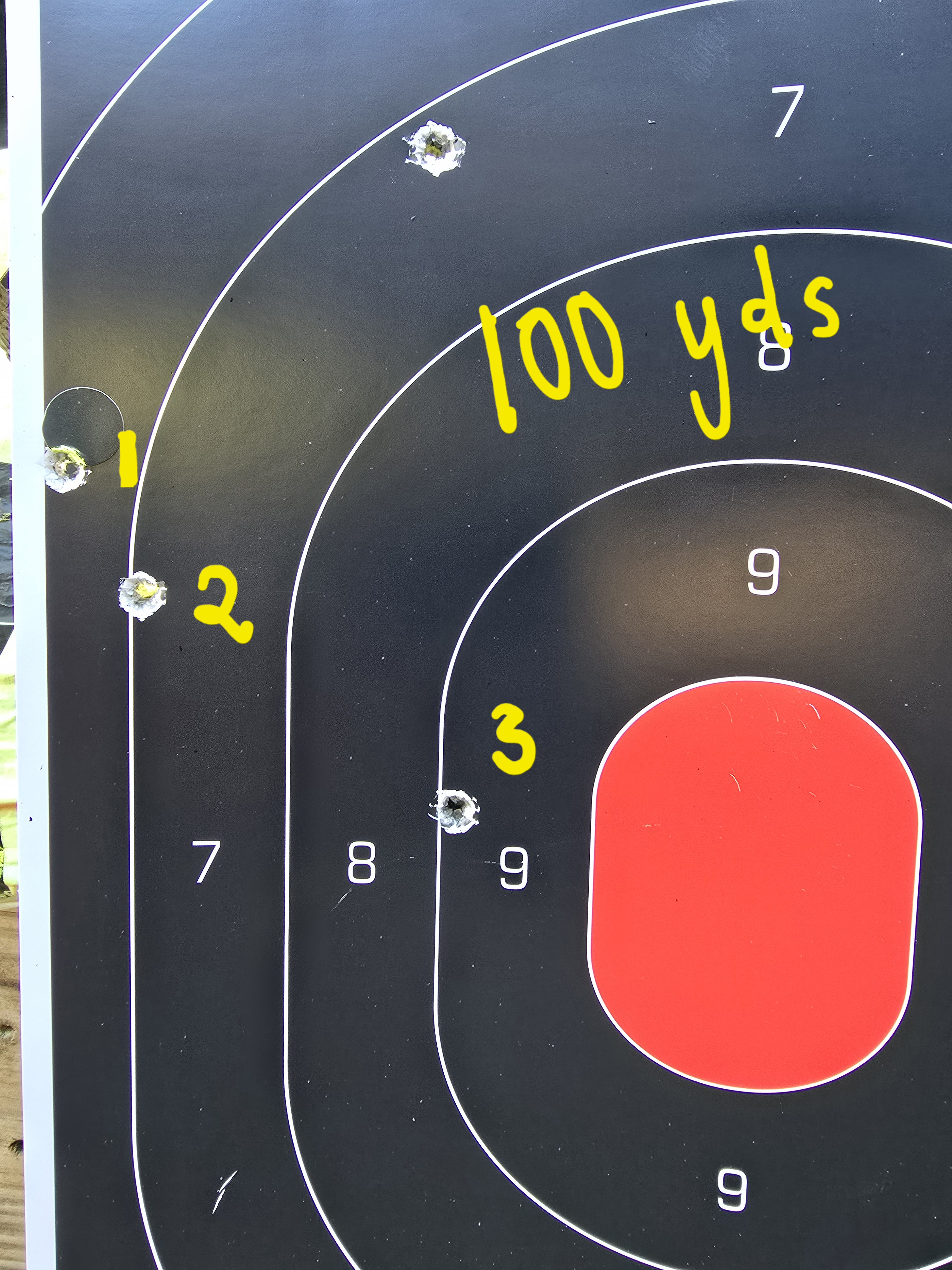

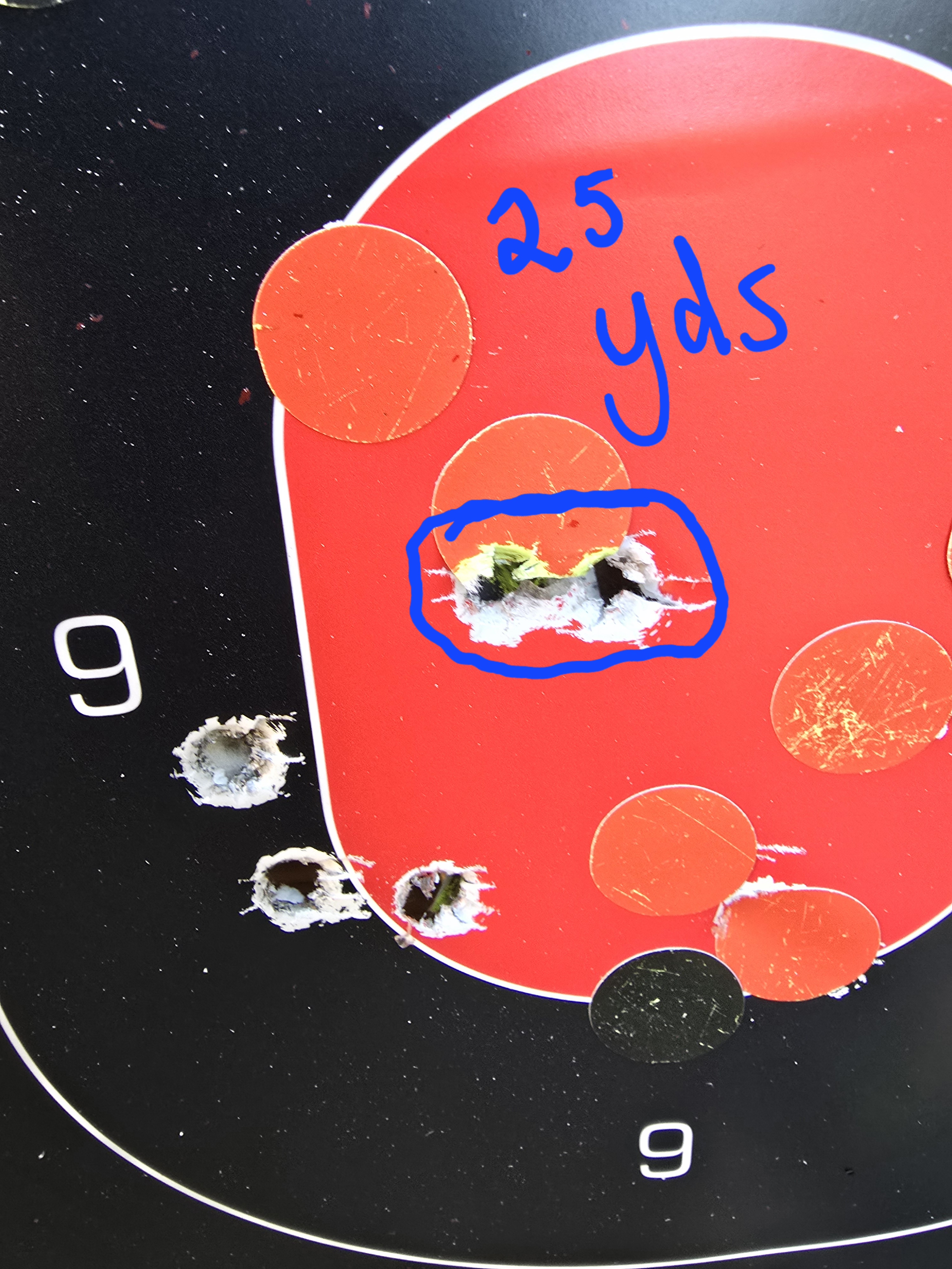

Greetings, so I checked the mounts and they were up to torque spec. I went out shooting again earlier. The circled touching shots were the last 2 shots at 25 yards. So I backed up to 100 yards with my shooting bench and expected the to be high at 100 yards but I'm a little baffled on how the first 2 shots at 100 yards drifted so far left. The 3rd shot was after making some adjustments to the scope but that was also my last bullet unfortunately. Any ideas on what would cause shots in the red at 25 yards to drift so far left at 100 yards?
Distance.
The shots to the left at 25 is magnified at 100, and more further out.
Figure out what your standard zero distance will be and adjust accordingly.
No idea. I would contact SA. Share the pics and what you did. May be a bad barrel? Send it back and have them evaluate it.
Did you use a proper bench rest ? Sled ?
At 100 yards, shooter error on the trigger, or technique can be pretty magnified.
Has anyone else shot the firearm to confirm?
