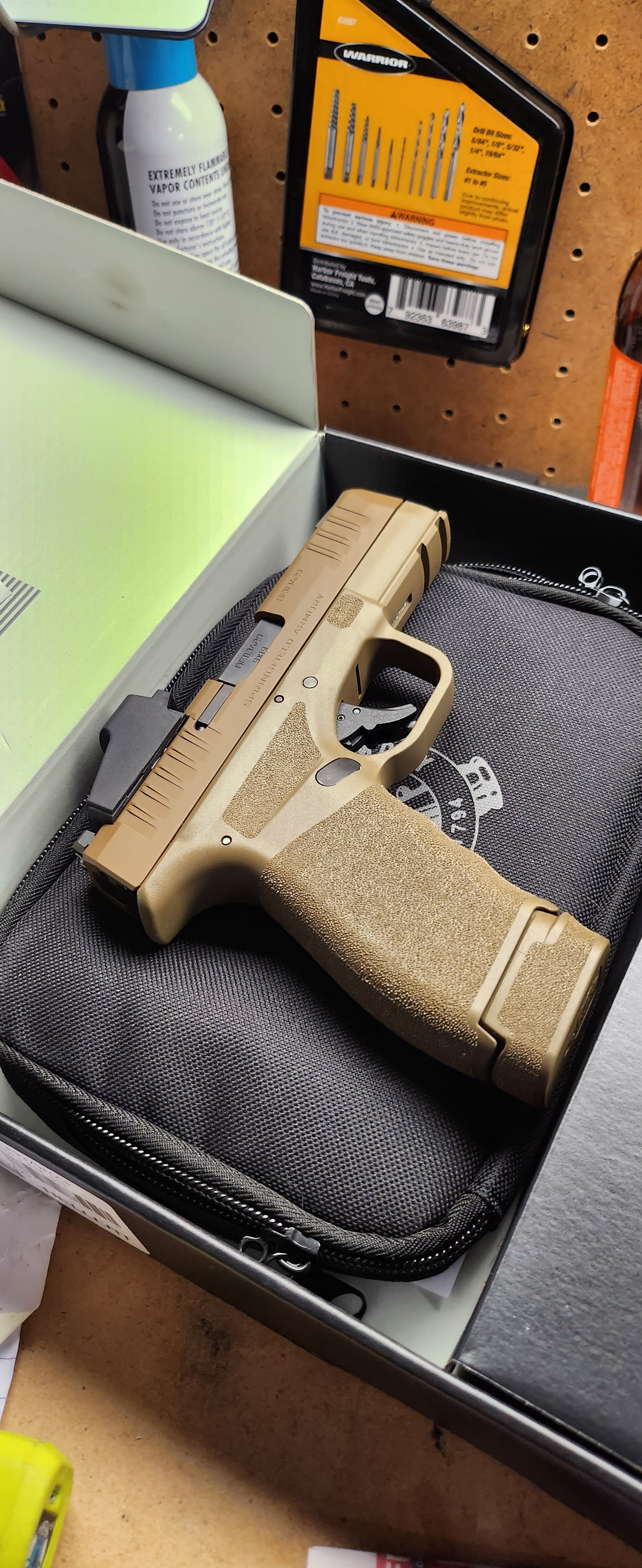

Stripped star head optic plate screw
I had to go dig through my box of many things... yep I found the old ones and they are indeed shiteY T10's and they put Blue Loktite on them...
Just got off the phone with their cust service. From the gentleman's own admission; "With the Allen wrench we send out, there isn't enough leverage so it always strips the screws out; it's a known issue." I politely told him if it's a known issue then QA needs to be told to fix their crap (meaning the issue) instead of letting it slide, because it causes more call volume, product waste, noneconomical expenditure of time and resources, and extremely poor customer satisfaction. If this is the fist impression, I'm really not impressed. He told me I would have to take it to a gunsmith or send it in. Dandy. Just dandy.

Got the set of extractors, made sure I tool my time, and whaa la, issue resolved. Now I can't wait to fire this thing. Thank you to everyone who responded and helped me come up with the best solution. You all are great!
