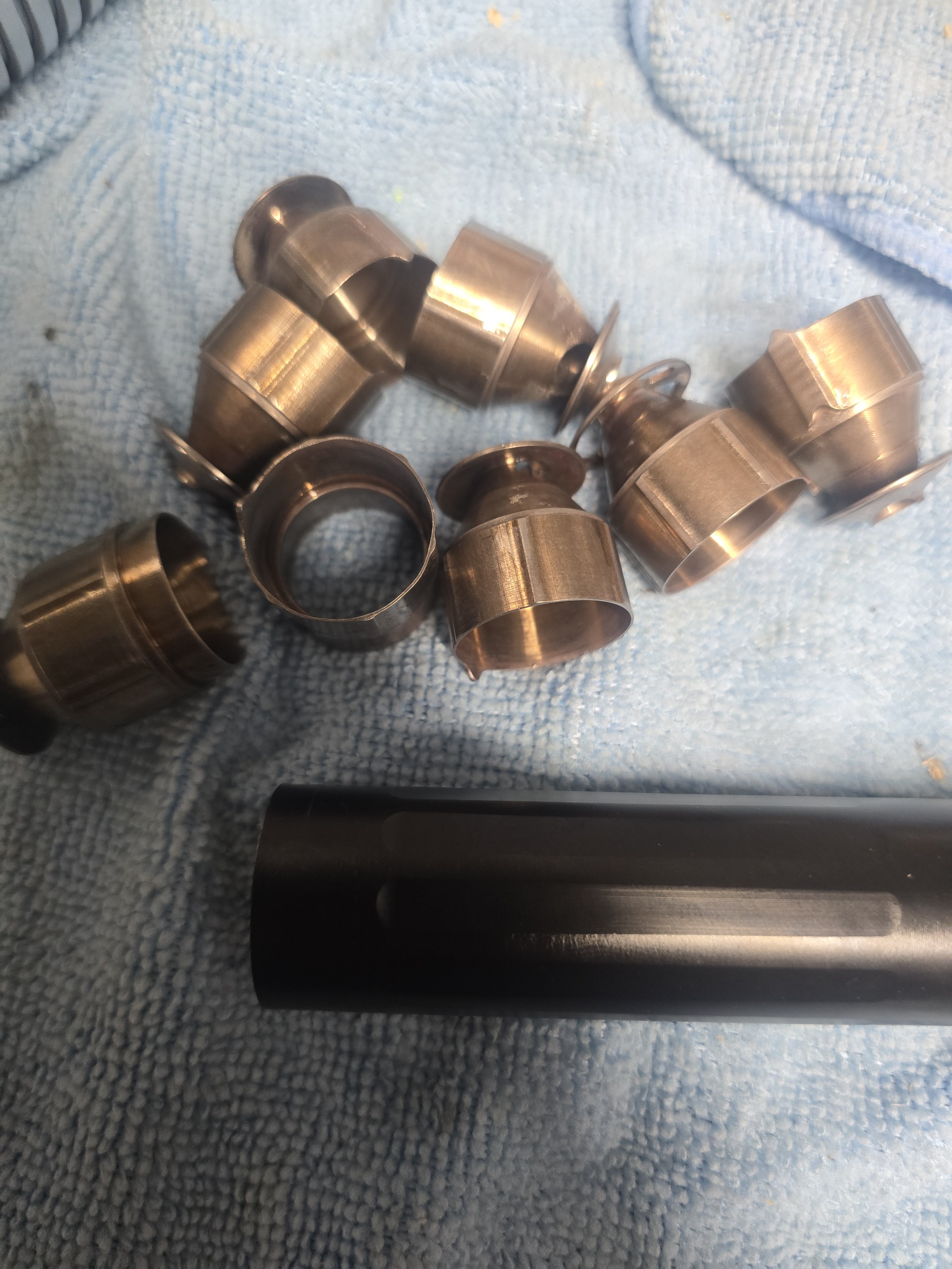

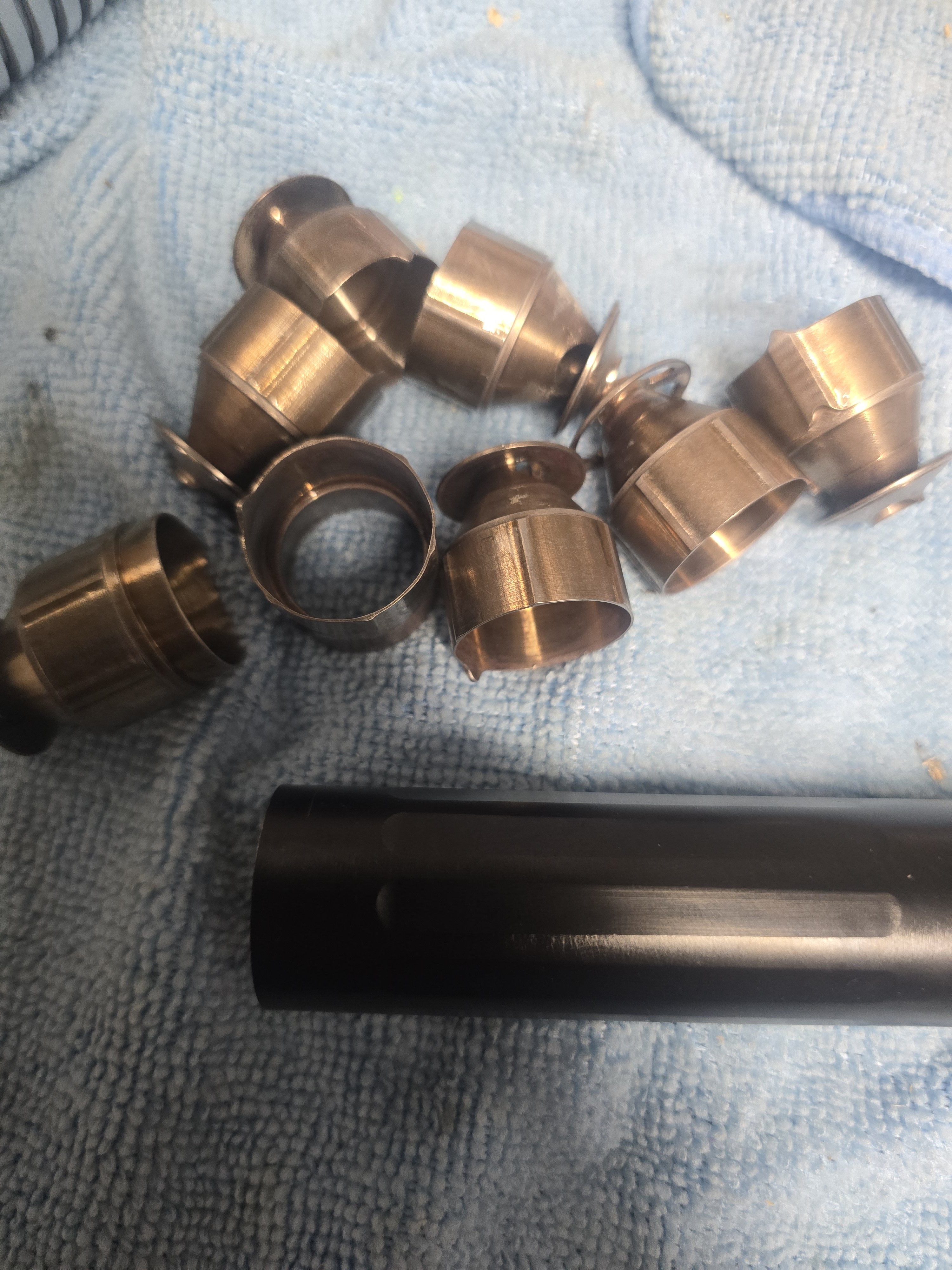

Here's the cleaned baffles after using the vinegar and sonic cleaner. They havent been this clean since they were brand new.
WOW, those are nice and shiny again. how long did you leave them in the vinegar and how long in the cleaner?

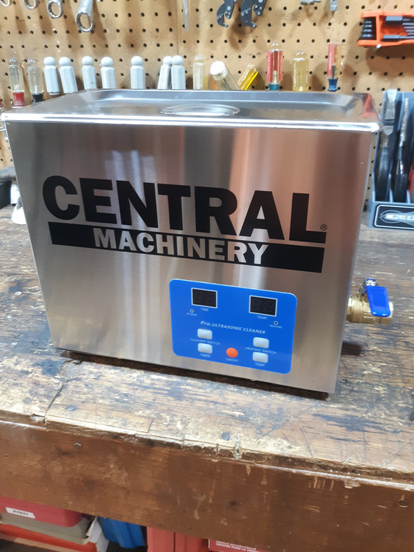

Probably about an hour soaking in a tunnel then I got the idea to use the sonic cleaner. They were in the sonic cleaner maybe 1/2hr. I still had to knock off the heavy carbon and lead but it practically fell off.

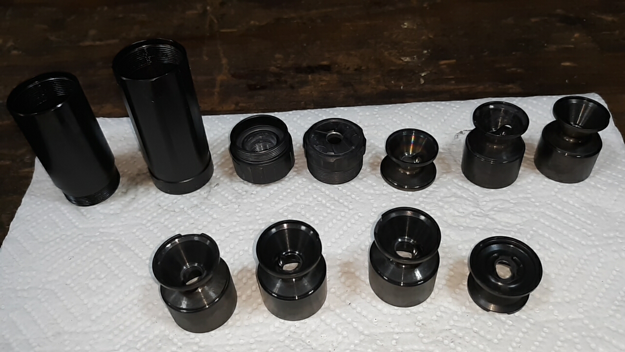

Just bought an Obsidian 45 whose baffles looked like that. 50 rds later they were flat grey.
I have ab Obsidian 9 but I haven't had to clean it yet. It's stayed pretty clean so far without maintenance. Probably the higher velocity 9mm pushing the carbon out.
I
i've got about 400 rounds of 115gr and another 600 147gr subs through my Obsidian 45 so far and haven't cleaned the baffles yet. Black as hell but it runs great, no issues. Haven't swapped the mount back to the piston to shoot 45 on it yet.
