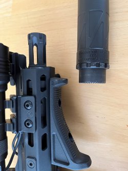

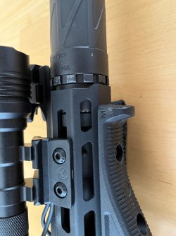

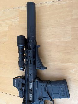

Here is an example of three different SAINTS two would require a different handguard to run a suppressor.
This is one of my SAINTS that is set up, for a Surefire can.

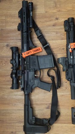

Nothing added to the barrel yet, as I still haven't had the chance to shoot either the 308 Victor "pistol" or my Edge PDW (slow surgery recovery...).
I do have them set up pretty good with some basic stuff, but nothing elaborate yet. Updated pics later today.
Not sure if your problems are from the suppressor or not...
Where do you get those Empty Chamber flags and stops at?
I believe our unit armorer gets them from either Amazon (or somewhere similar) and puts them together to make a two-piece chamber flag. Much better than the sorry gizmos we're provided, and "BobM" may have a good link. We have them for our rifles and pistols on base, and I have "re-purposed" a few of them for home weapons' op-checks...:LOL:

You can suppress the PDW using the Yankee Hill Machine Phantom QD Adapter and muzzle device. So the only modification would be swapping out the muzzle device. The phantom adapter fits inside the handguard.
