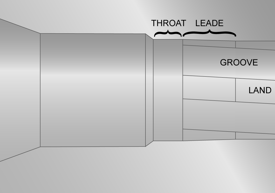

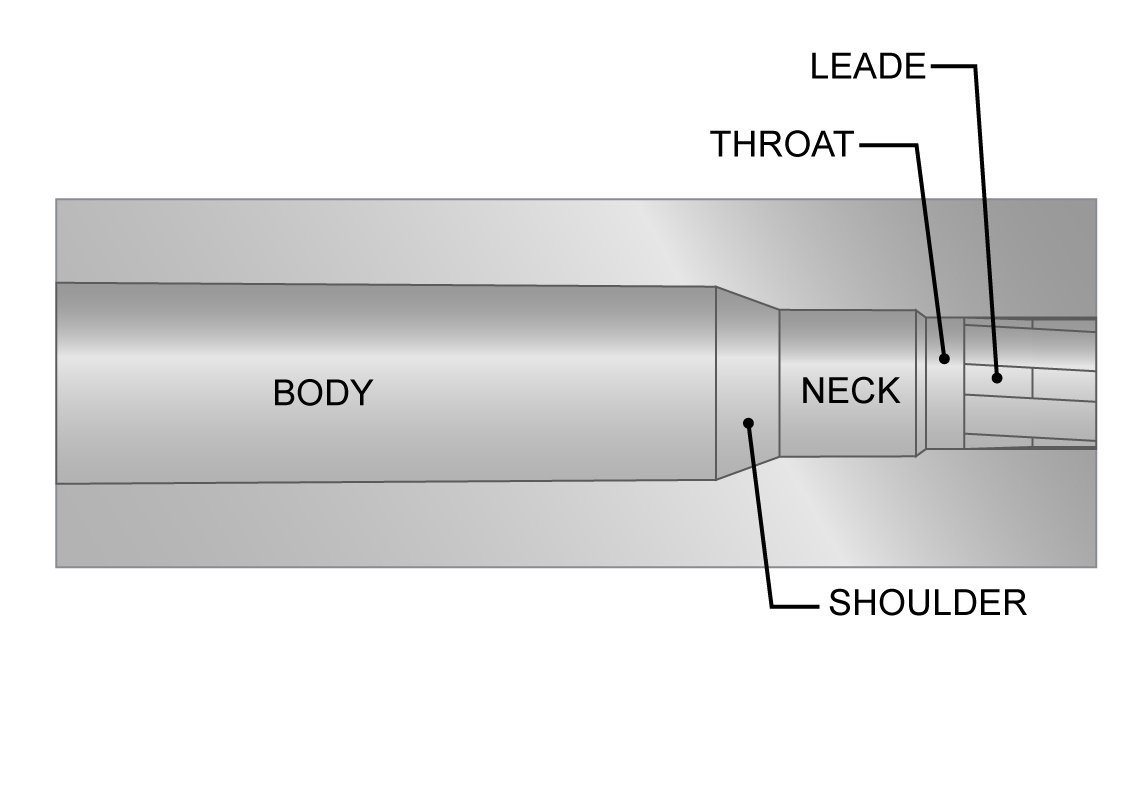

Keyholing can be caused by a few things. Twist rate vs bullet weight, bore size too large (seen this on a Polish tantal) and chambers not being cut properly causing the bullets to enter the barrel off center. Even bullets can be off by .001”, and can have a negative effect on how it stabilizes.
The one has more affects on accuracy than people realize, is the chamber, and throat erosion to a certain degree will determine if a barrel is indeed shot out.

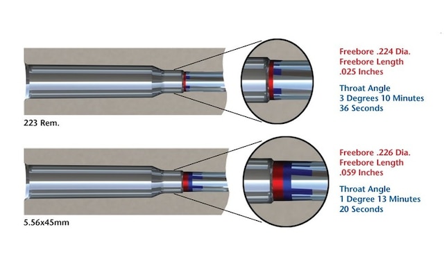

Yes. If the chamber is to blame, erosion the throat and beginning of the leade will get larger, changing tolerances and allowing the bullet to do things it normally doesn’t.
This is a good quick read on chambers being improperly done.
This is too.
