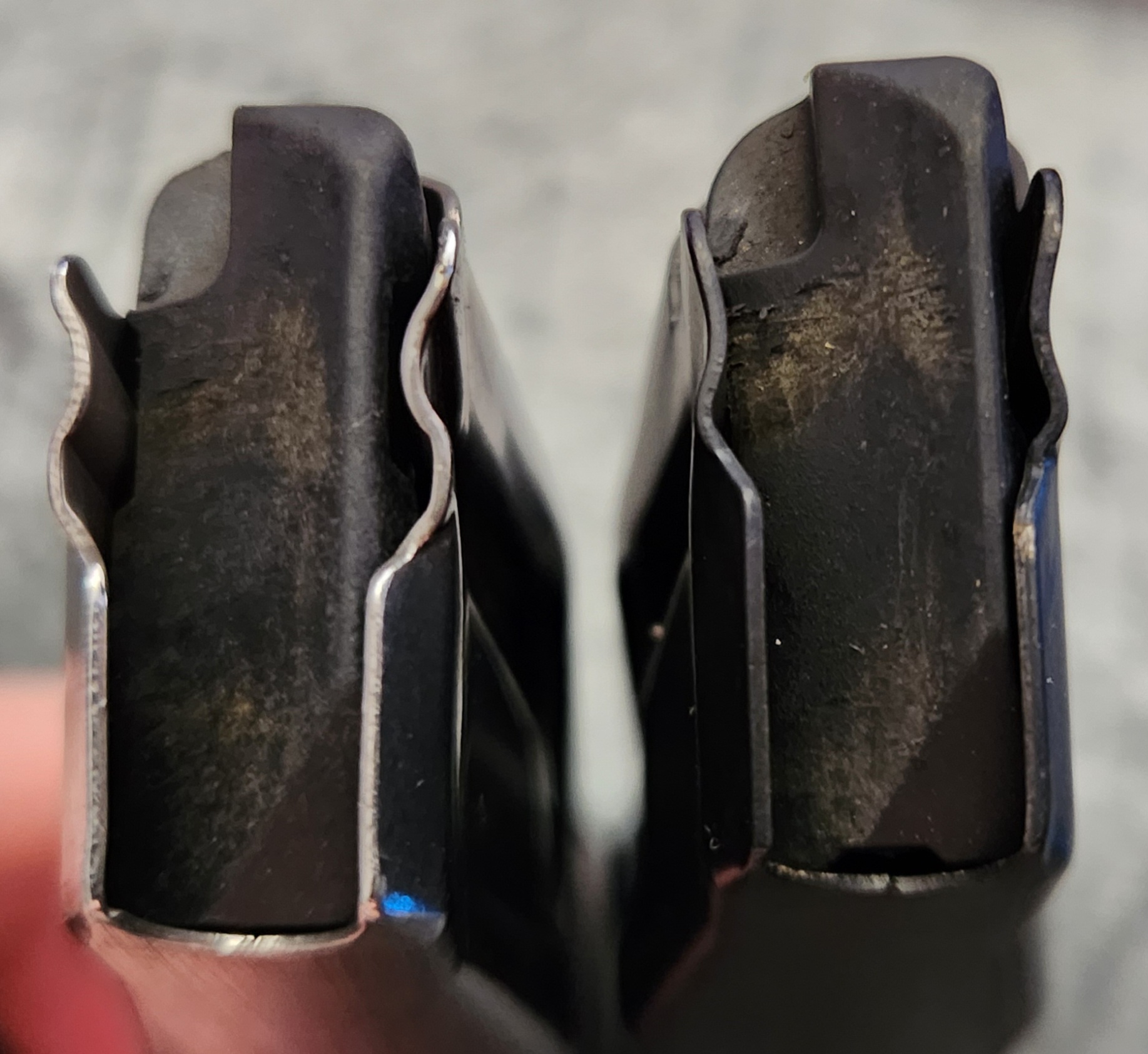

Just took my prodigy out. What a nightmare. Failure to go into battery, failure to feed on every two or three rounds fired. Ended up putting a littler over 1200 rounds through it. After about 700 the 20 round mag was good to go but on the last two mags I had at least 3 failure to feed on that mag.
After a trip to SA, my Prodigy was still having going into battery issues, but I tried out a Staccato mag and it ran flawless, and has ever since. About 1,000rds through it now and zero issues with Dawson Precision Staccato mags.
The geometry on the SA mags vs the Staccato mags are very different (See pic below - left is Dawson staccato, right is Factory SA). If you can I'd suggest trying a Dawson Precision Staccato 17 or 20rd mag and seeing if you still have any issues.
I'll be contacting SA about my mags sometime in the future.
Call up SA, get an RMA..send it and the mags back. I’m over 1K through mine since getting it back. I think i’ve had one fail to fire, and I’m going to chalk it up as a bad reman ammo round, it’s all I run through mine. I usually get 1-2 per 1K rounds I buy reman failing to fire. I put a little over 100 through mine the first time out, my experience was exactly like yours…. How you made it through 1200 blows my mind. No way I have that much patience to run that many through with a new pistol. Best thing I did was not try to fix it myself, let SA handle it…
