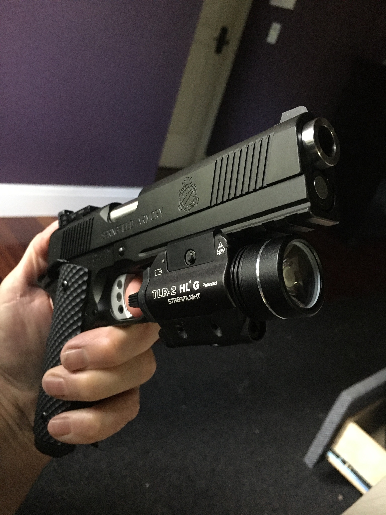

I have a trp operator, full rail .45

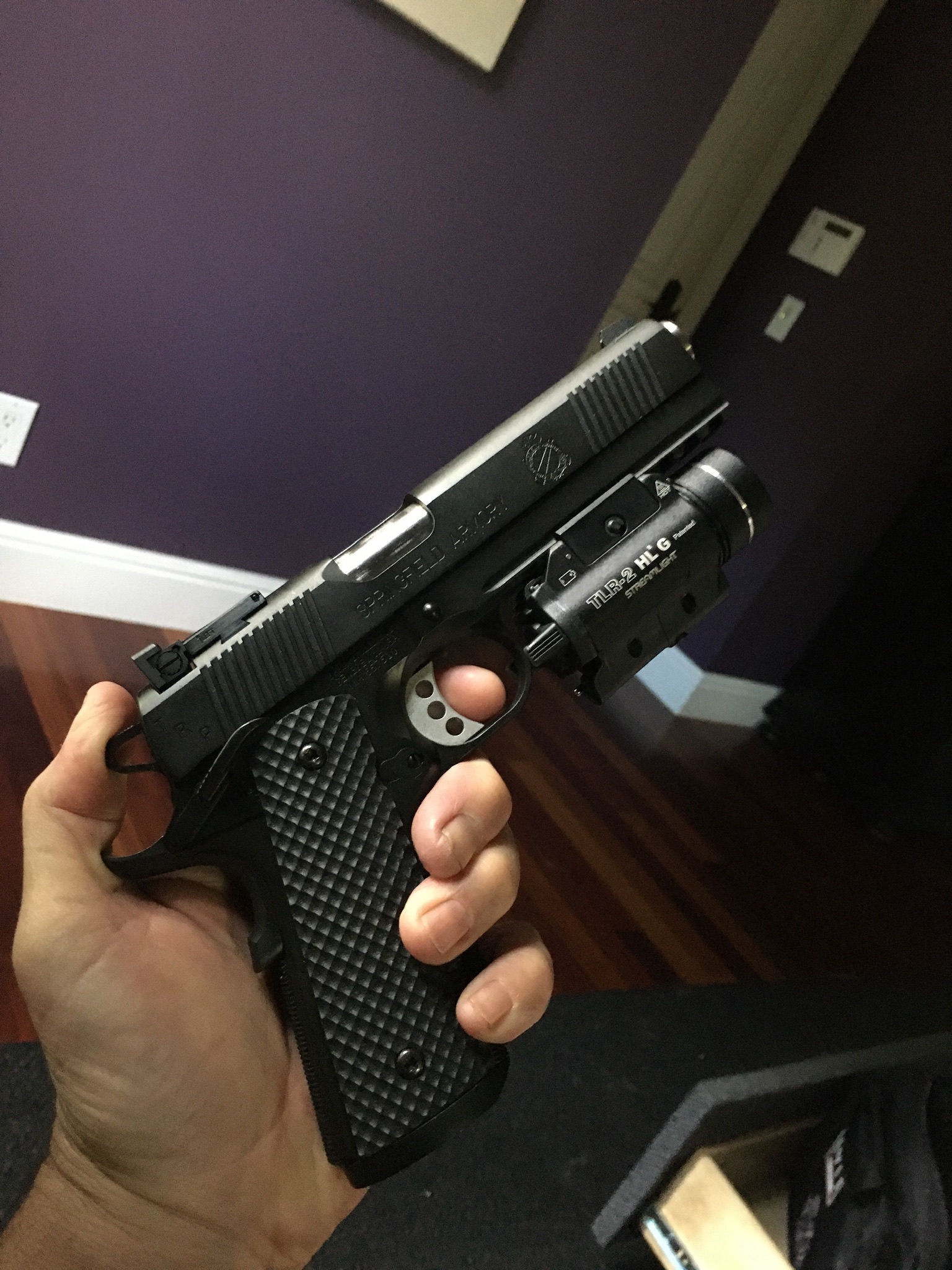

can this trijicon rmr 2 be made to fit that gun? I understand it’s expensive but that is a pretty nice sight. I shot it today at the range on a walther Q4 and I liked it. I would like to have it on my trp operator. This is a picture of my .45 with its current adjustable iron sights.
I didn’t see plates or any mounting information to lead me to believe that would be possible. from looking at my sights on the trp and looking at the trijicon rmr it doesn't seem to be compatible.
maybe a gunsmith could modify the slide for me. IDK

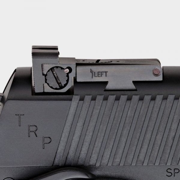

I guess my question is, if we look at the type of notch that is cut into the slide for the rear site, it doesn’t look like any RMR sight would fit there or at least like some adapter plate would be needed? is there some type of standard notch that has a name that I can use to google for adapter plates for a sight of type “abc-something” name to see if I can mount something else there?
For dimensions of the rear sight they says this:
The fully adjustable rear sight has a 0.125-inch notch that's flanked by two tritium dots. And as I said earlier, it's recessed into the slide. The serrated front sight is 0.119 inch thick and 0.181 inch tall, and it has a single tritium dot.

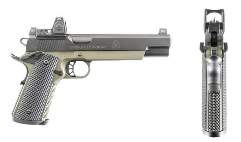

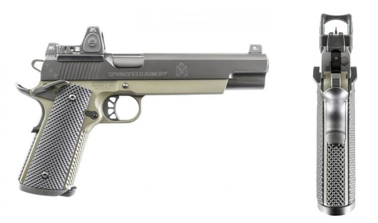

Springfield seems to have released a 10mm version of the trp operator with this trijicon rmr 2 as an option. the slide on the 10mm looks very similar in dimensions to the slide on my trp .45 operator
so Basically I am looking for how to get this on my .45.

The rear sight would have to be removed. There are dovetail mount plates that can be installed where the rear sight was but most don't consider that to be a very good solution. The other option is to have the slide milled for the red dot sight you want. The RMRcc is its own specification and not compatible with any other red dot sight. If it were milled for the RMR Type 2, you could find other sights that would work with that mount but given the width of the slide, I would go with either there RMRcc or the shield RMSc standard mount. There are a range of several red dot sights that use the RMSc mount. With some of the RMSc mount red dot sights they have a notch allowing them to be used as the rear metal sight and you existing front sight should the red dot fail. The RMRcc and some RMSc red dots are not notched and you would need to have a rear metal sight cut into the slide in front of or behind the Red Dot. It depends on the gun and whether those areas can be safely milled for that purpose.

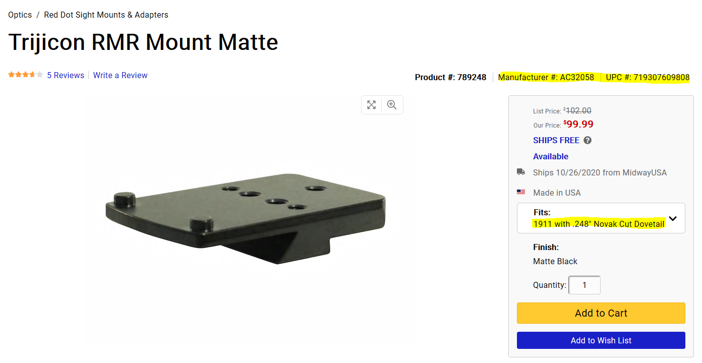

I'm looking for similar, I have a Springfield 1911A1 Government sized Range Operator. This is what I found {on Midway} for a Trijicon dovetailed RMR mount for 1911s … I have not confirmed if the dovetail cut is correct, though I would make a [bad] assumption it is the standard cut. Can someone from Springfield @Mike H. confirm if this mount works??? If not then what are the options to getting an RMR mounted onto a 1911?
