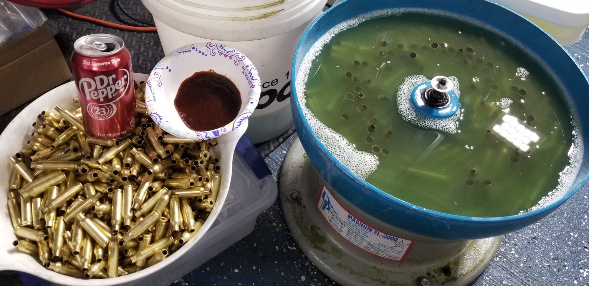

I’m a pepper....your a pepper......wouldn’t you like to be a pepper too..........For you Annihilator with a basket of fries and a soda on the side!View attachment 2941
