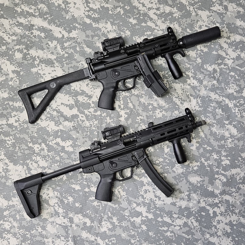

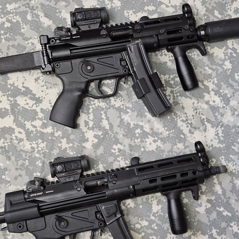

UTG for the win, the ultimate MP5 accessory
The rail for the MP5K came in yesterday - GREAT pair! (AP5 and AP5-P)
Not necessarily a "traditionalist" - as I think the lines on these UTG rails/handguards look great.
After looking and installing the K rail, I was thinking the A3 foregrip overhang was going to interfere with the suppressor. I was totally wrong on that - thankfully.
Oh.
That MP5kPDW configuration…
Well.
It makes sitting uncomfortable, and standing downright embarrassing.
I’ll be in my bunk, sir.
Yeah - I don't see myself ever running it with the mag coupler. That was just for pics to throw back to a different time.
Also the Choate is on there for the classic look. Considering going with a railed buttplate and swithing to a different folder......just haven't gotten that far yet.
I…
I actually LIKE the Choate. My buddy SBR’d his Zenith-k and it’s rock-on.
Then again, the first true machine gun I fired was a SP5kPDW, and I’ve got a very soft spot for them.
(And it had the legit B&T can on it, too…)

Few days ago I bought HK SP5 and SP5K PDW. I bought UTG PRO monolithic for both as well.
First I tried utg handguard with SP5, simple installation, but the problem was the installation of my Eotech EXPS 2-0 and G33, both with Eotech QD lever. It looked like the height of the rail is unsufficient for locking the QD lever, the mechanism was biting to aluminium body of the utg pro handguard and it was impossible to lock eotech, it was still wiggling.
I need to say I had no problem with the same eotechs on my ar15, benelli M4S90 etc.
I tried my classy old Eotech 512 without QD lever on the utg and voila, no problem with that.
There is the answer from Leapers support:
The height on the shoulder of the mp5 handguard is a bit lower of a profile than the standard flat top m4.
I have heard of the g33 and exps specifically having a mount that goes a little lower than any other mount we have seen.
It is not your fault.
There are two workarounds,
  1. Using model MT-RSX7L 13 slot .75 inch riser
  1. The hard way, dremeling down the edge of the mp5 mount specifically to fit the lower edge of the exps and g33.
Leapers should describe this uncompatibility in the product text on their websites.
I hope it helps to others with the same "problem".
