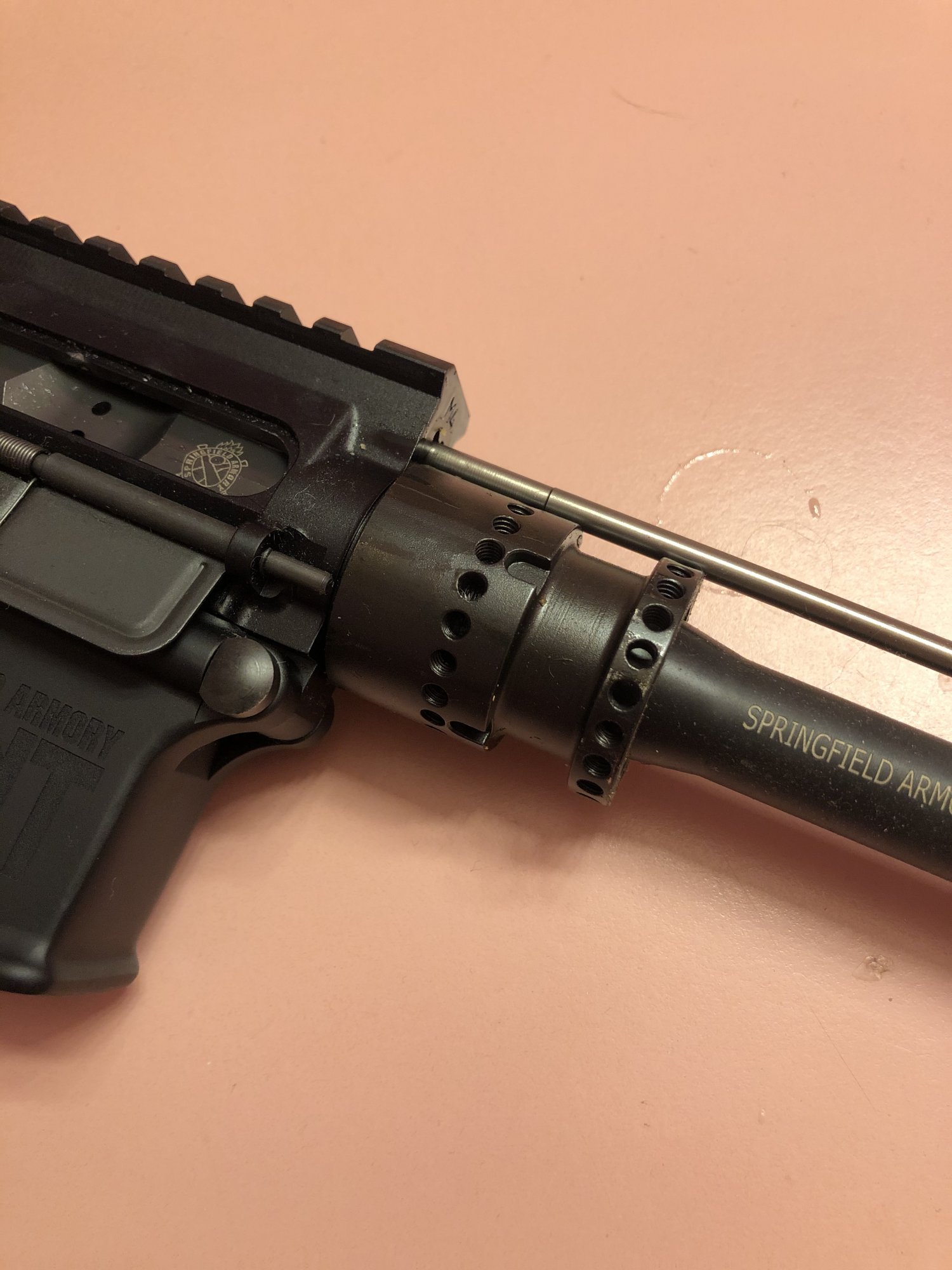

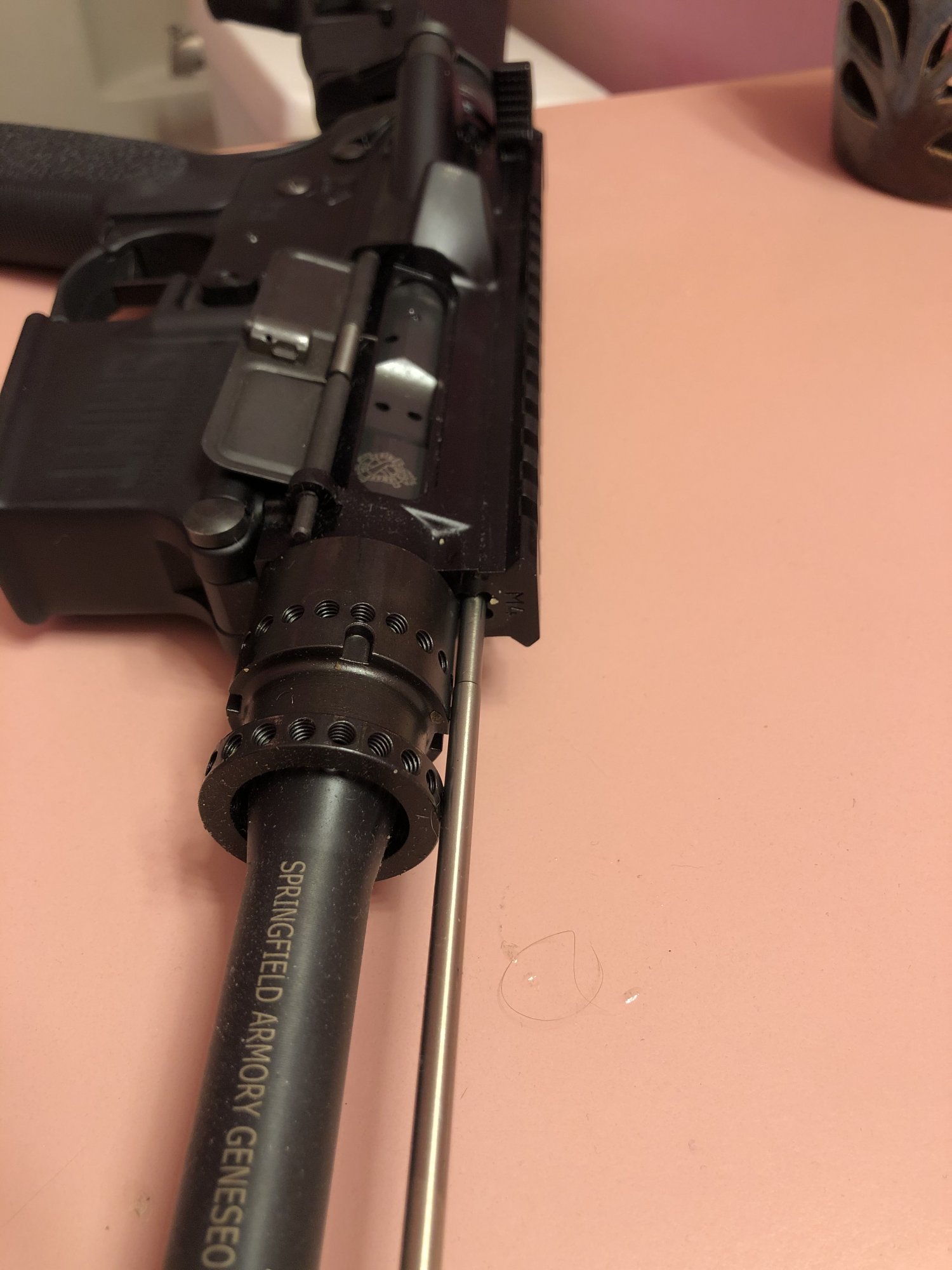

Here are a couple pics that show the hand guard alignment/concentricity issue. As noted on a previous post, this guard bolts to the barrel bolt. So in my mind, if the barrel nut is true and the holes are drilled right the guard would line up with the barrel. I don’t know if this has anything to do with the accuracy problem or not. Certainly couldn’t rule it out though.
An email won’t be read for awhile. Call them and explain to a CS Rep. and request an RA and send it back for SA to correct the issue.
