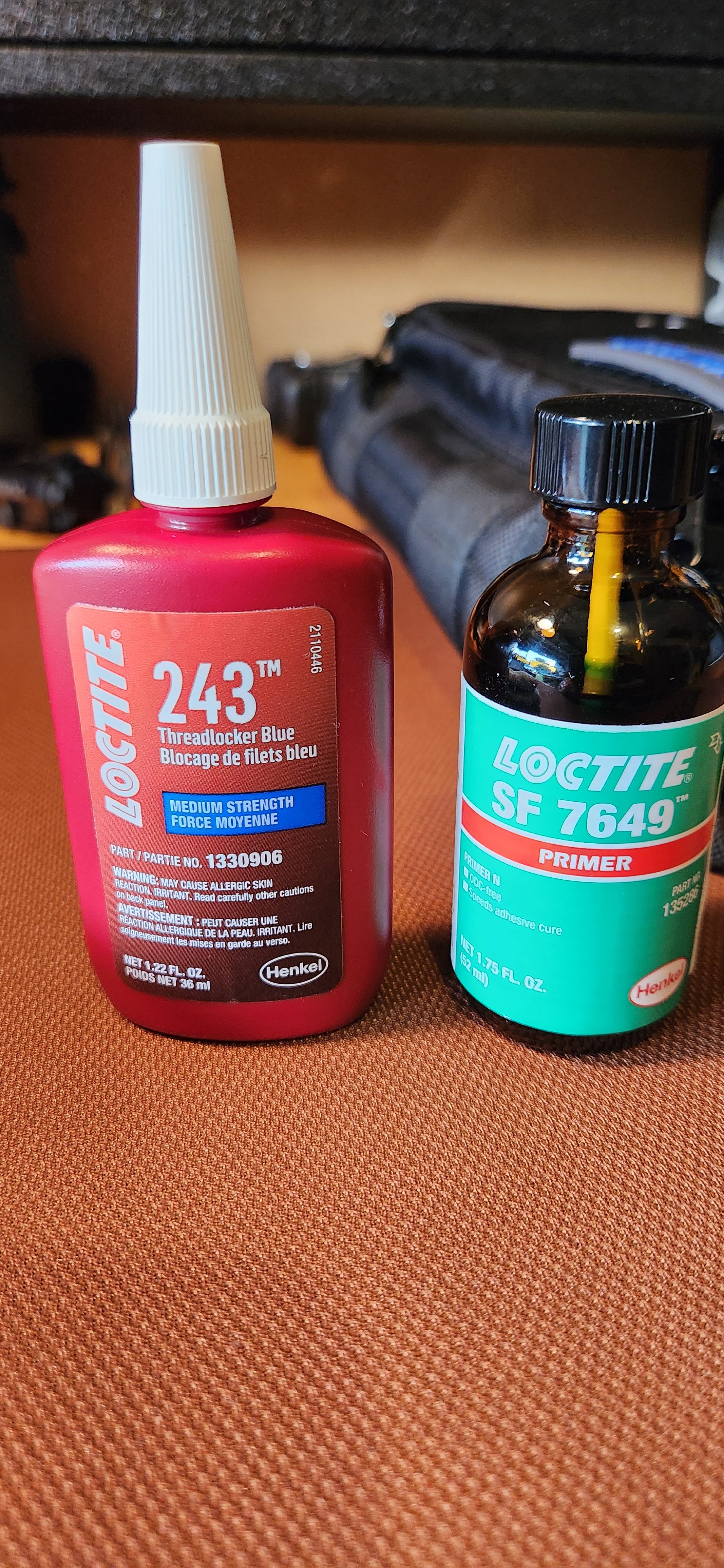

Just curious. Are you using blue loctite and a torque wrench to secure screws? I ask because I have an Emissary AOS supposed to arrive at LGS Monday and am crossing fingers all will be well!
Yes, as instructed by Tech at SA , I cleaned plate, slide, screws and screw holes with acetone. Applied loctite primer he said to use ($30.00 bottle, need two drops). Loctite 243 blue ( chemical resistant). Manual says torque to 25 in-lb. I went 20 in-lb due to screws being lubricated by loctite. Used wheeler FAT Wrench torque driver. Not trying to be a killjoy, just my experience so far. I hope yours is good to go.
Wow, 25 in-lb a lot. Glock MOS’ were 13 with SCS MOS. Same wrench I use. No killjoy suspected. I know there can be issues with any manufactured product.
