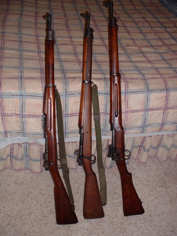

03 on the left, the middle one is an 03 A3, supposedly this gun was one the national guard carried when the integrated Central high in 1957. I done some research on it and what i came up with. but no real proof of it. either way i haven't shot it much. i did kill a deer with it many years ago. lol

Nice looking Model 1917 on the right. What's the barrel date on your 1903? Most of the 03-A3s were never issued and basicly became surplus the day after Japan surrendered. Is your 03-A3 a Remington or Smith-Corona?
I think it's a smith corona, that sounds right anyway. i haven't seen neither of them in years. lol they are in the back of a safe i don't open much. barrel date i have no clue.
