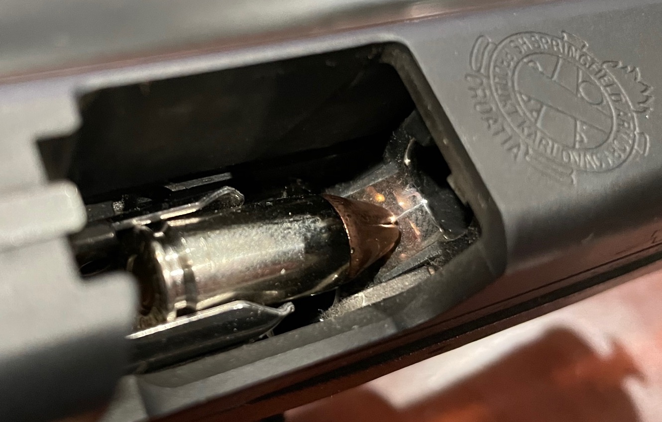

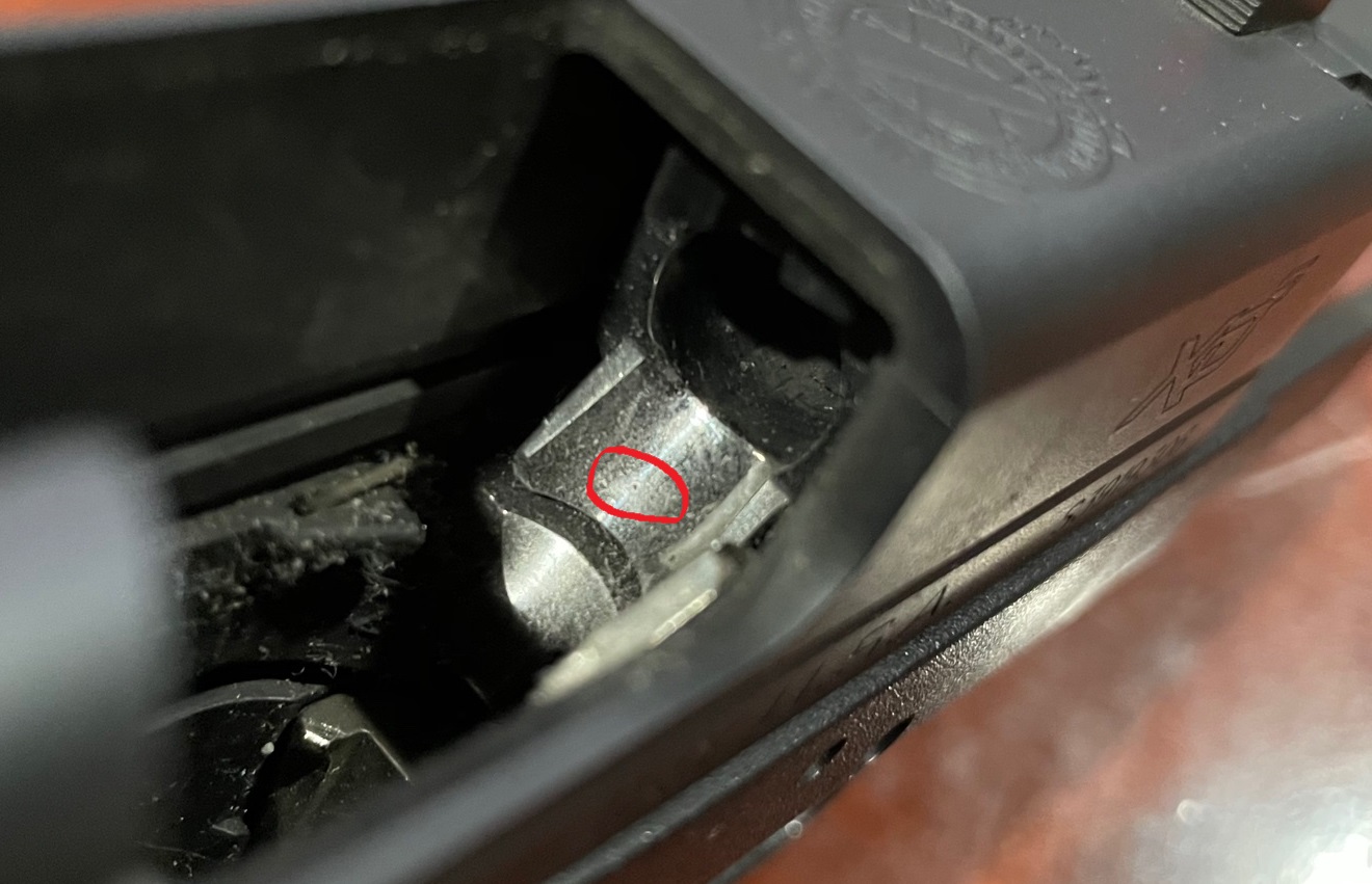

I have a 2013 XDS-9 3.3" barrel that since new has a pretty consistent malfunction. When inserting a mag and racking the slide to chamber the first round, the tip round gets wedged into the ramp entry to the barrel.
Anyone else experience this issue?

Does it do this with all rounds or just the ones like are in the picture? I may be wrong but it looks like you are trying to chamber the Hornady round with polemer tip. Some guns just don't get along with certain ammo.

Yes sir you are correct its a Hornaday round with polymer tip. I've had the same issue occur at the range with Federal or PMC FMJ training rounds.

It is unusual for FMJ to cause a problem but not unheard of. After loading a mag do you smack the back of the mag against your palm or your shoe to make sure the shell is sitting in the lip of the magazine where it should be and all shells are seated?

I haven't tried anything special to get the rounds seated in the mag. I've paid particular attention to how the last exposed round sits in the neck of the mag before inserting. There are a couple items that seem unique to this firearm. If I insert a mag, load a round and then release the mag, the next round to be loaded is positioned 3 to 4 mm forward from its standard installed spot in the neck of the mag and it also at times seems the tip of the round makes contact on the mag channel as it comes out. Haven't had that experience with any other handgun.
After exhausting a mag or loading an empty weapon I've tried both the slide release to load, and hand actuated popping the slide back and releasing. The symptom doesn't seem to change.
The last two rounds in these mags are more difficult to load and position than other firearms. Hard to objectively tell if the mags are higher sprung than my other manufacturers hand guns. I need to do a better job on narrowing the issue as I believe but not entirely certain I've noted the issue on both the standard 7 round and larger 9 round mag. I'll also do some testing on a half loaded mag and see if I can repeat the issue.
I did disassemble, clean and lube the slider and the slider rails including the barrel ramp where the tip is getting stuck. Full mag load, using slide release to load, no issue currently. I've done this seven times now without issue. At the range it was about a 35% the load or get stuck. Mind you previous I've never lubed the barrel ramp.

Joe, try loading a magazine and let it set for a few days to help relax the mags spring, hopefully this may help some, I know on my S&W shield, I had to to the same thing I posted here cause the spring was way to firm, anyway, hope you and SA can get this figured out.

Are you using a wet lube/oil inside the mag? If so, that can cause issues...the oil gums up from residue quite quickly.
Get a dry film lube for magazines.
My XDs mags load exceedingly easily, last round goes in just as easily as the first, and that's on both the 7 and 8 rounders (9mm). I did stop using the polymer-tip Critical Duty ammo because of an occasional feed issue. I've been using Federal Guard Dog JHPs and have no issues with them, nor with my standard FMJ range ammo, no matter how fast I run a mag through the gun.
I would - as noted above - try some different ammo and perhaps give your feed ramp a good clean and polish. Also, next time you disassemble, place just the barrel (no slide) onto the frame and see how the feed ramp on the barrel, lines up with the one on the frame. It should be a seamless ramp, with no lip or notch.

On my pistols once I chamber a round and drop my mag the next round will be out of position from how I/you loaded the mag. It’s normal. As the folks above posted good points try those. You said you are a type of handy man, it wouldn’t hurt to polish the feed ramp. It’s has been somewhat of an issue with the Hornady “Flex Tip” a synthetic insert. Try polishing the feed ramp. As Hans said he sure you don’t “ride the slide” when chambering a round. Rack it and let it go on its own power. Like Annihilator said, with new mags load em up and let em sit for a few days. I know you said you shot PMC through it with similar issues? If you do all that and still have issues I’d call SA customer service. YouTube polishing feed ramp.
