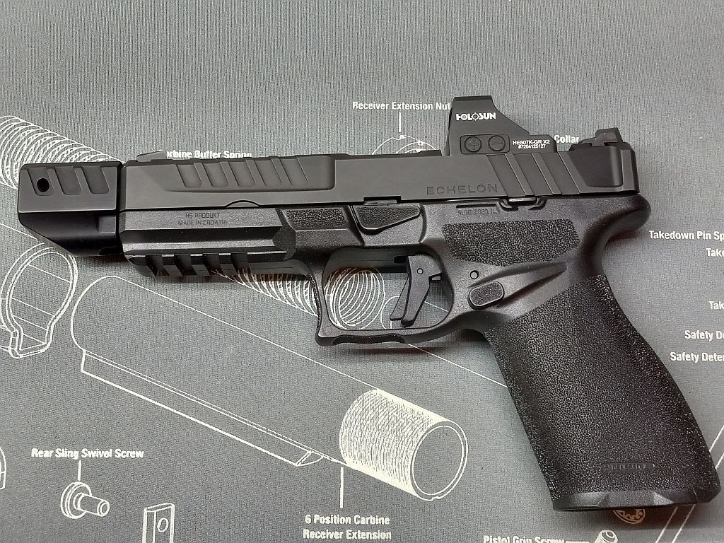

I comped my Echelon with a Springer Precision compensator and started having some FTE issues with several bullet weights I had no previous problems with. All of the ammo was PMC Bronze.

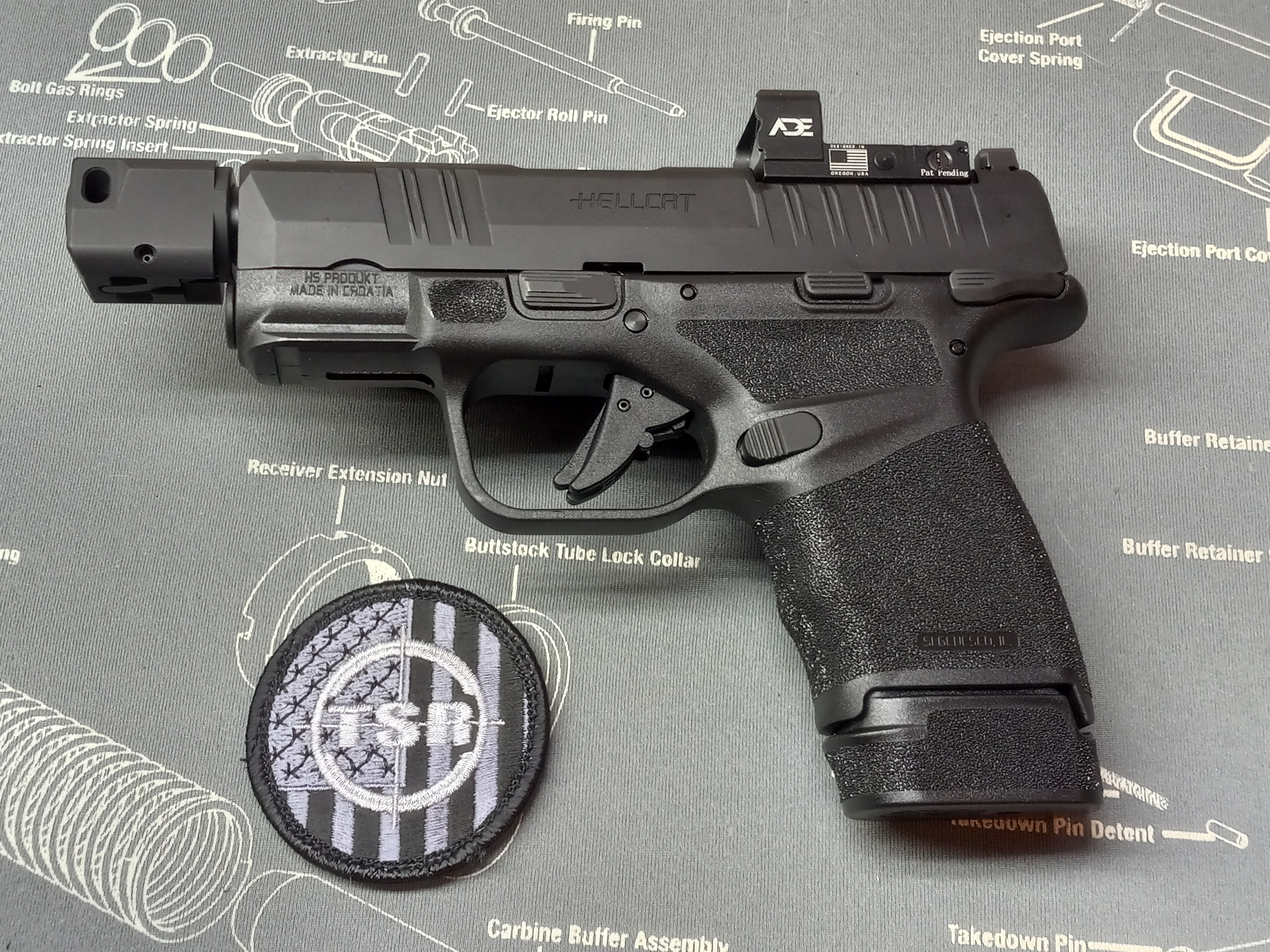

I also own a Hellcat RDP which comes from the factory with a compensator. No FTE issues at all. This led me to believe that I needed to look into the Echelon's recoil spring at the very least.
After some cussin' and discussin' with the folks at Springer, I purchased recoil spring (14lb) and a guide rod upgrade from them. The upgrades did the trick for the Echelon.
While I understand some ammo suppliers produce some hotter loads than others, you can't rely on that to be consistent across brands. So, once you've settled on a brand, a bullet weight and a compensator, don't forget to address that recoil spring and possibly your guide rod.
