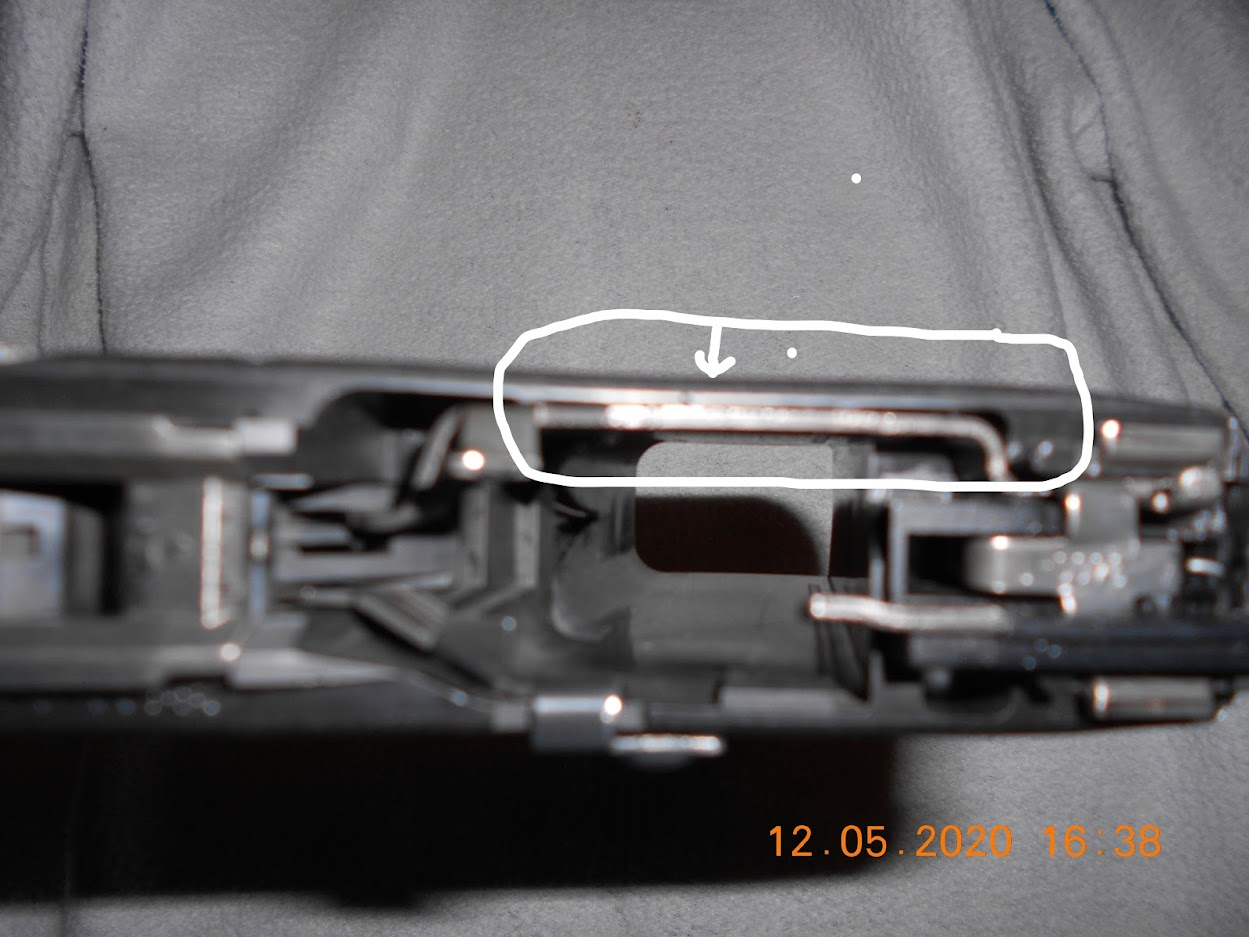

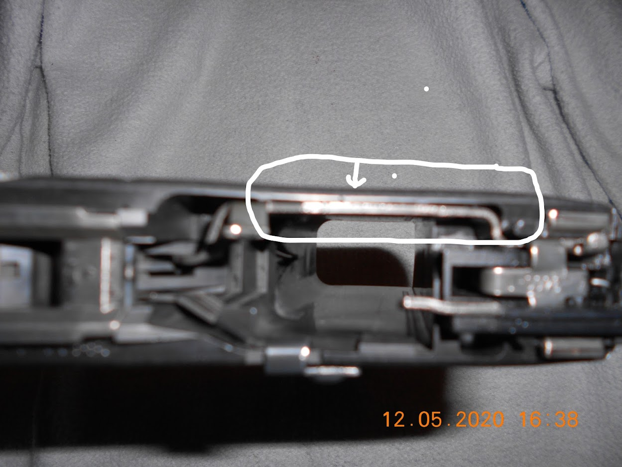

as you say, nothing is perfect. well this G-17 that i shot yesterday, and posted those targets? had a problem that i solved, and mind you, that i was a new shooter, new gun owner, and didn't really know squat about repairing them.
when i took this back then, new G-17 to the range, the trigger felt "heavy", so i thought it was just the way a new gun was. but after several trips to the range, it did not improve.
well in the picture below, you will see where the trigger bar rubbed up against a slightly "bent" frame..!!
i think what happened was that after the frame came out of the mold? maybe it rested on another frame? or it got moved around in some way that when it cooled? the frame was bent into the trigger bar.
now, i could have just sent it back to Glock, they may have given me a new one. but what i did was (and remember, i didn't know how to disassemble a gun other than field strip), i removed the trigger bar, then i slowly filed down the 3-4 "nubs" molded into the frame, that were tightly pressing on the trigger bar.
i re-assembled the gun, and viola, a much smoother easier trigger!
that started my need to learn more and more about gun tear downs and some "minor" gunsmithing.
it's a lousy picture, but it's a lousy old digital camera as well
but you WILL see the "bend" in the frame onto the trigger bar
