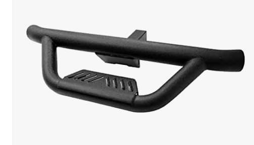

The one I had on the truck for about 4 years looked something like this.
It was functional and stylish however after backing into a concrete pole, the ones used to keep people from driving onto sidewalks, it didn’t look like that anymore. Basically I crushed it, now in all fairness when I removed it to put it in its final resting place “the dumpster” I found out that water had rusted out the bottom of the bump step rendering it useless.

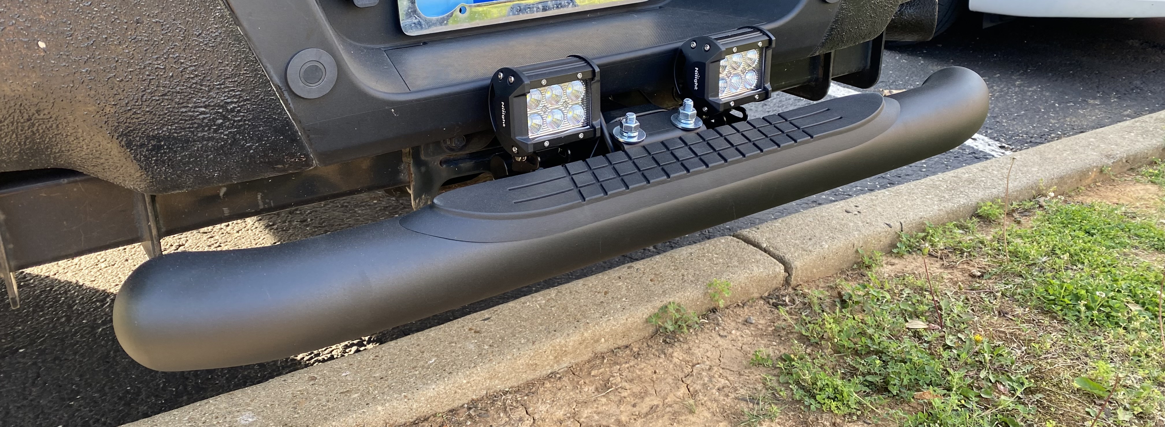

Of course I don’t do anything half way so I added something to its replacement, keep in mind everything I’m doing now is to setup the truck for 5th wheel camper towing so I won’t need the hitch now anyway so it’s locked on with a locking hitch pin and now it’s going to bright!!!
New bump step with twin pod lighting for backup help, it will not be tied into the trucks reverse lights so I’ll need run power. A project left for when I have nothing to do. 😂😂😂😂😂
