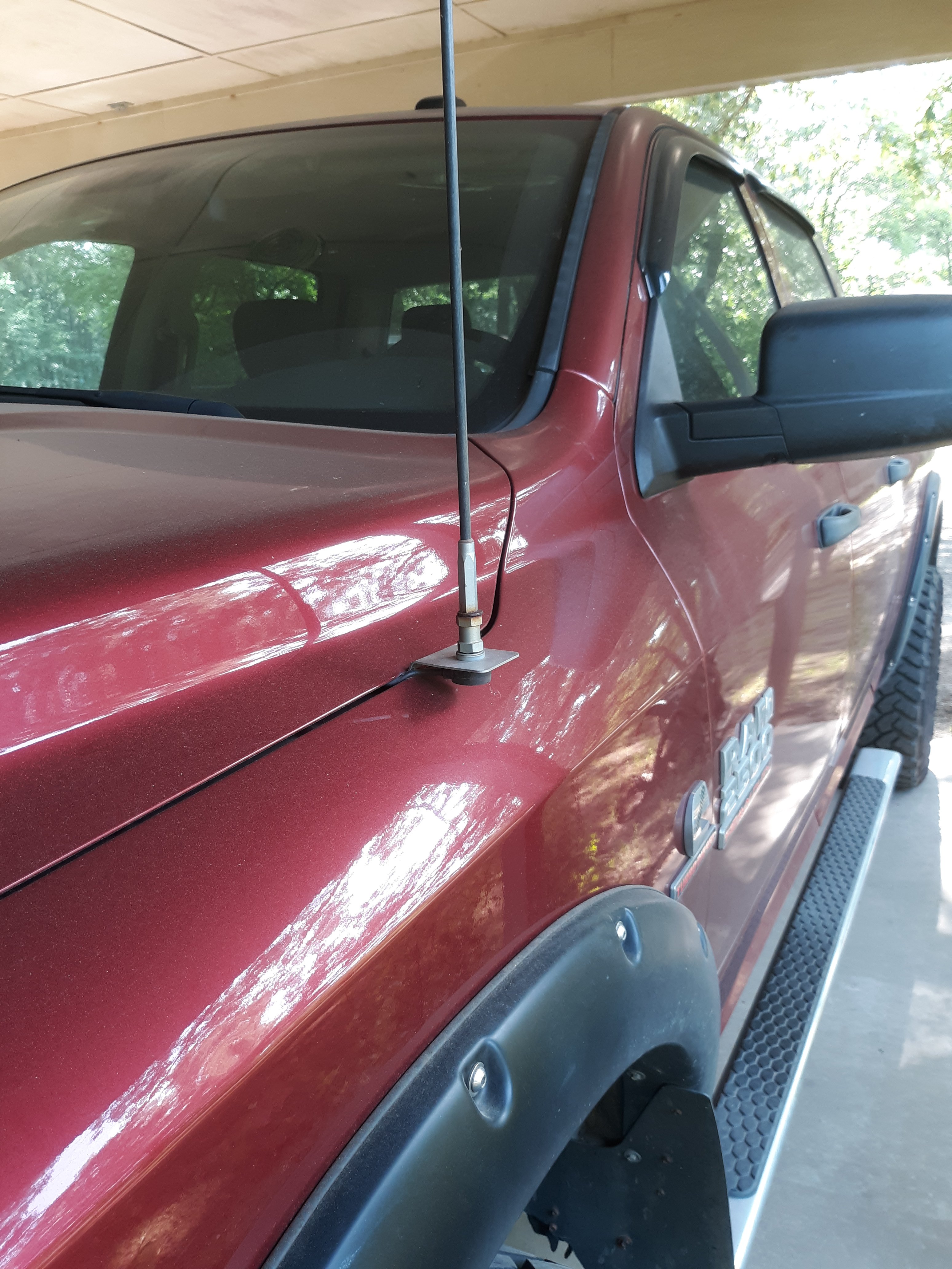

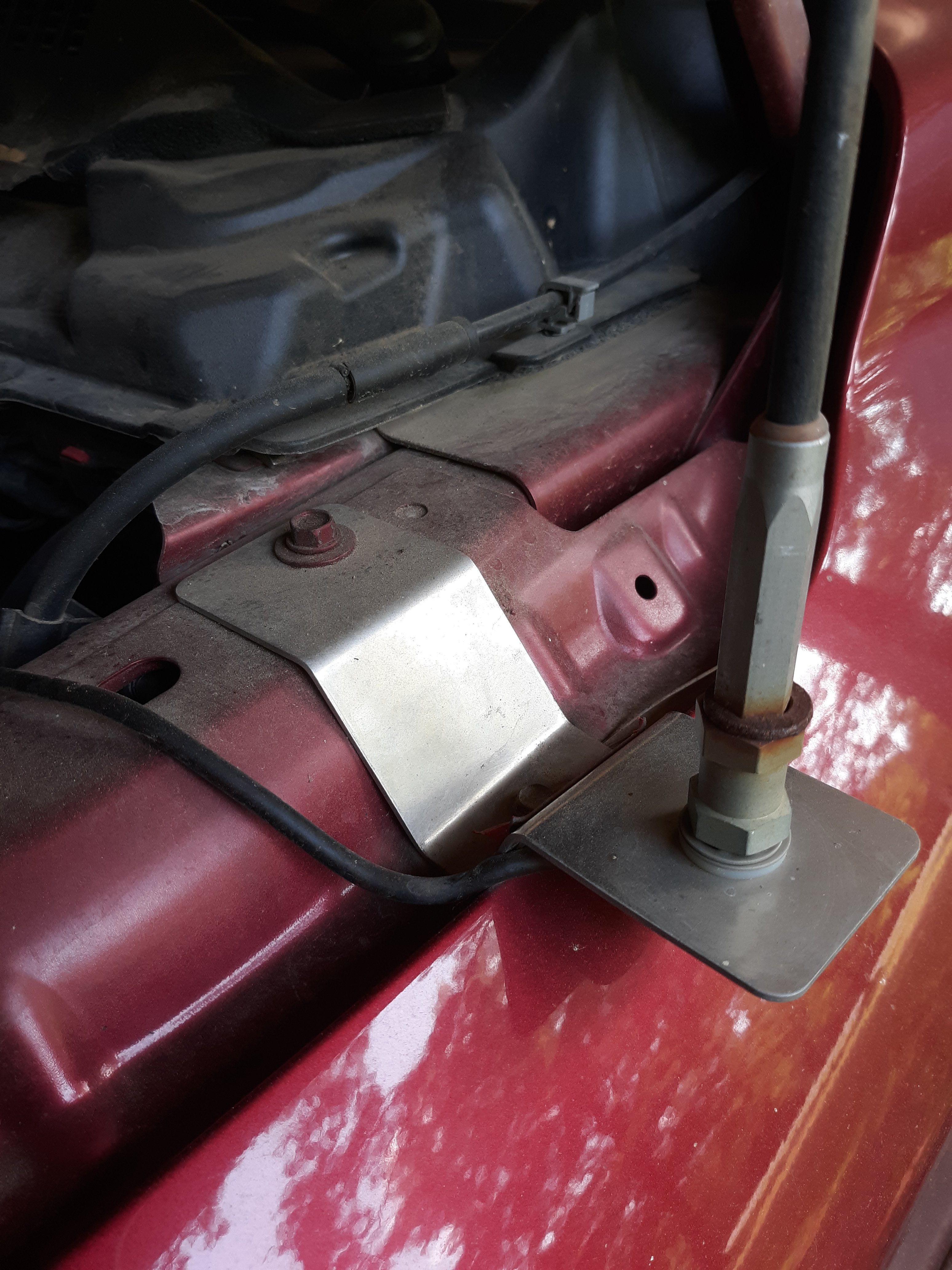

Got this one on mine, been working good for a long time now. got it at a truck stop. kinda rusted up a bit looks like. first i have looked close at it in a while.
