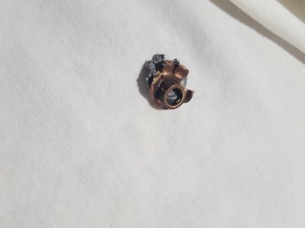

And some Blazer brass as well Monarch and others have issues with the jacket isn’t a real jacket and have seen for myself blazer pepper paper
Targets at 3 and 5 yards with particles from the bullet at Rangemaster Advance and Gon Givens pointed out it was an issue he sees in his classes with Blazer and other brands.
it does work but just stuff to be aware of. And like anything inspect your ammo no matter how match quality you get. Below is dusty ammo I found the we used on the range this was out of about 300,000 rounds in a 2 year period we shot up for qualification and training so it happens.
1 round no primer 2 with primer backwards and 1 9mm bullet loaded backwards looking like a wadcutter
