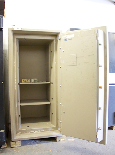

UL TRTL30X6 High Security Rating: Potentially insures up to $3 Million
Inside Dimensions(inches): 59” High x 19 5/8” Wide x 17 3/4” Deep
Outside Dimensions(inches): 73 5/8” High x 30 1/4” Wide x 32 7/8” Deep
Two Locks: High Security Combination Lock & High Security Key Lock
Cubic Feet: 11.9
Weight: 3,600 lbs.
This safe is made by the John Tann Company. I have one that is similar that I used when I was in the jewelry repair business before I closed up shop. So, I have a good understanding about the ins and outs of a high security safe. It's way too heavy to put in a house unless you're able to set it on reinforced concrete, and it's very expensive to move it. Often a small crane is needed to lift one like this off of a flatbed truck. The company that delivered mine broke the fork lift's hydraulic lines trying to set it off the truck, and it dropped about a foot. At that point we checked to make sure the glass plate behind the dial was intact and all parts were operational. As you see, the inside dimensions wouldn't allow for many long guns, but then a safe like this wasn't intended to secure guns per say. When you're looking for a gun safe the old saying, "you get what you pay for" really applies, and you need to balance what you have to protect to how much you need to spend to accomplice that. Equipment like this is at the extreme end, and the average gun owner wouldn't venture into this type of vault. If you are looking for a safe, do your homework, know which questions to ask, and buy a safe that gives you the security that fits your situation. I still own it but I'm letting a former business associate use it in the meantime. Now if I came by a dozen or more 1911 Singers then I might just have to change my mind and find a place for it at home. Another tidbit, notice the shelves inside. Mine came with several more. The owner of the company I purchased from suggested that at some point to have the shelves welded in place. I asked why and he responded that if we were robbed, it would be possible to lock an employee (or me) inside. If that happened and as a joke the bandits decided to hit the dial hard enough to break the glass plate behind it then the prospect of rescuing the person locked inside alive would be very small. Needless to say the shelves were soon welded in place. Here's some additional information if you're interested:
