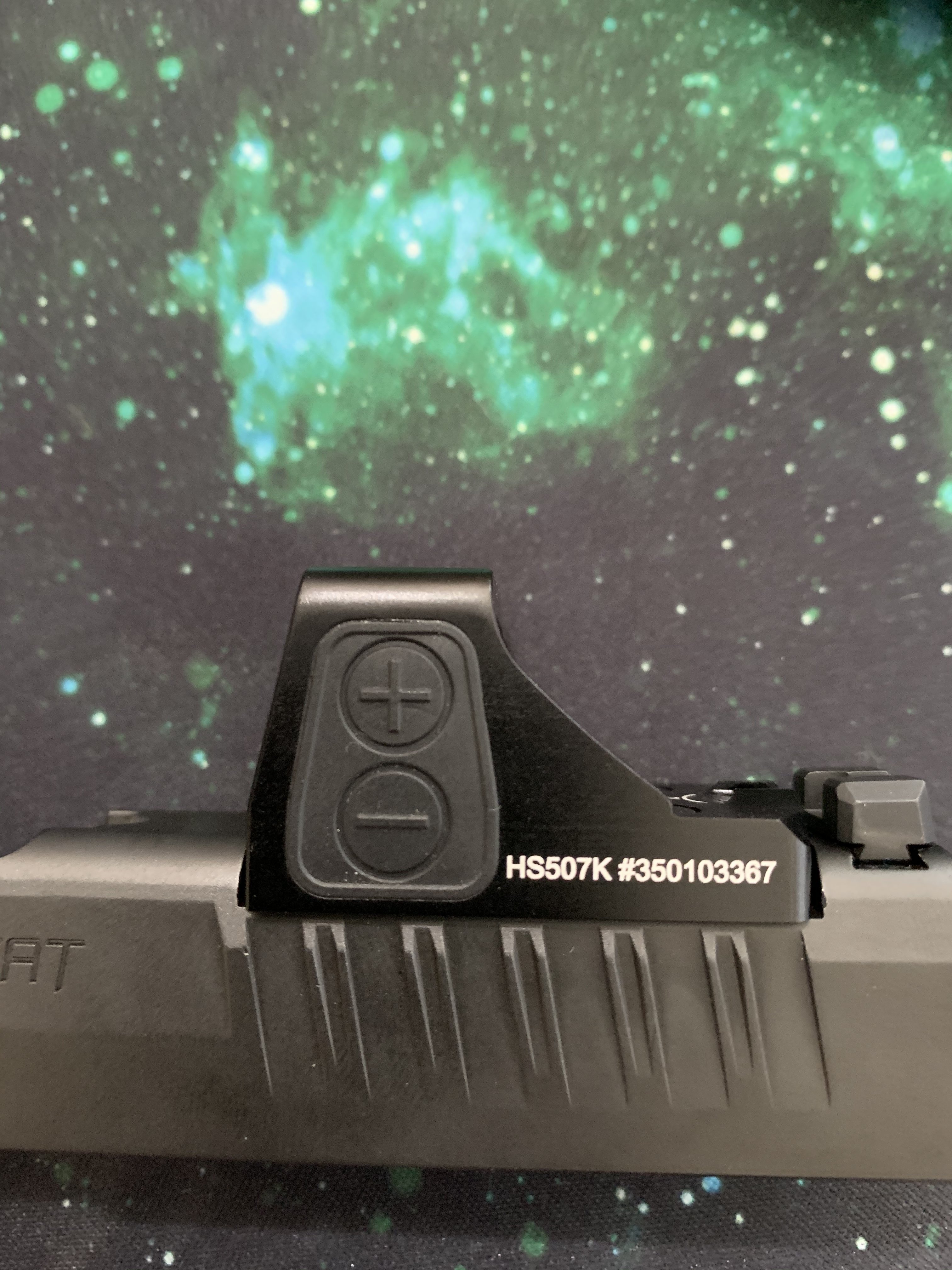

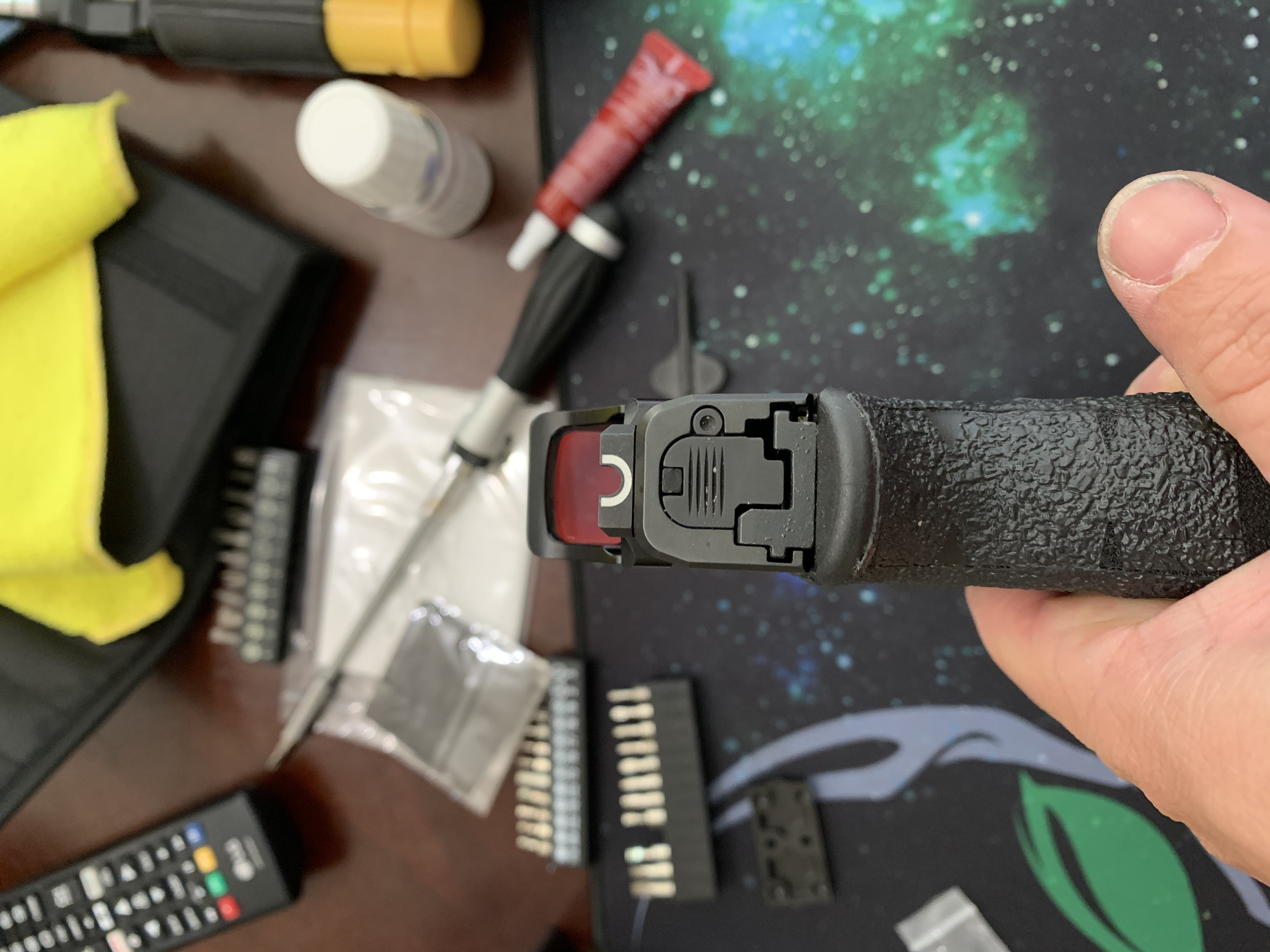

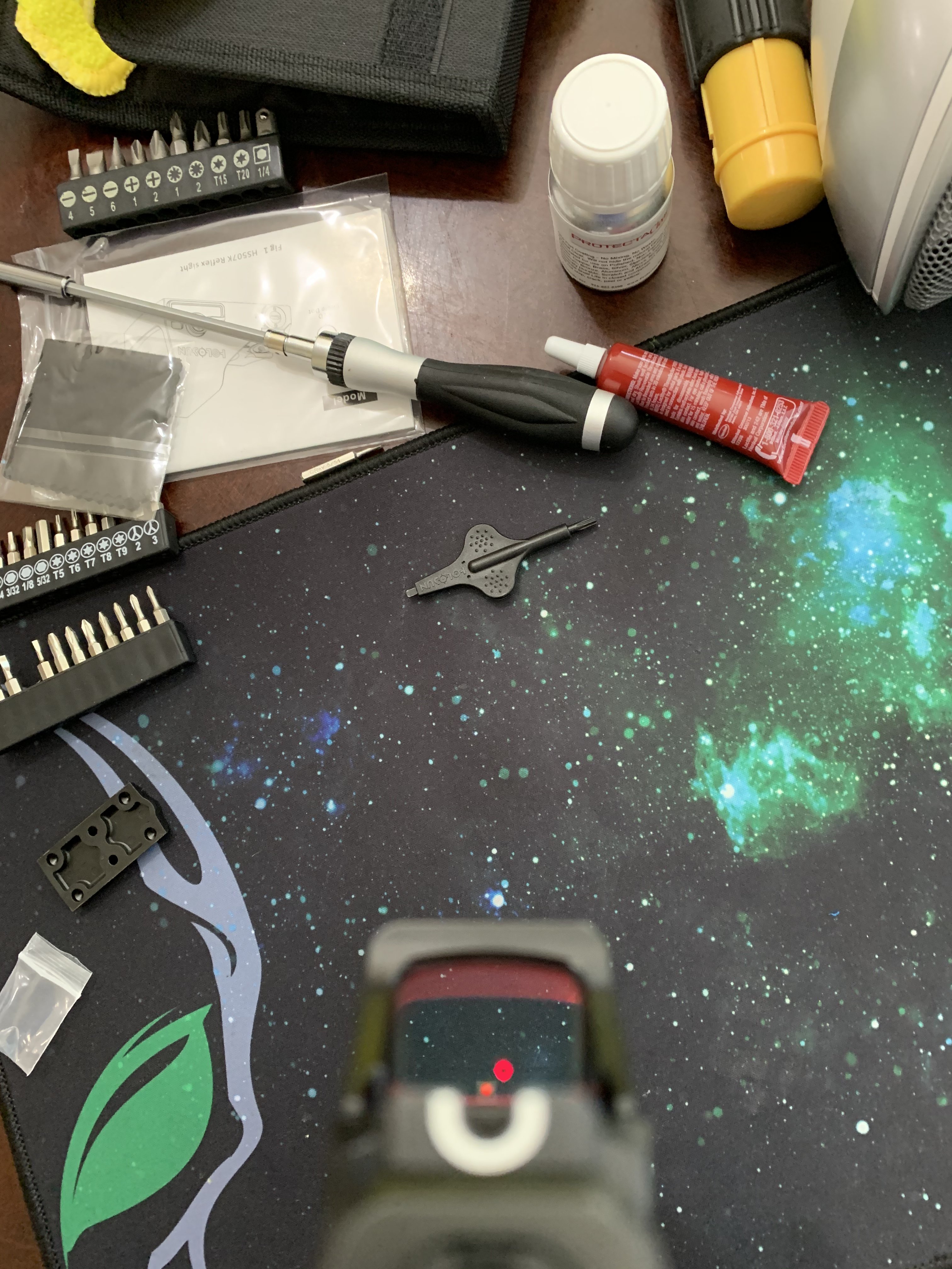

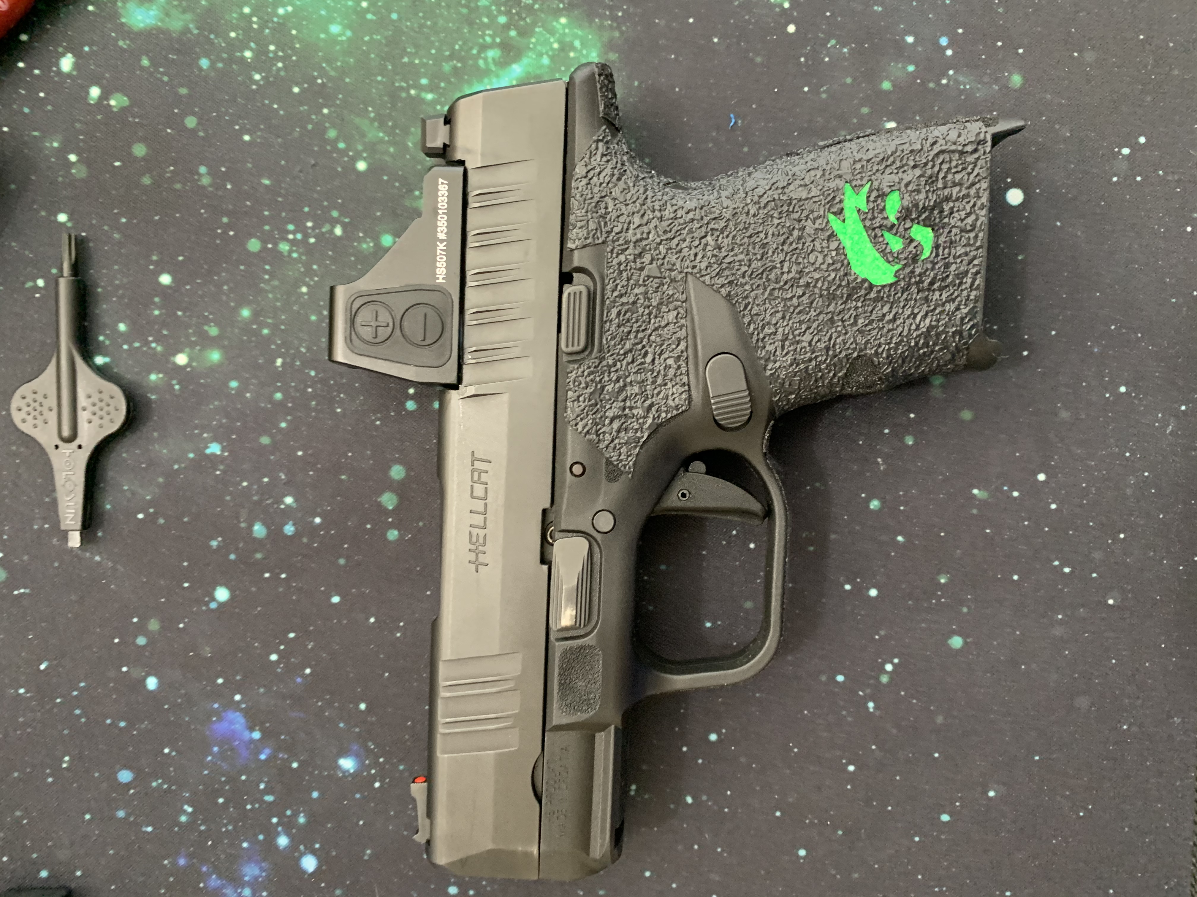

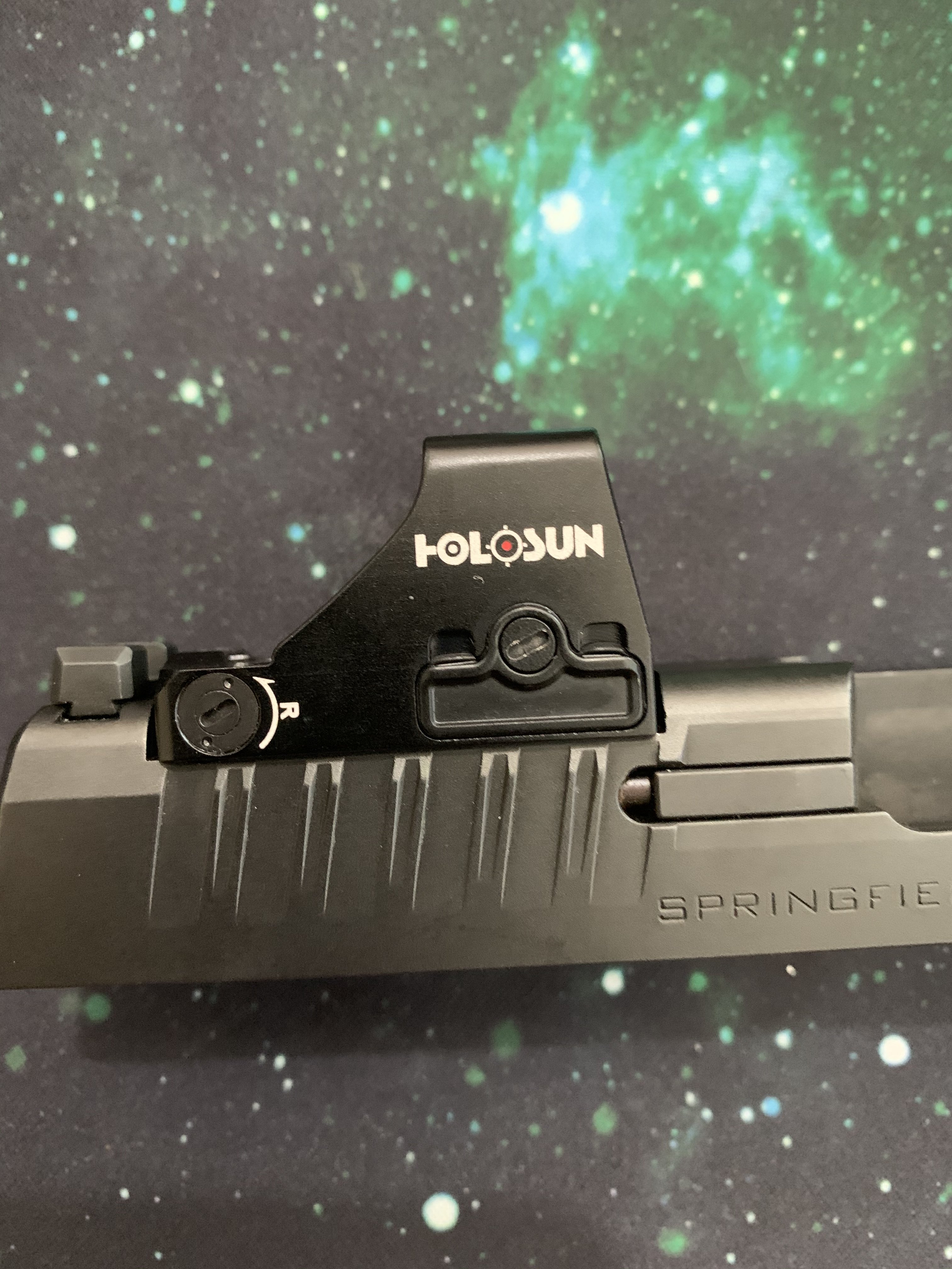

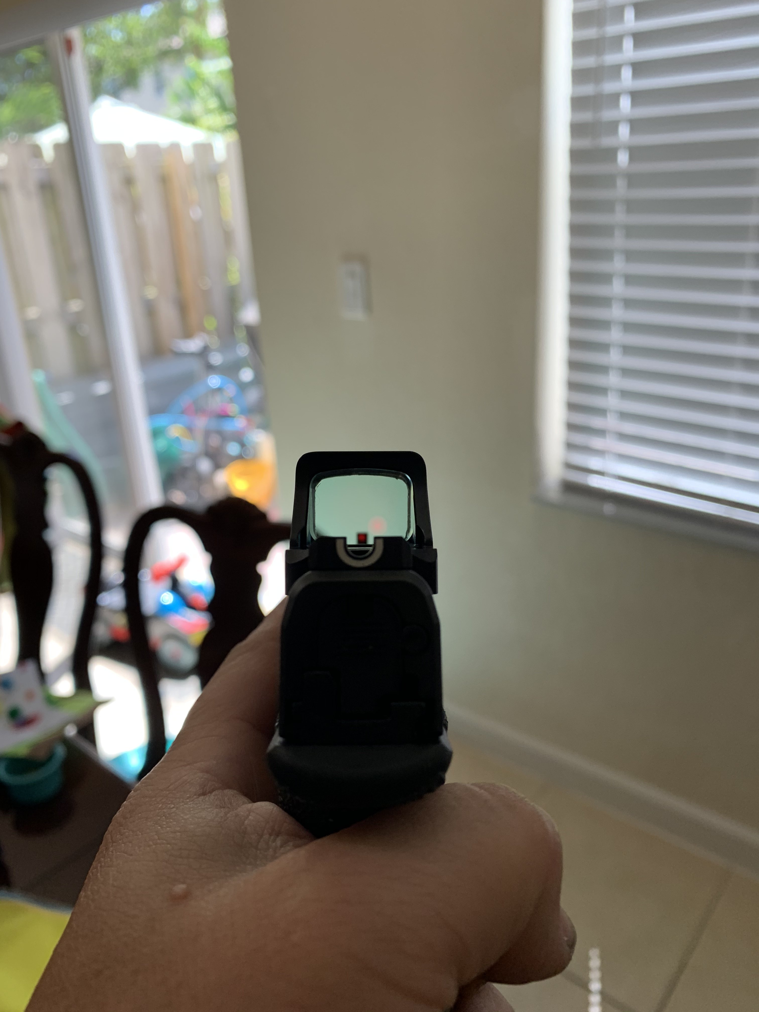

I just installed a 507k on my hellcat.
the work is simple to do. You need to cut the rear recoil lugs off and trim the front indexing lugs .5mm according to the email that holosun gave me with the layout. I took a dremel with a cut wheel, cut the rear lugs of flat, then little by little filed down the front lugs with the same cut wheel until the proper fit was achieved, then put two coats of a clear coat metal protector from amazon. installed it with the screws holosun provided. Sorry did not take a before photo of under the plate. Just need to zero it in now. Also new to this forum. I contacted holosun via email asking what modifications needed to be made. Holosun replies with in 24hours. Modifications took maybe 15minutes and used a hair dryer to speed up the drying process of the clear coat.
