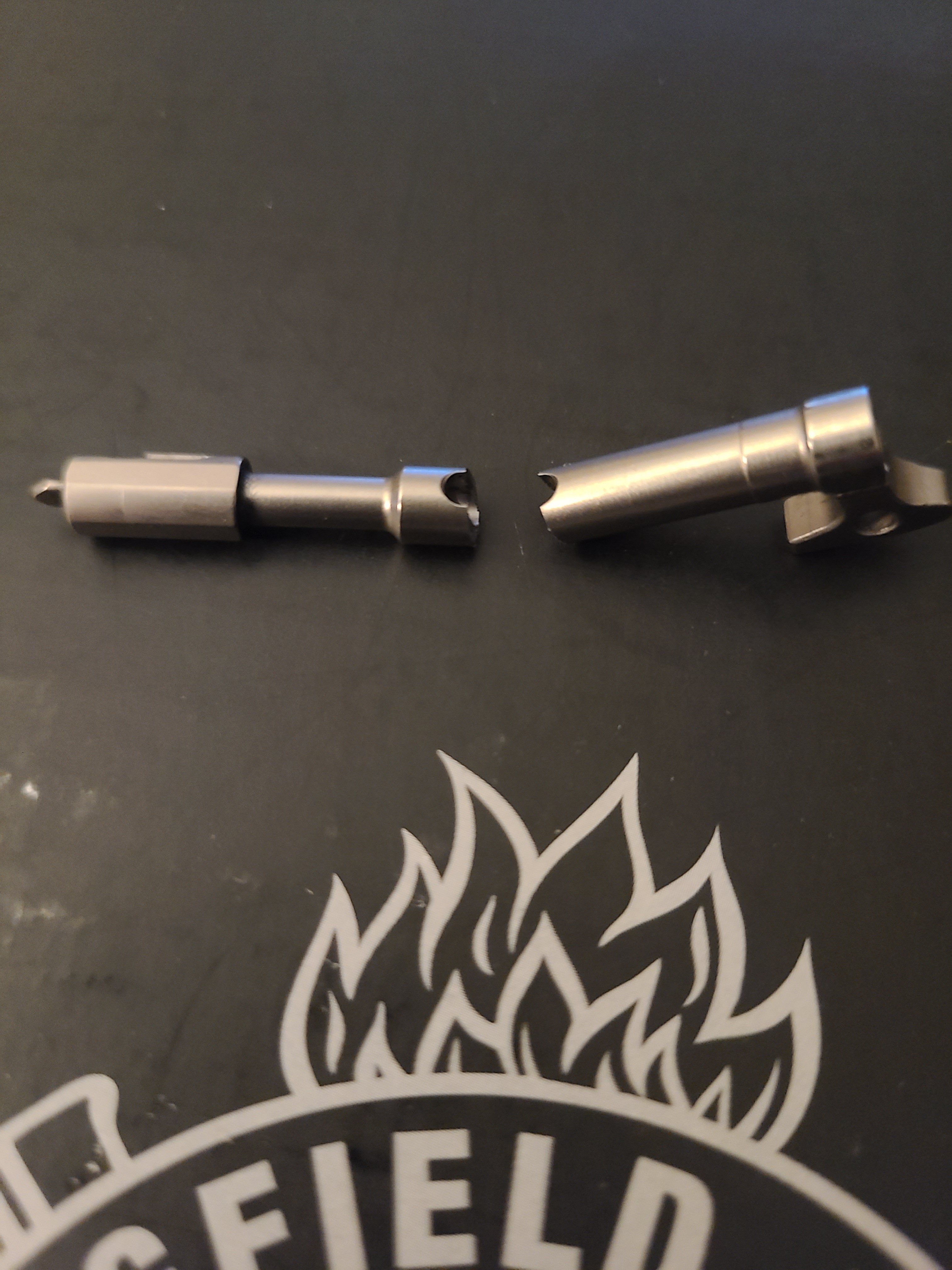

Hellcat Pro Broken
Operating something does cause wear, no matter how little, there is still wear and it adds up...
Advocates for dry firing, don't envision excessive dry firings when they say it isn't an issue... ...they would admit, its not wear free to dry fire, they simply deny the claims that dry firing is excessive wear on the pistol...
I've seen some point there are a few rim fire designs that will suffer excessive wear or damage on the pistol....
You're dry firing a striker pistol 50-75 times a day, while that is not as much stress and wear as actual shooting, it is still wear and as far as the striker is concerned its the same stress and wear, if not more....
So you've got several thousand rounds through the pistol and several times more than that in dry fires.... ....that's a lot of use on a pistol...
I wouldn't say that experience shows the Striker in the Hellcat is defective or poorly designed, but it does show its a weak point, and will likely fail and need replaced during the life of the pistol in heavy usage....
I agree with your decision to upgrade to a sturdier aftermarket striker after the 2nd one failed....
BTW, looking at the Hellcat Striker, the plastic collar appears to be just a spacer, cylindrical washer, for the spring to compress. Again, I think your experience shows, it could be better and it would be smart to upgrade for severe usage, but in most cases, its just there as a spacer for the spring...

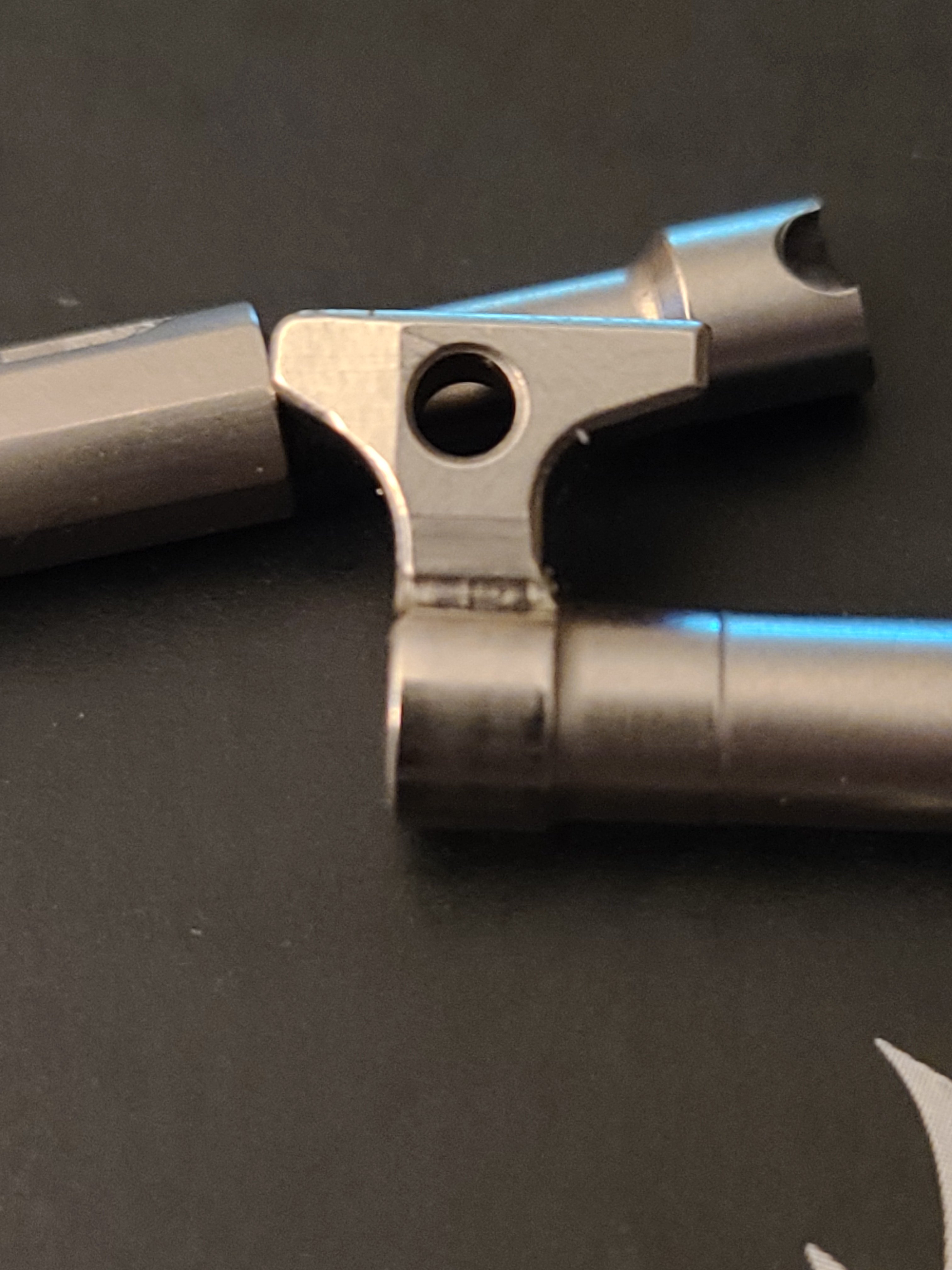

This is a shot of the part that broke, you can see the hole, from the manufacturer, creating a week spot. The second shot is where the usual break would occur. Even on this one you can see markings at the base of that hook. To me, none of it looks like hardened steel.
i check the replacement strikers from MCarbo (titanium) and Lightning Strike Products (steel).
and i swear, i see that hole in thier strikers as well....so i cannot see it making a difference if S/A has a hole and the others as well.....maybe the S/A is just a bad batch..????
MCarbo (titanium)
you can barely see it, but it is there
Lightning Strike (steel)
MCarbo (titanium)
Dang, I think you're right. Let's hope the type of medal makes the difference.
There is probably a reason for the hole and it has to be there. That doesn't necessarily make it weaker, but it will be the stress riser so that when it finally breaks, its going to break there. If they designed different so no hole was there, the striker could still break just a little later and in different spots...
The metal, its strength and final finishing steps can make a huge difference, stress relieving the hole can make a world of difference as well. So I wouldn't get to worked up about the hole.
With amount usage you're putting on this pistol, are you sure you don't want to order a 2nd one to have a spare on hand?
You read my mind. I have a second one coming also.
