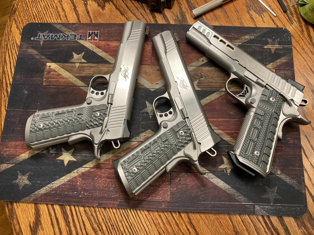

Now for the Springfields… I took a completely different direction with them. Springfield 1911s, at least the ones I own, give me a different feel when I pick one up vs Kimber. I don’t know how to describe it except it’s like walking into a tool shop and handling power tools. My Springfields remind me that feeling when you pick up that industrial grade tool vs maybe a “professional” grade. Less frill, more heavy duty, get it done, last forever feel.
With that, I left the finish exactly as they were and slapped some pewter novelty grips on them.

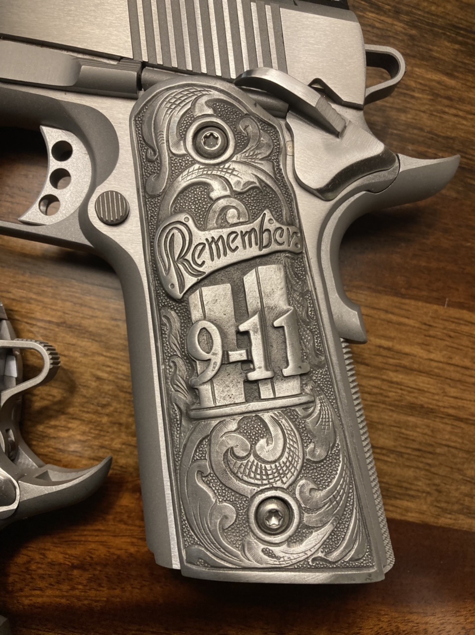

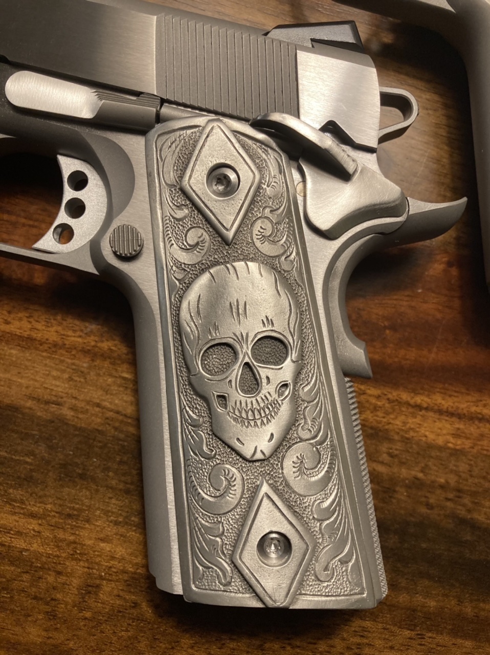

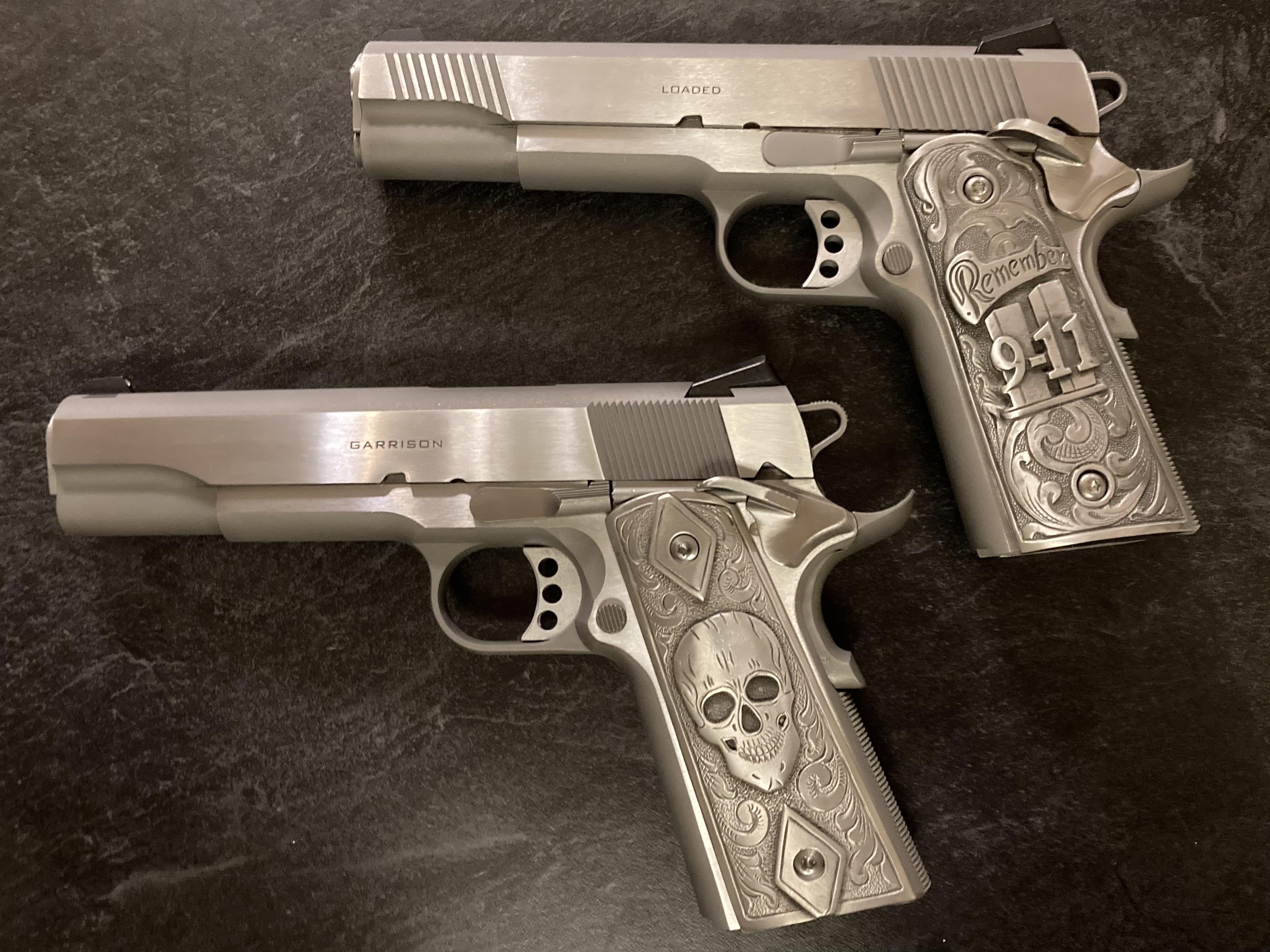

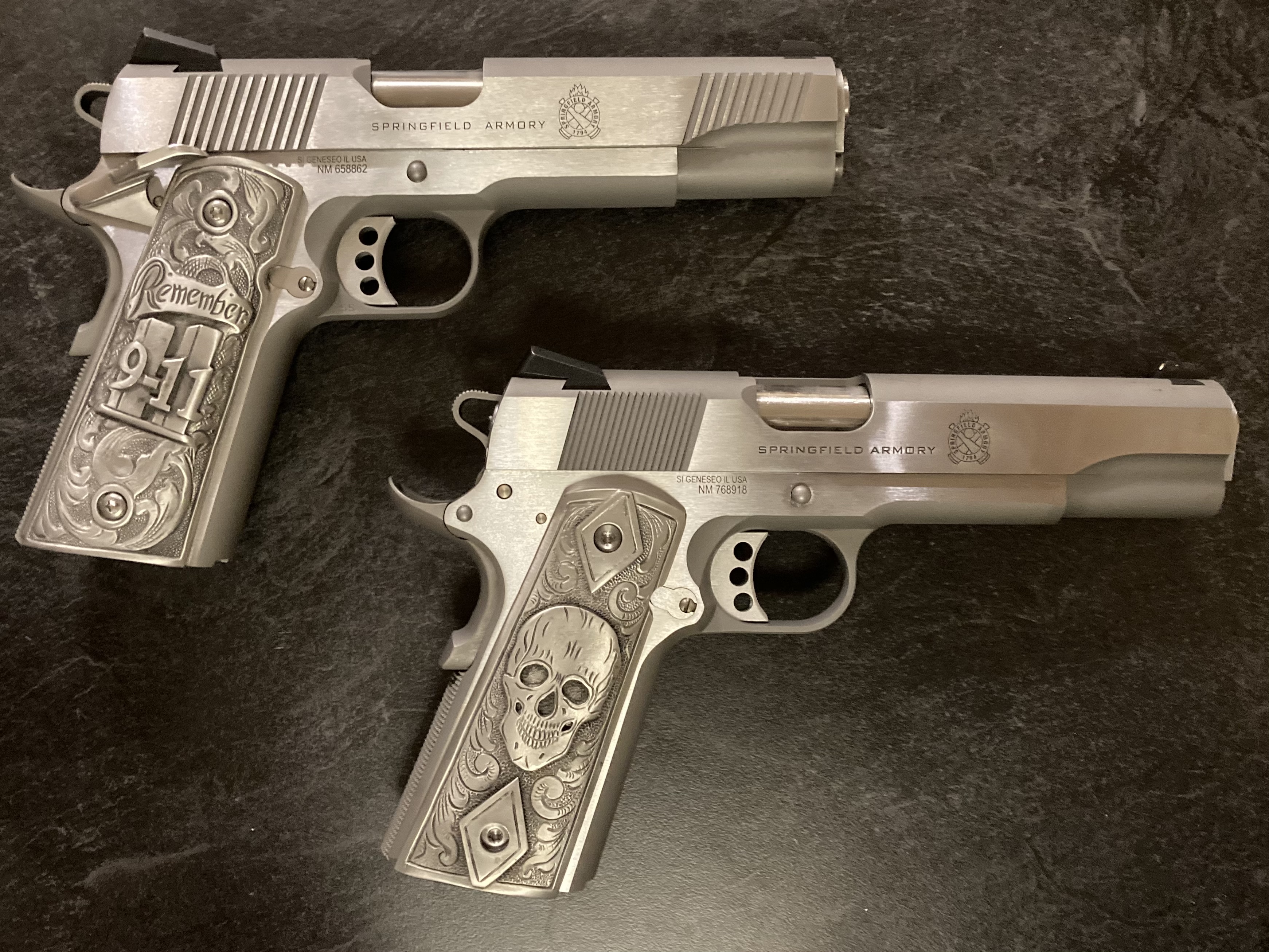

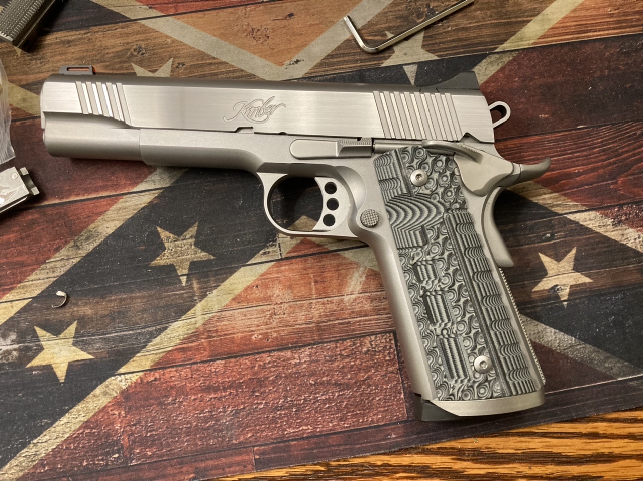

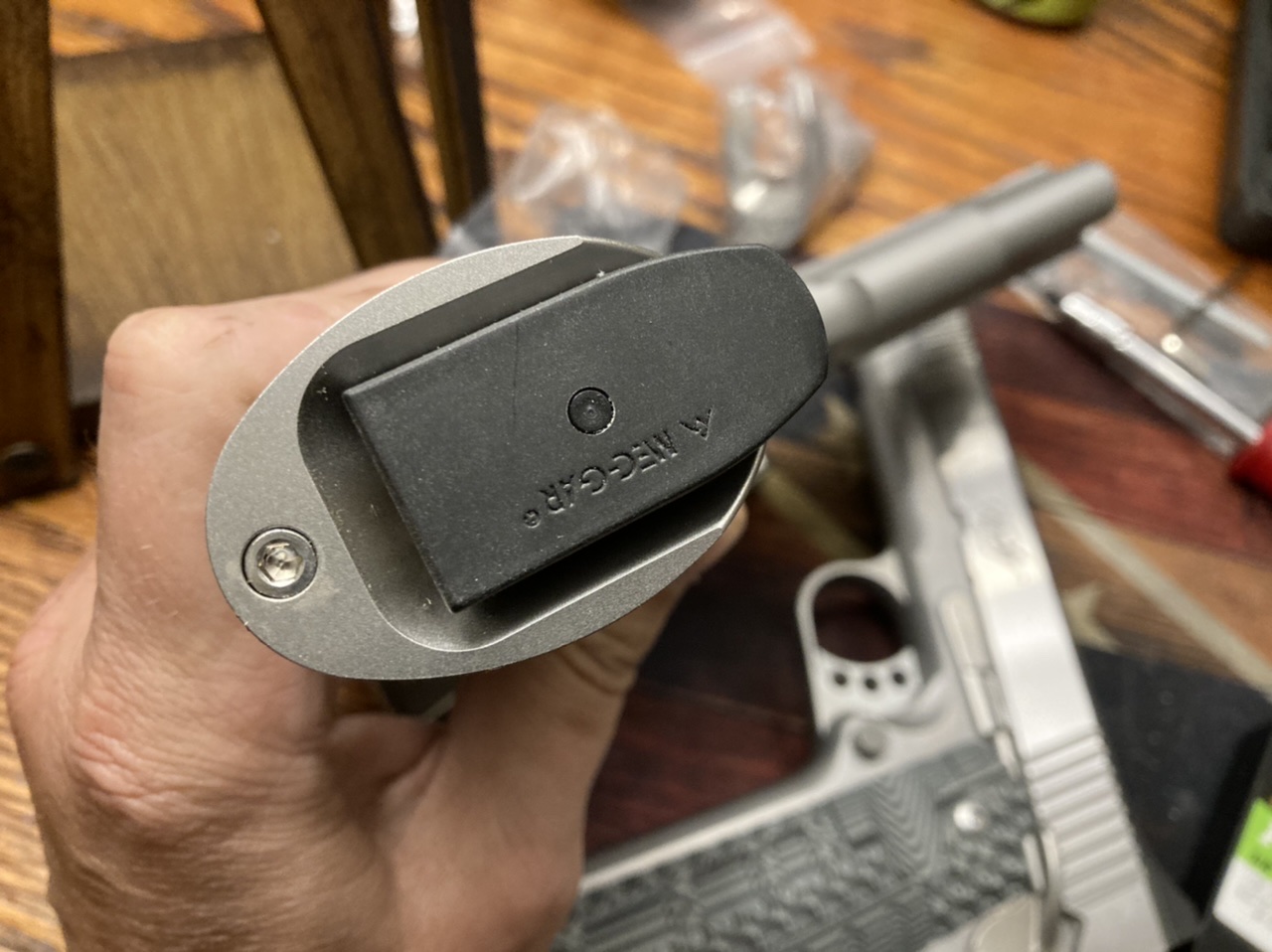

Actual pics of the grips I received. They need a little work but not a lot.

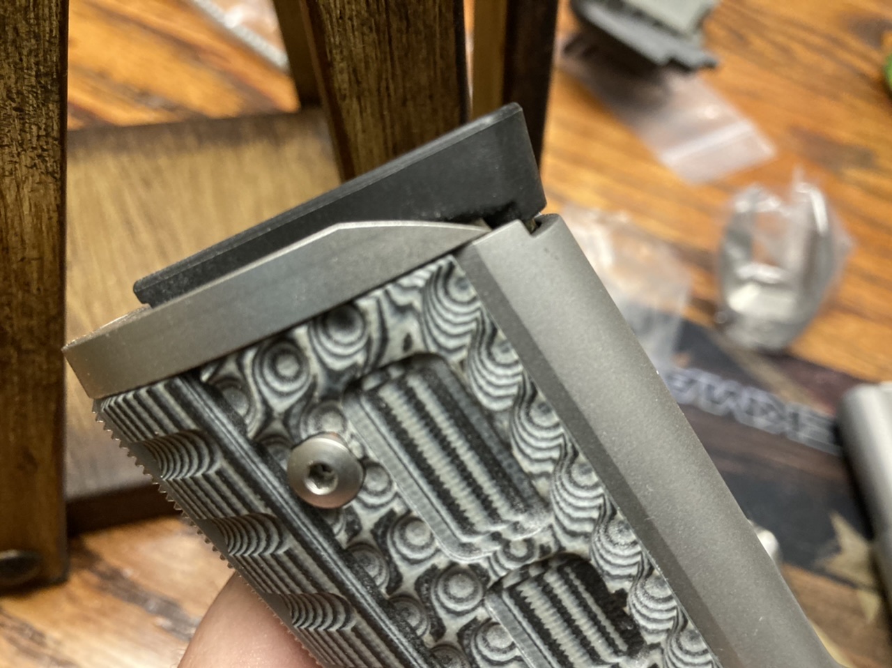

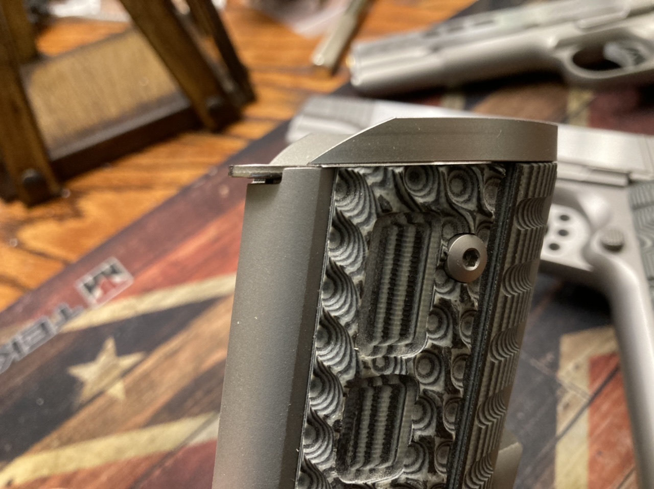

The thumb safety on the Garrison has a downward hook at the end that is contacting the grip (actually, all 3 thumb safeties do). Need to shave a touch off the top there.

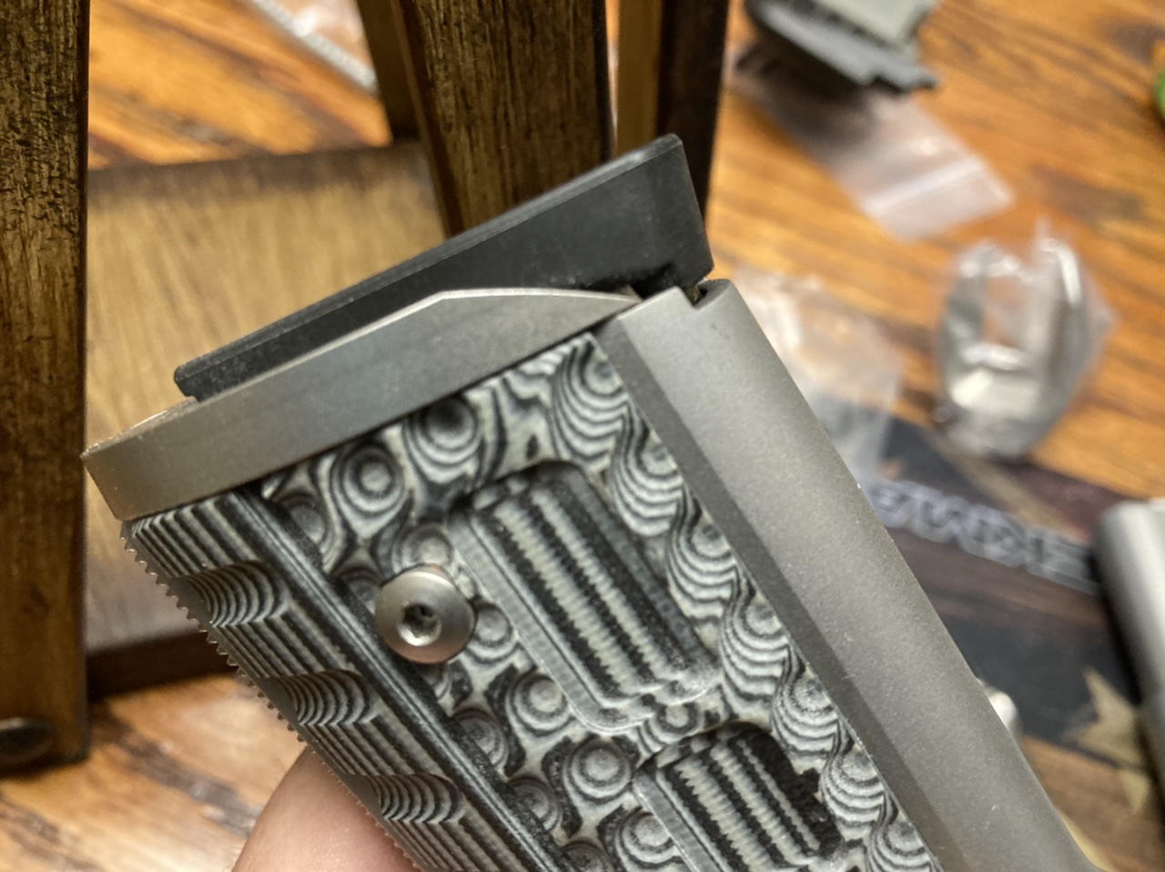

I think maybe thin grip bushings are needed on the Loaded. Doesn’t tighten enough, rattles a little. The Garrison has thin grip bushings, doesn’t have that problem.
Both grips, the mag release relief on the right side isn’t exactly in the right spot. Can’t push the mag release in. I will have to relieve that area just a little. They are just slightly under the grip.
Wife likes them. I think I do too. I don’t think the 9-11 grips look as good on the Garrison as the Skulls do. The Loaded has a more complex look. I’ll need another set for the 9mm Garrison when it comes back. I wanted a set of the 2nd Amendment grips but I can only find a damaged set on eBay.
