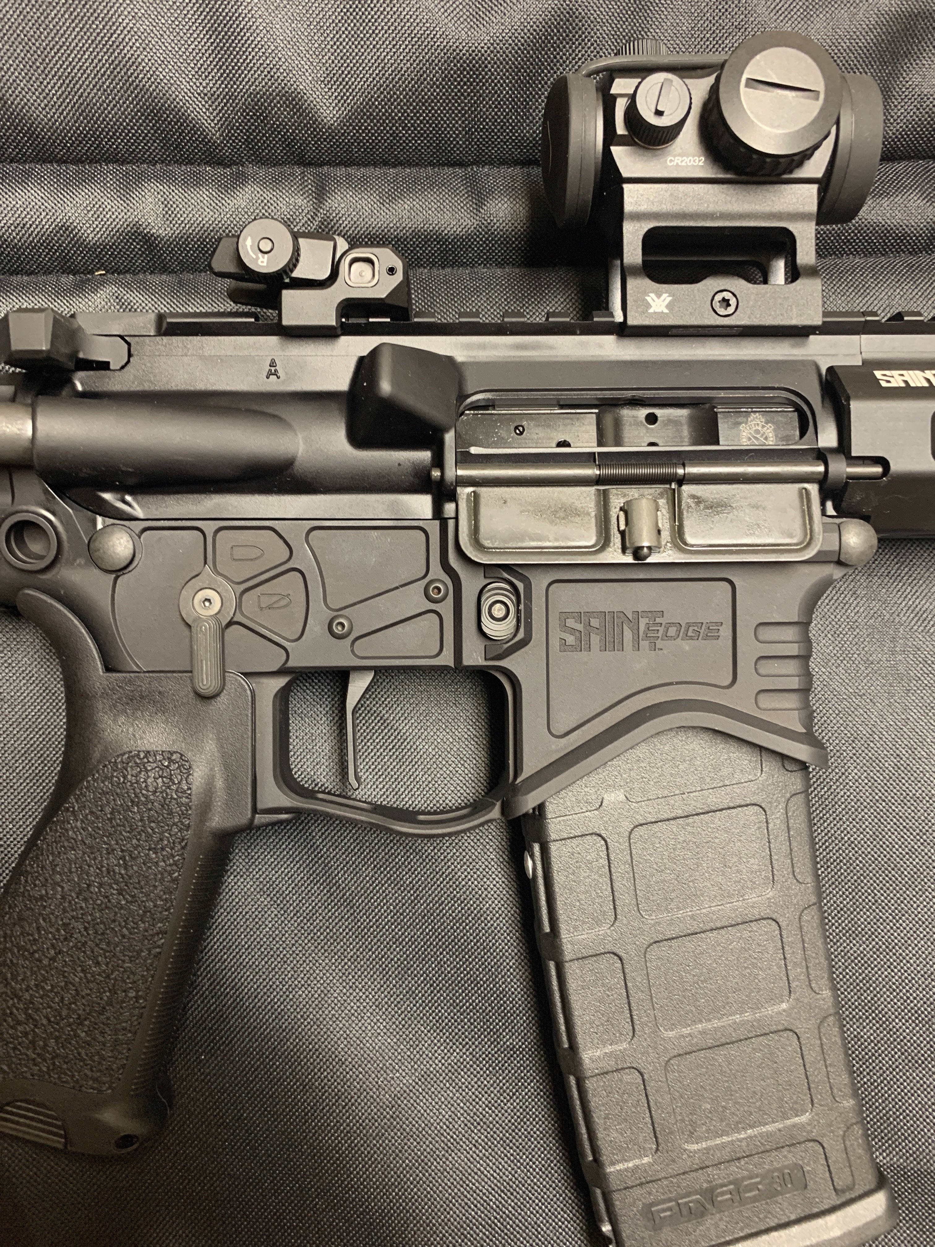

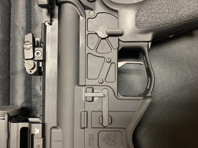

No. It just doesn’t push in at all.. like something stopping it. When I take the upper off it then will depress
It looks like the bolt release is interfering with the mag release. The bolt release looks all sorts of wrong.
I would contact SA and have them look at it. Hate saying that since I have always had good luck with SA products, but they messed something up on that one.
When the upper is down all the way.. the bolt release is interfering with the release it’s not allowing it to push all the way. So when I take the pin out and life a little that is why it is able to push.. just wasn’t sure if I was missing something
