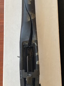

Unfortunately not the best news, but just wanted to report this incident.

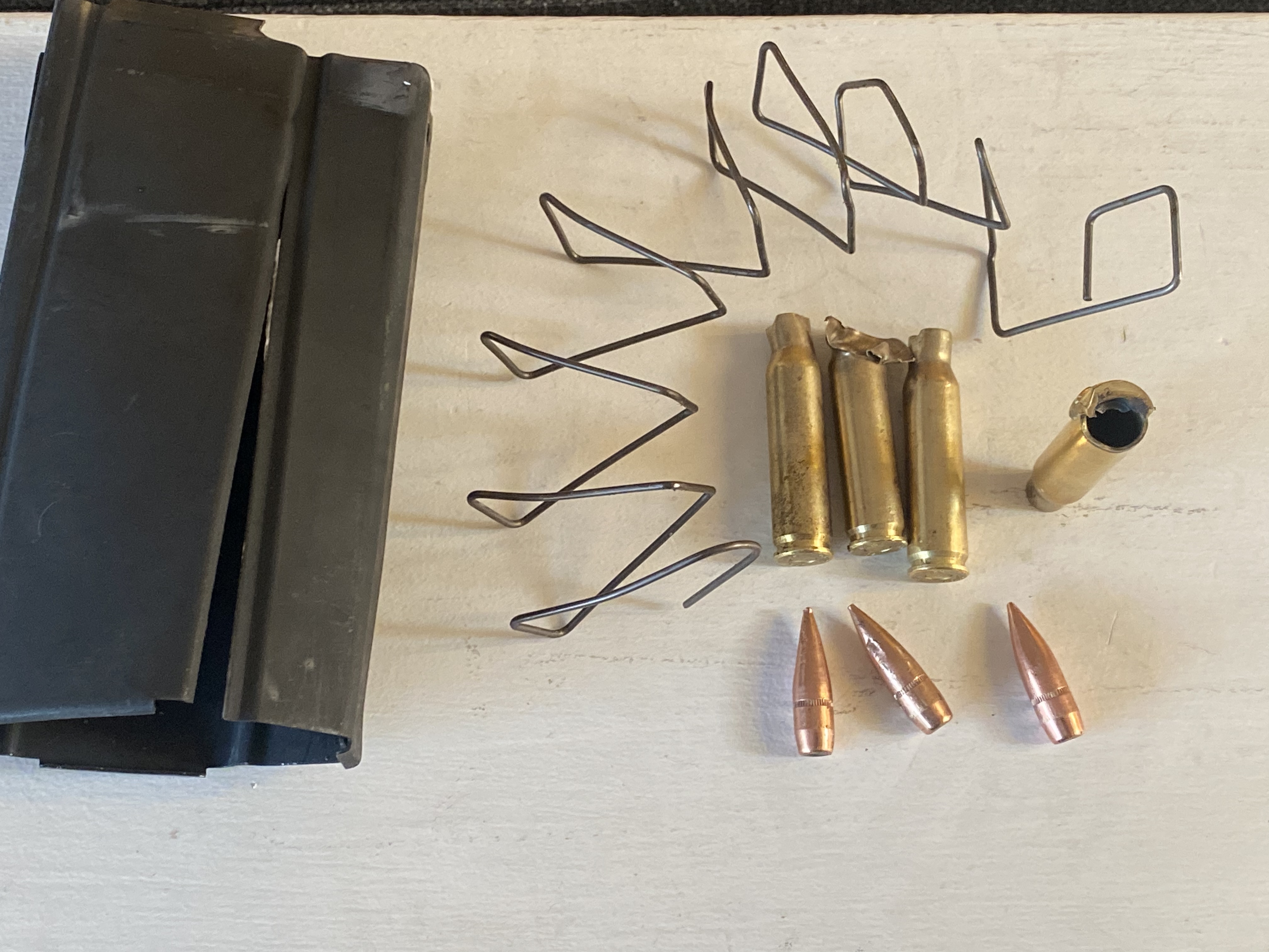

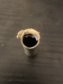

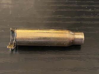

Brand new rifle, 17th round, trigger pulled and boom. Blew out the bottom, part of casing stuck to firing pin area. No injuries thank goodness. Whole incident captured on video - posted to YouTube.
Happy no one was hurt, disappointed the rifle is done.
Ammo: ZSR 7.62x51 (M80) 147 grain
Never thought this would happen in a million years! Be safe on the range.

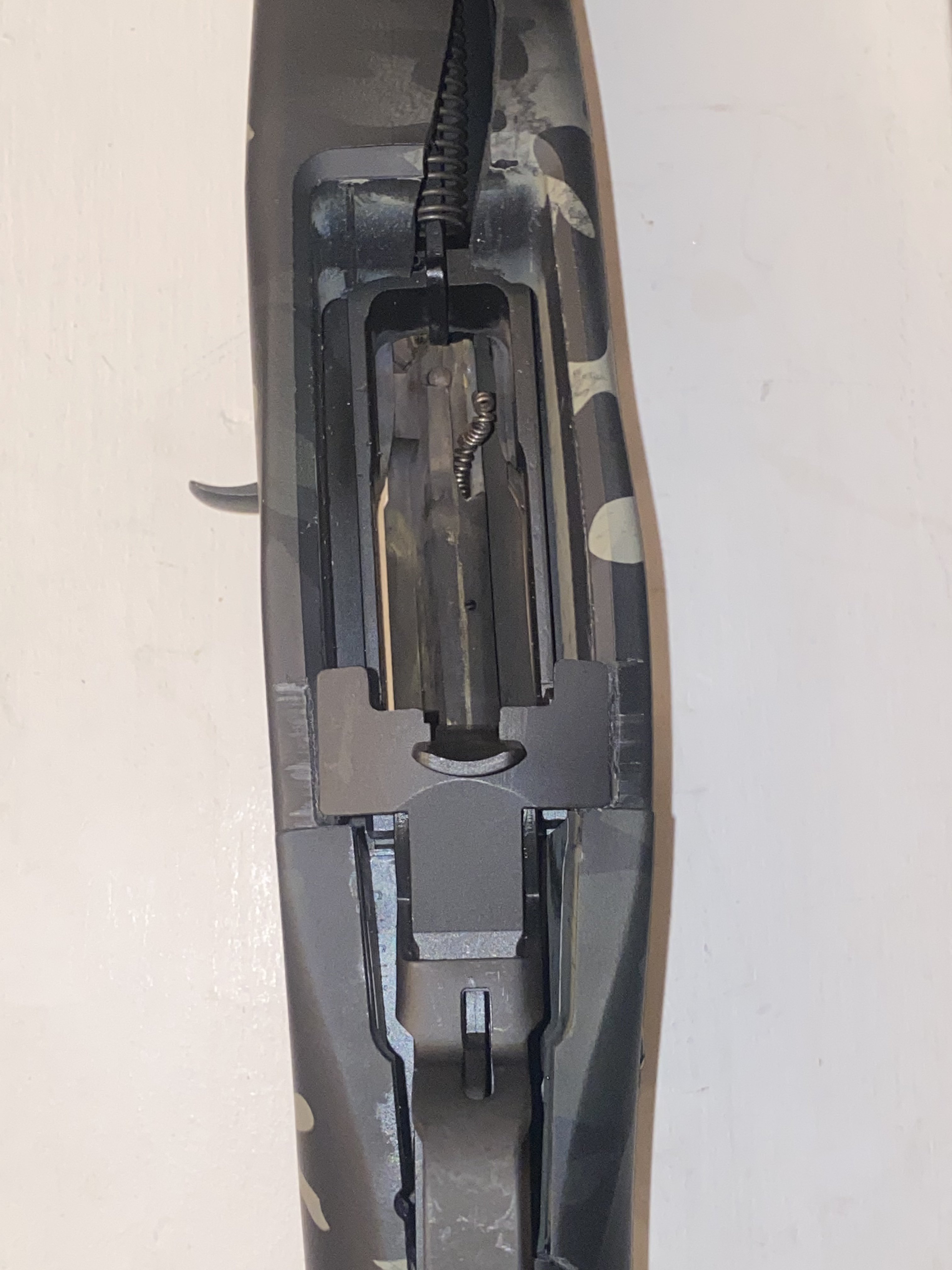

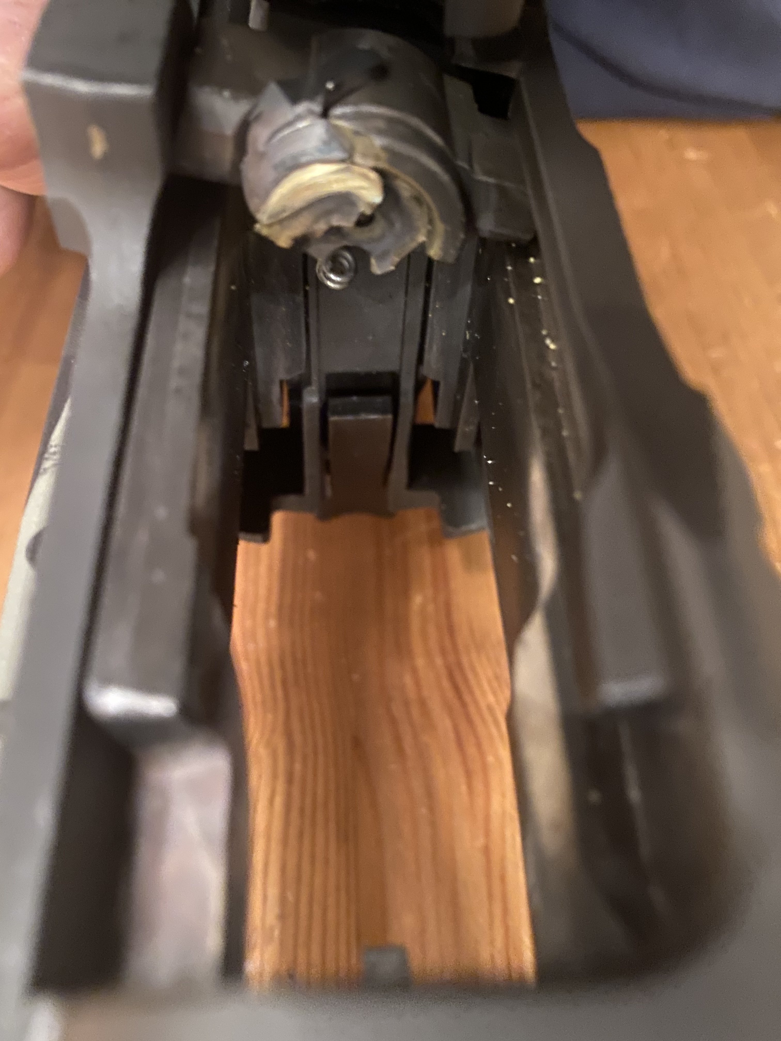

That could have been a slam fire however I doubt it as #17 would have gone off without pulling the trigger after loading from firing #16
My take on this is an over pressure round, #17 which blew straight down or it was a slam fire that ignited the primer before the bolt was in full battery.
That being said there is really not enough information on the total condition of the gun, ie bulging of the barrel?
A lot of unknowns.
My guess is Springfield will replace the gun after inspection.
