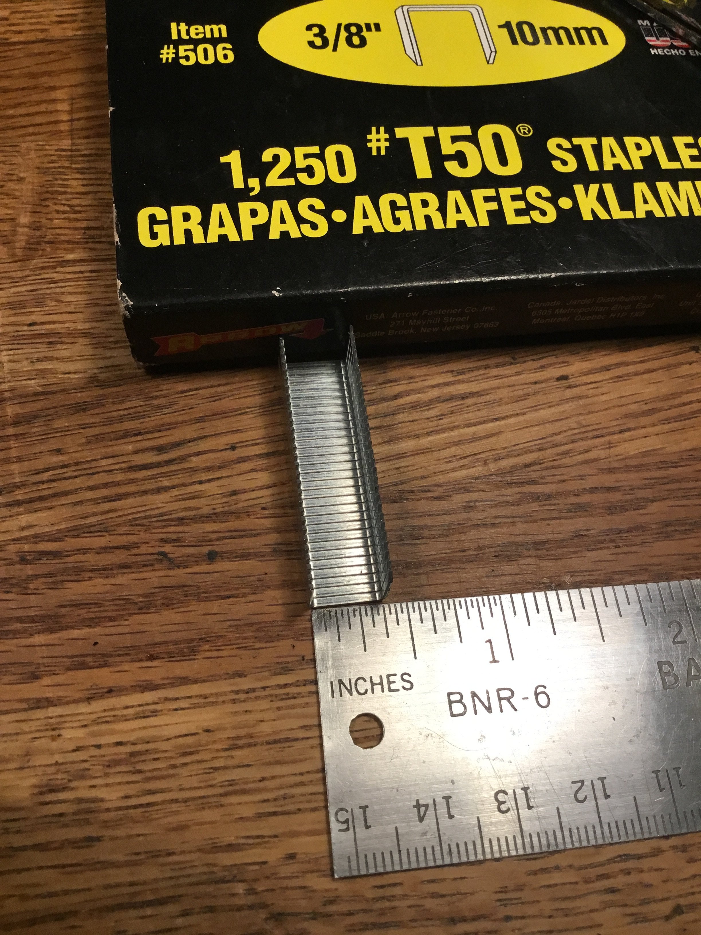

I just noticed on your picture on (that) box is the 9/16”depth (Leg) and the staple is labeled for Ceiling Tile (the old fiber celotex). So you saying the picture is exactly the one you have, not the actual one that you were using a 1/4” depth (Leg) staples, I misunderstood that.
To be sure if a T-50 is compatible, measure the crown or top the staple used that your Swingline. Seems 3/8” the standard is the crown for the handheld manual brands. Misnomers come with gauge of the metal staple - heavy duty vs. light duty, and purpose.
My photo Arrow T-50 shows the 3/8” crown, but it is also a 3/8” Leg.
You can also measure the spring loaded push rod end.
For the entire max depth the Swingline (or any) staple can fit, slide the ruler down into the rails, it will be 1/8” longer than the max leg length. The Arrow T50 I have will accept a 9/16” Leg down to 1/4”.

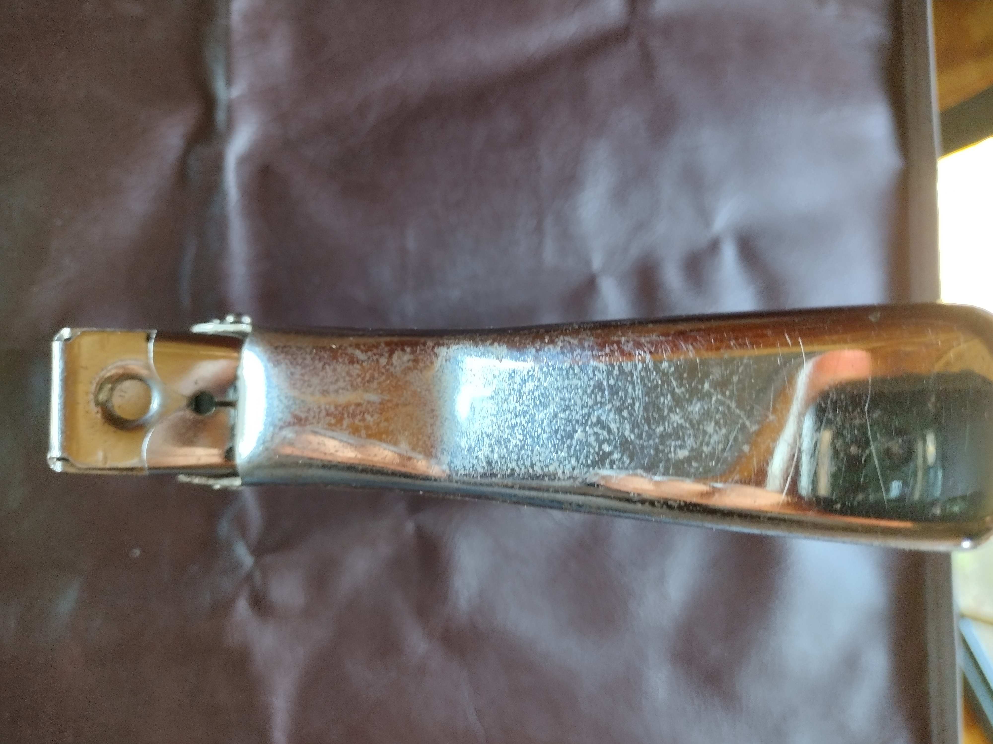

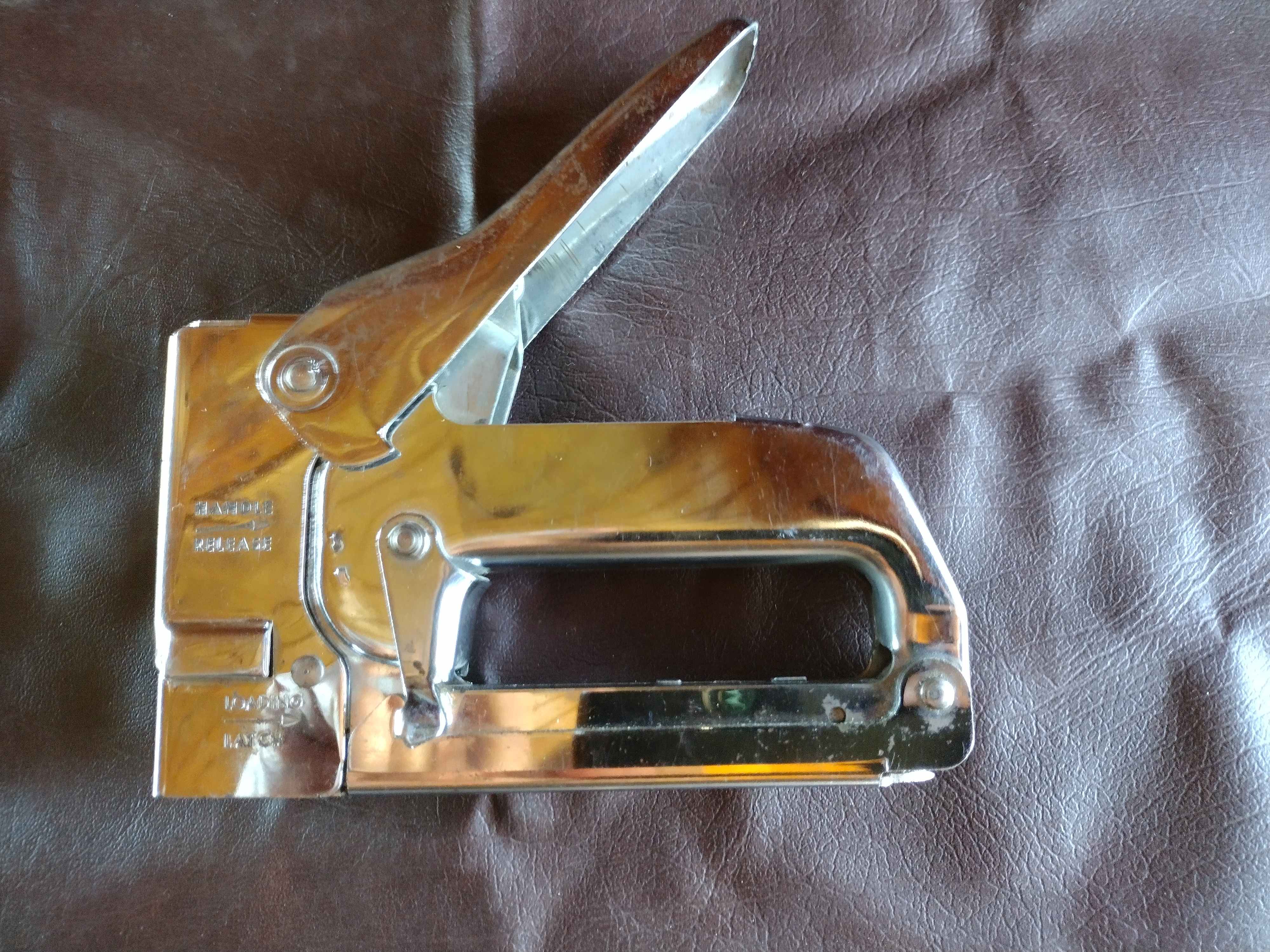

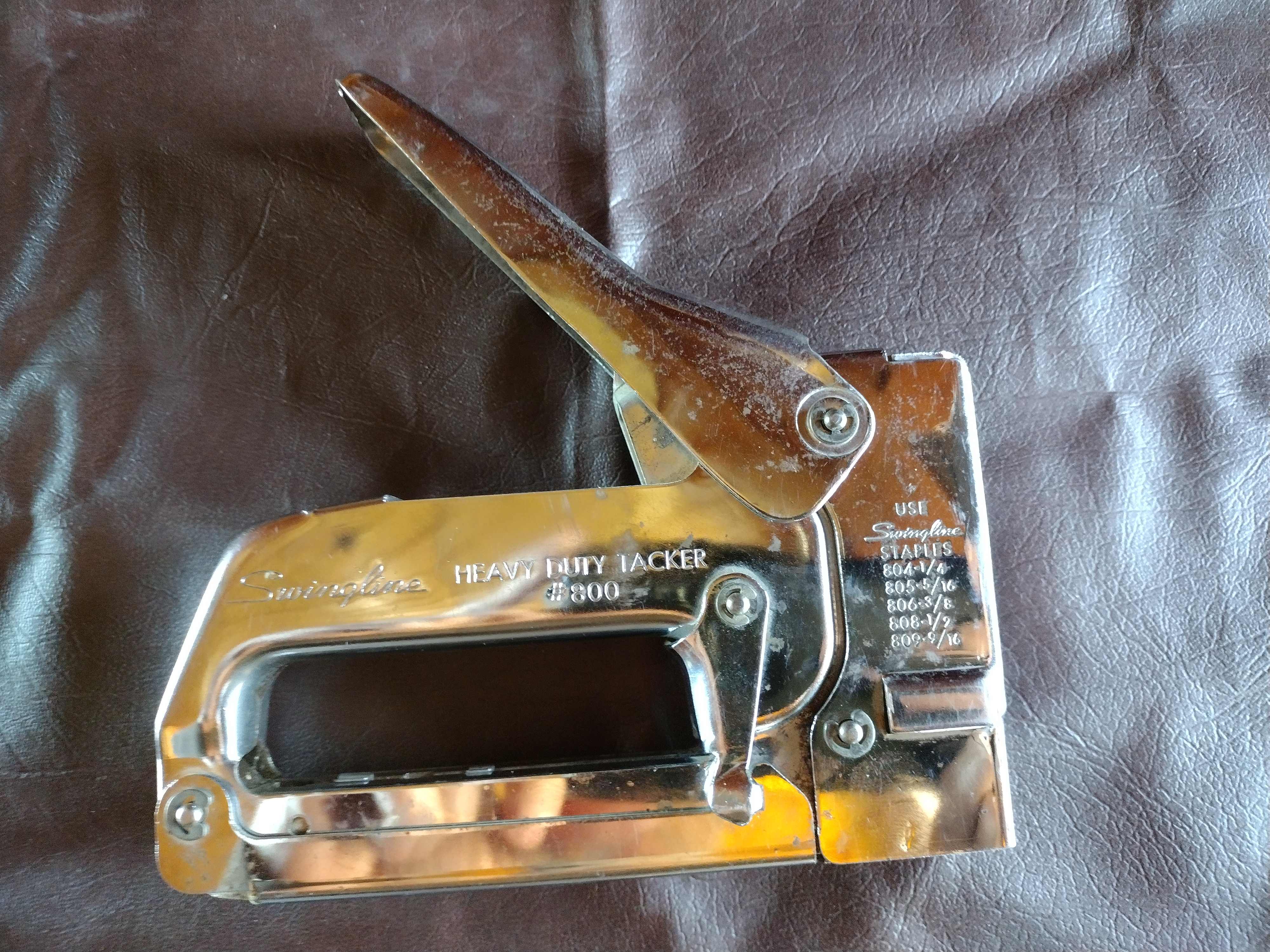

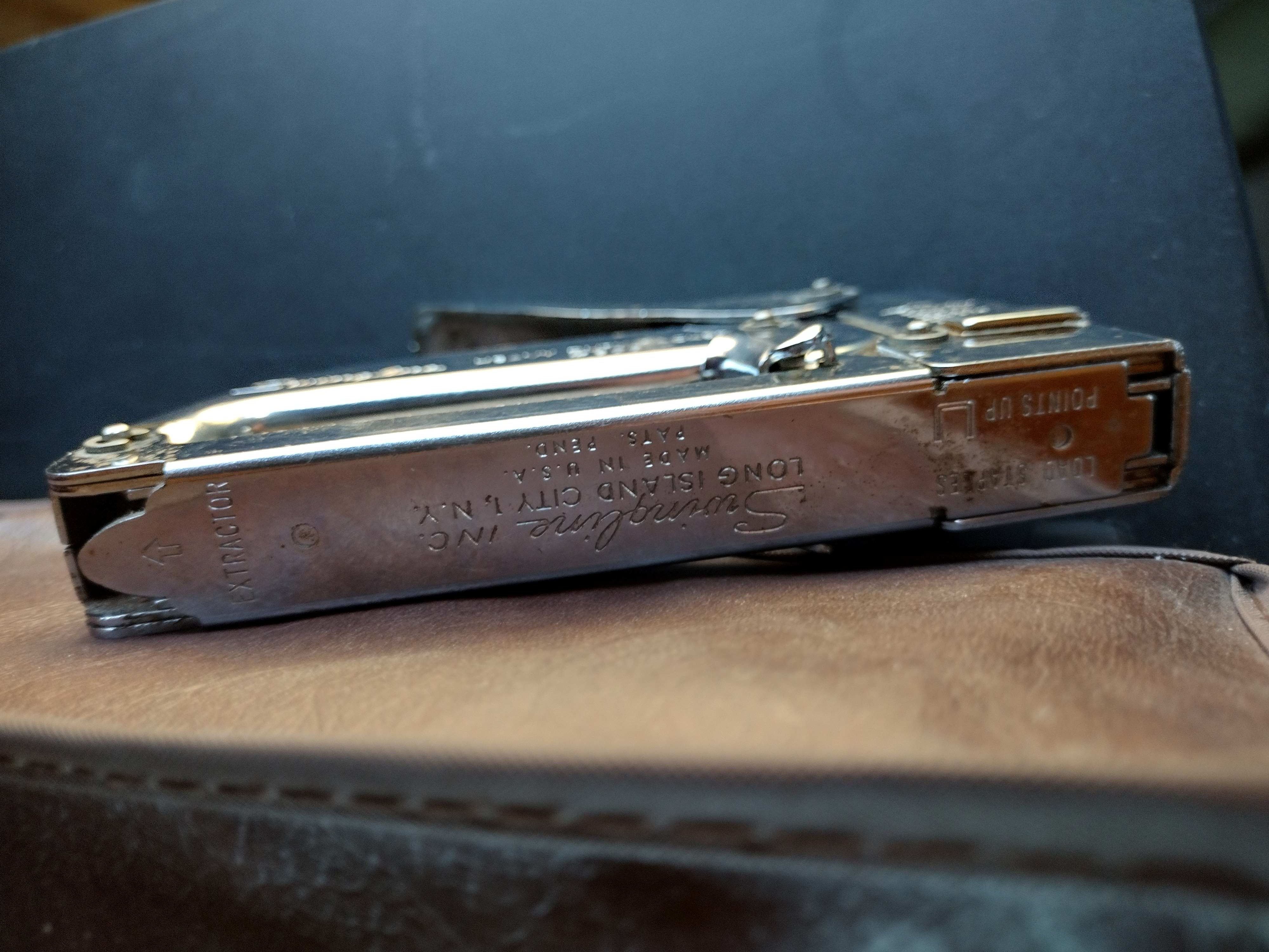

My apologies. The tacker is the same/similar to the one posted in the string. Attached are pics of mine. It's clean and in great shape. Thanks.

Try putting your thumb into the hole where your fingers usually go and wrap your fingers around the bottom of the stapler. Then squeeze the bottom upwards toward your thumb and while holding it there, pull back on the lever mentioned above. That will usually let it open. This will work in most cases. Let us know the result. jj
