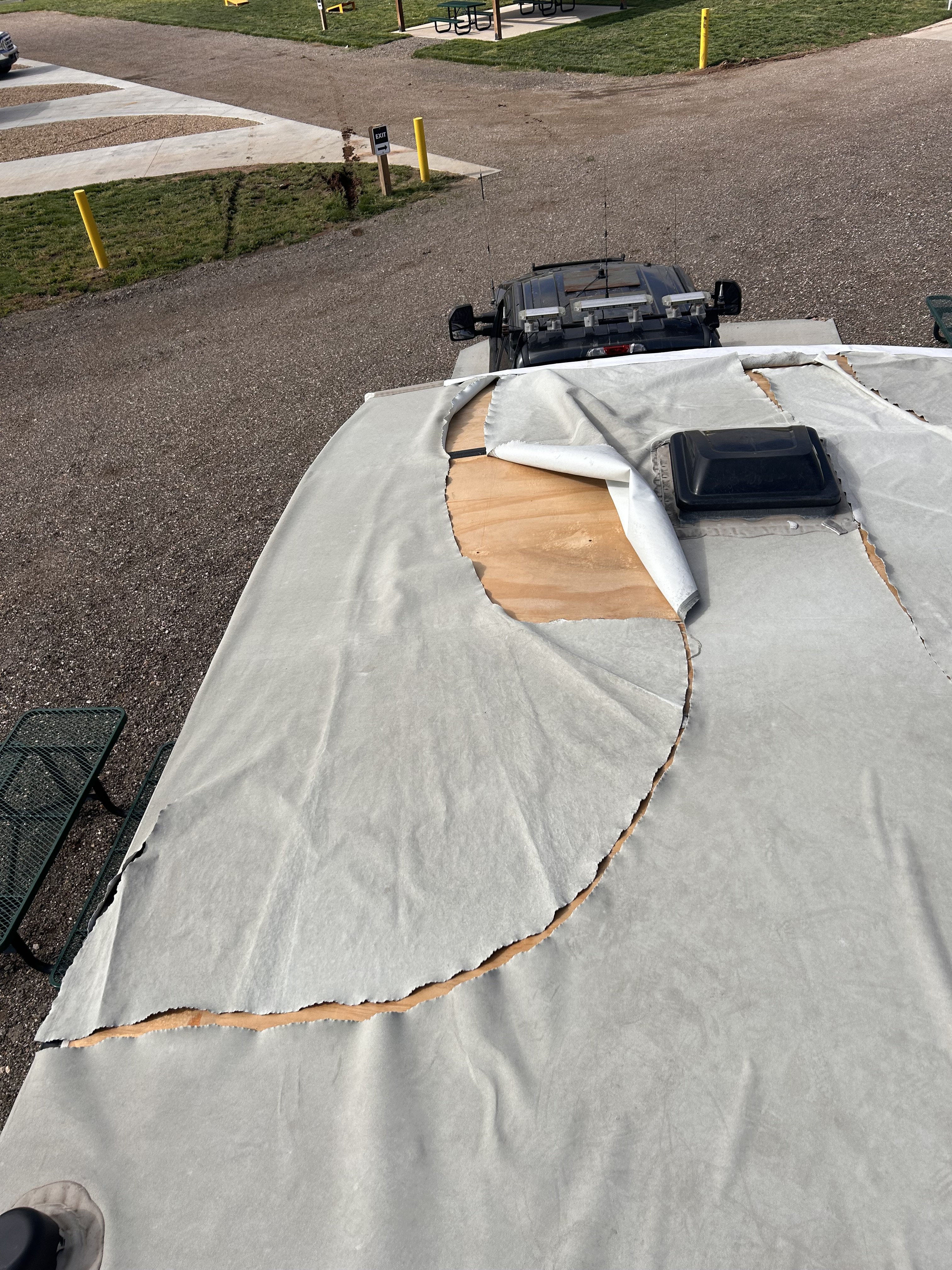

So I left the Campground in North/West Montana Last Thursday, I’ve been traveling about 280-340 miles a day averaging between 60 and 68mph.
before I got on the road every morning I would do a walk around inspection of the RV and every other morning I would get up on the roof to inspect for issues.
Fast forward to Monday I performed my walk around and got up on the roof and everything was good. I traveled Monday then Tuesday I did my walk around and decided to check the roof again, all good I only drove 240 miles on Tuesday.
Before going to bed I ended up talking to another camper at the RV Stop and he asked me “what happened to the roof?”
In one day……….

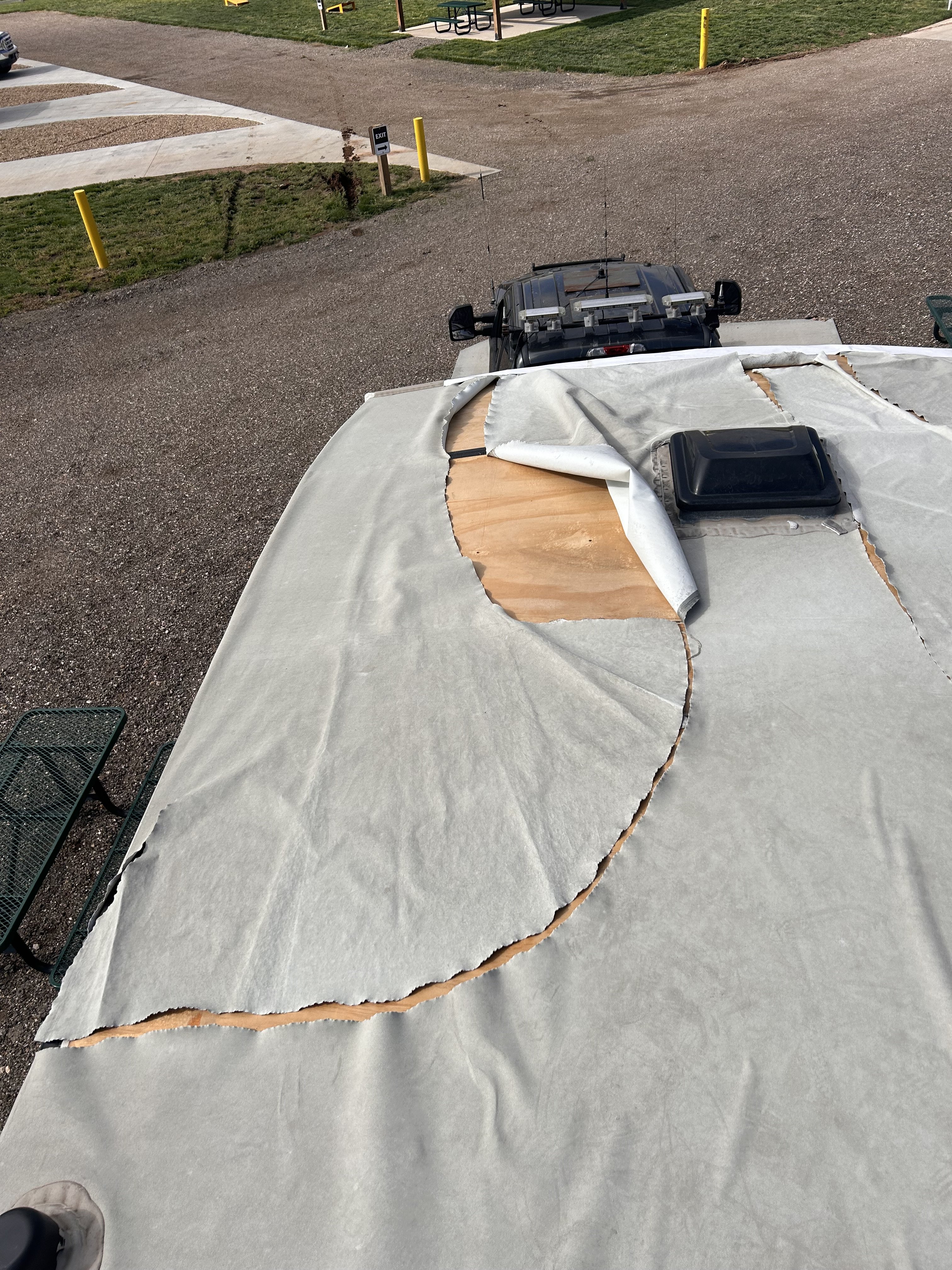

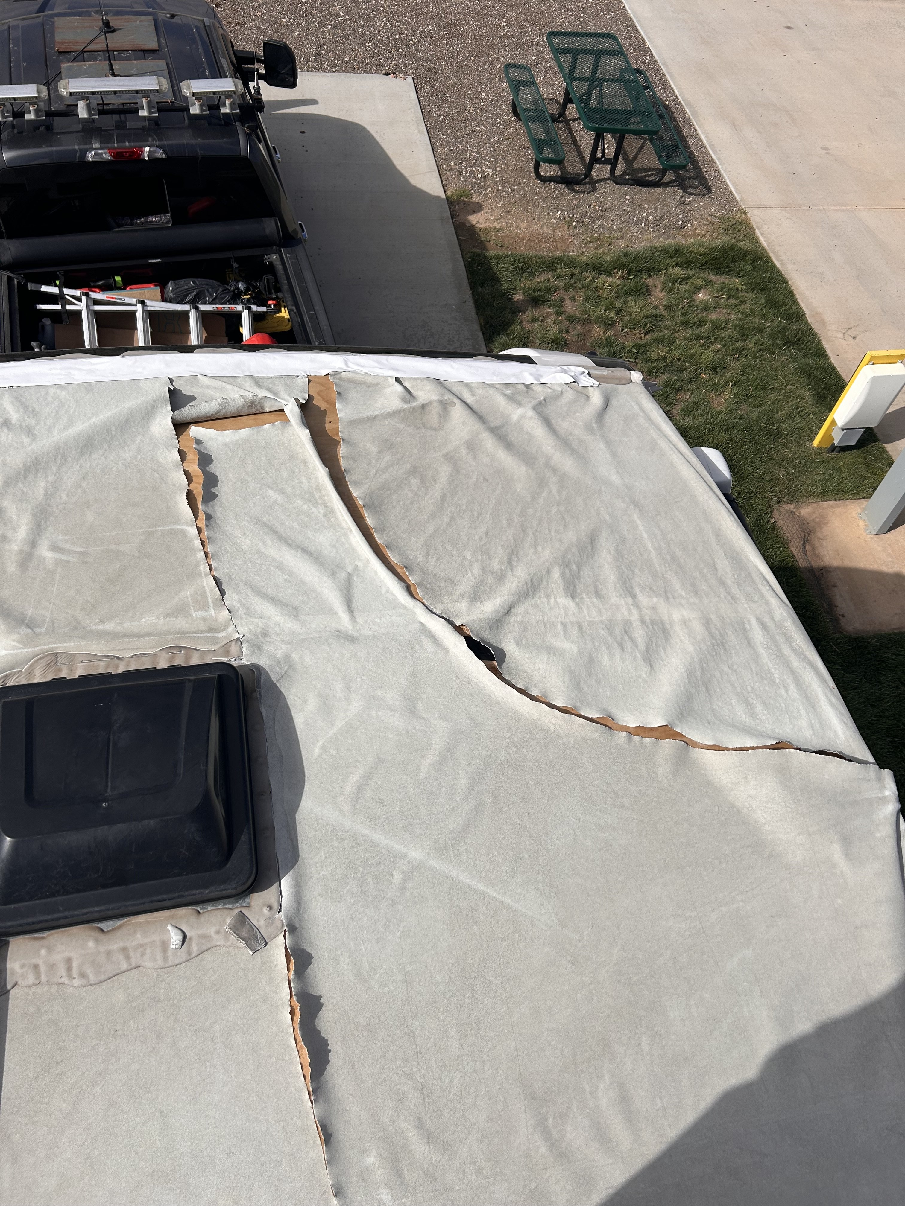

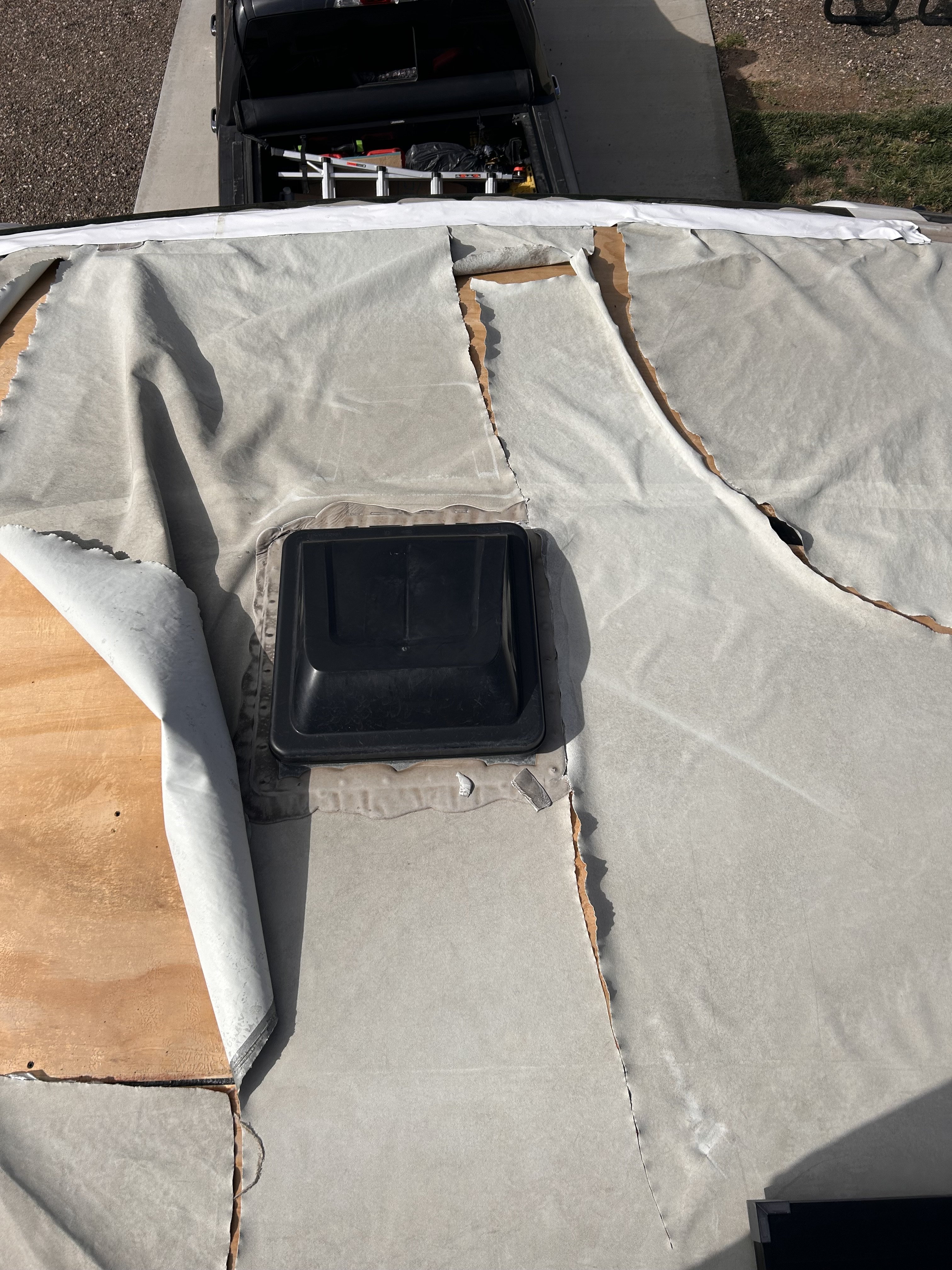

View attachment 65876View attachment 65877View attachment 65878View attachment 65879

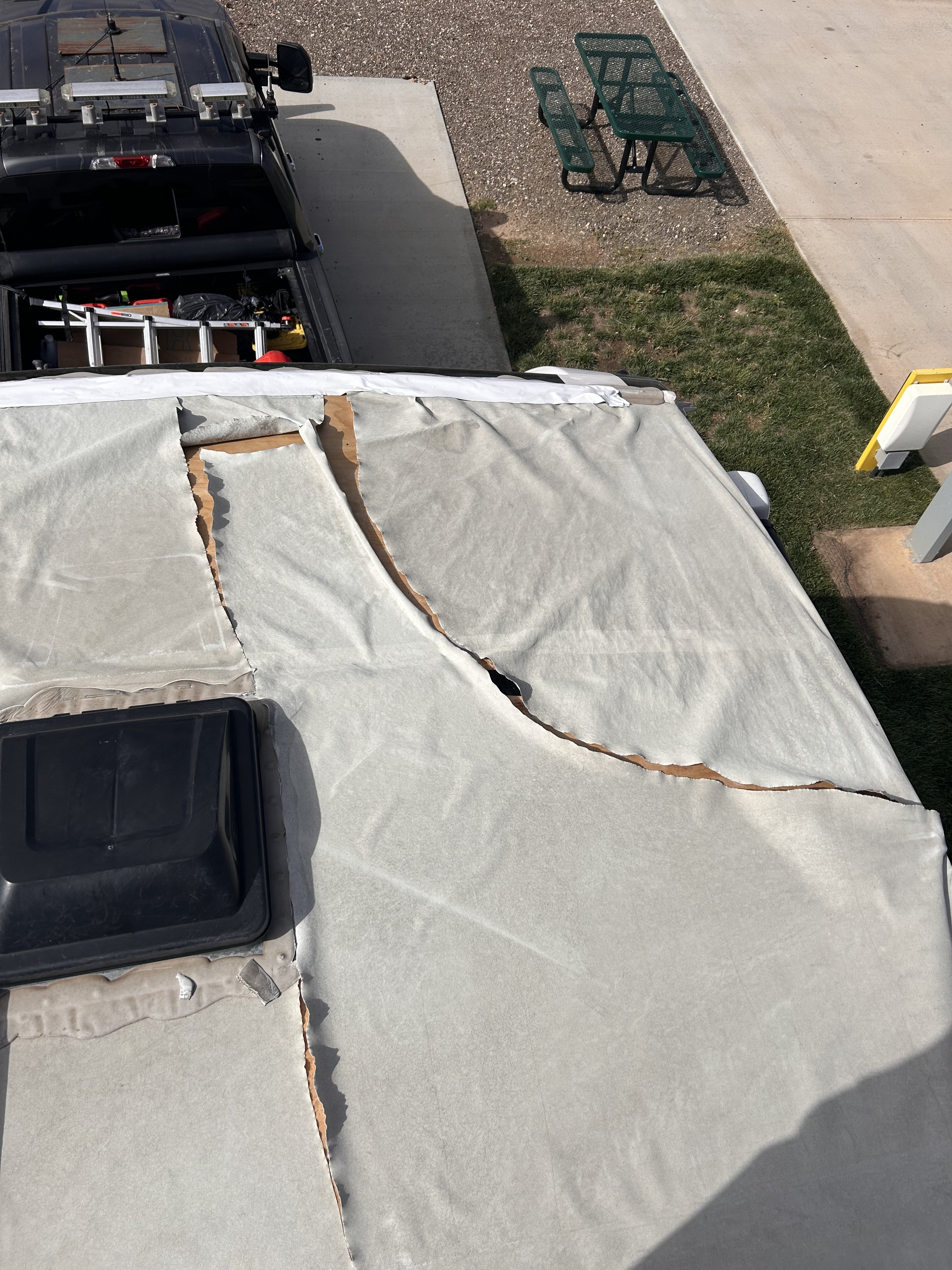

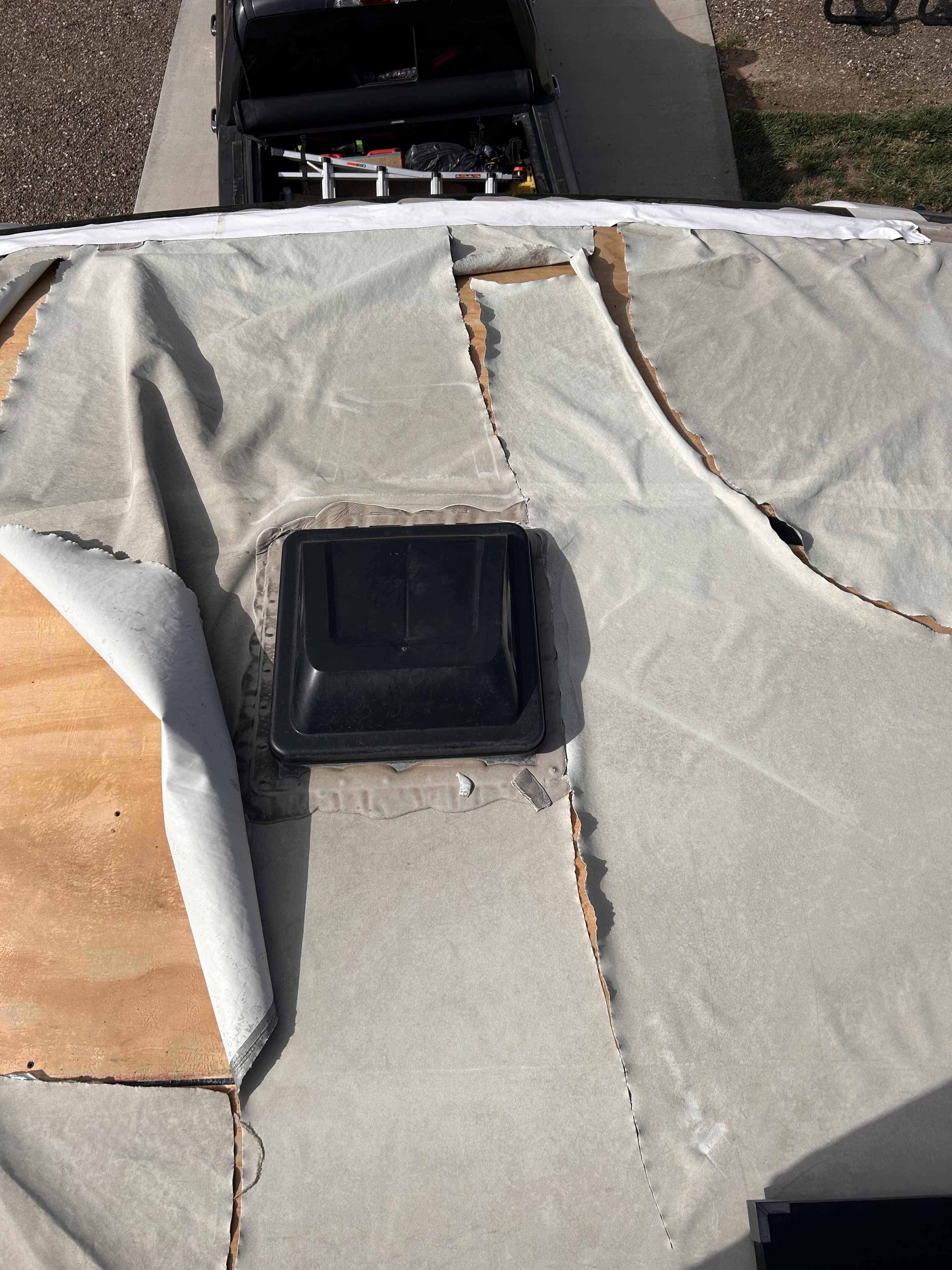

Yup one day of driving…….
Following a close inspection it looked like the front edge of the roof rubber membrane pulled out from under the edge of the RV’s front cap allowing air to get under the membrane.
I couldn’t do anything at that time since the sun was going down so I had to lie in bed directly under this section of the roof and listen to the torn sections flap in the wind.

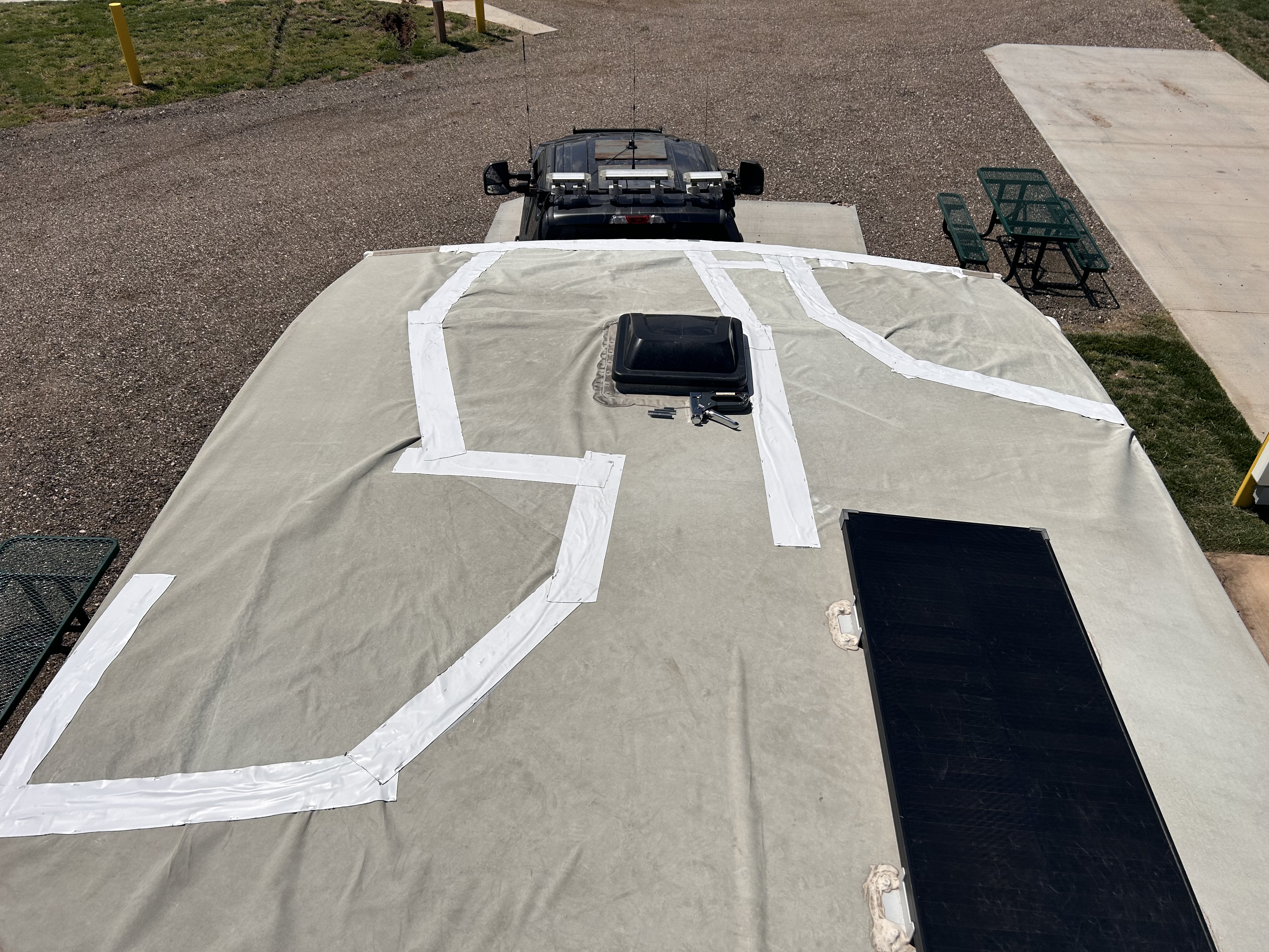

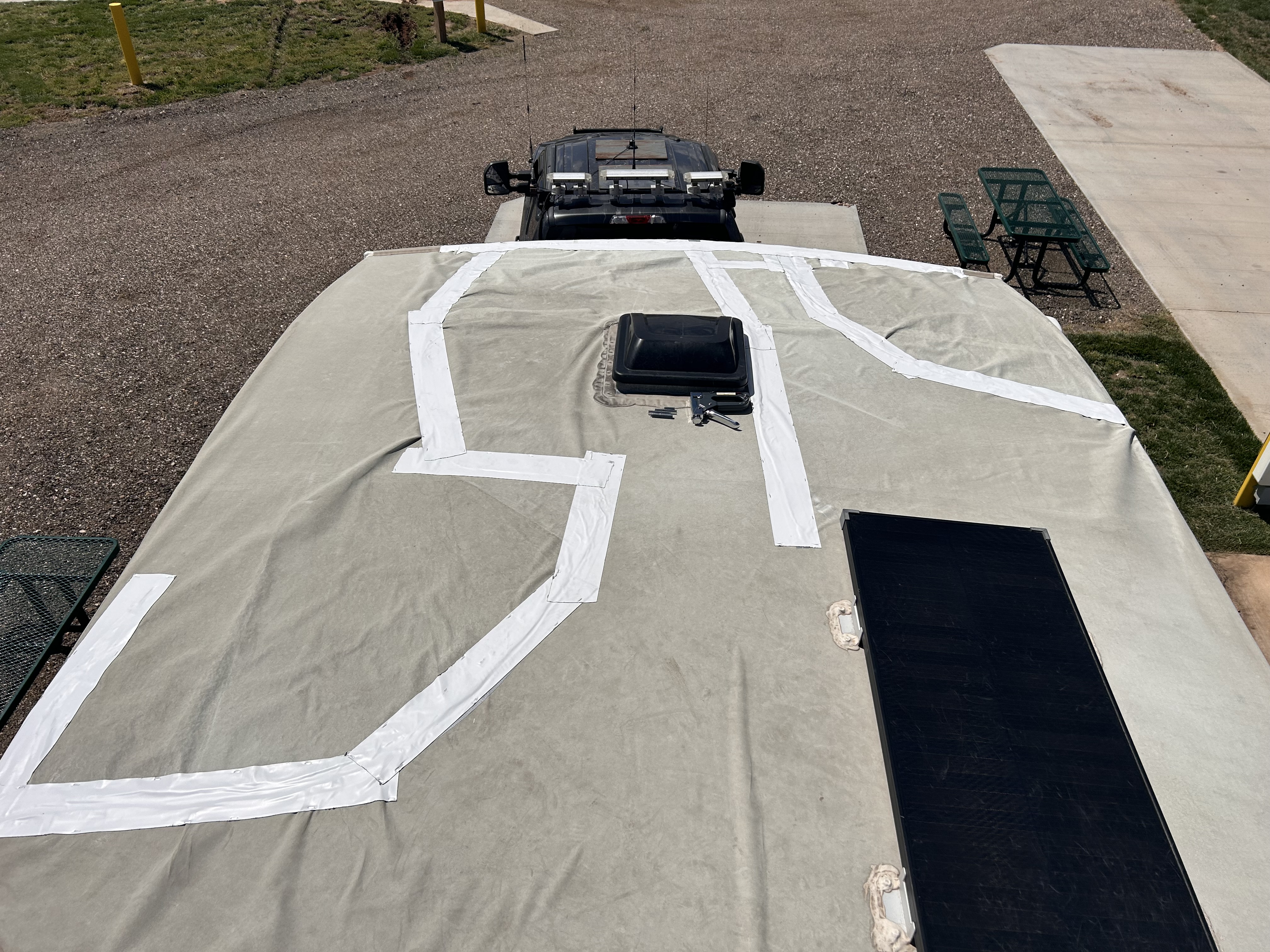

First I used Duct tape to hold down the ripped sections and then I covered all that with 4inch wide Eterna Bond which is an extremely sticky tape made for RV roof repair. I then stapled the EB tape using 3/8 staples on every edge and followed up that with 2 caulking tubes of Dicor which is a self leveling sealant which is used to fix minor roof leaks. I used the Dicor on every tape edge and covered every staple head. 3.5 hours later…….
This picture is before adding the Dicor caulking. You can see how the Dicor looks after it dries by looking closely at the brackets on the edge of the solar panel.
I was told by an RV dealership service tech that the staples were unnecessary but I knew that I needed to use them to keep the roof membrane from lifting up during travel.
I drove 260 miles today at roughly
60-65mph and when I stopped for the night I inspected the roof and all is good.
