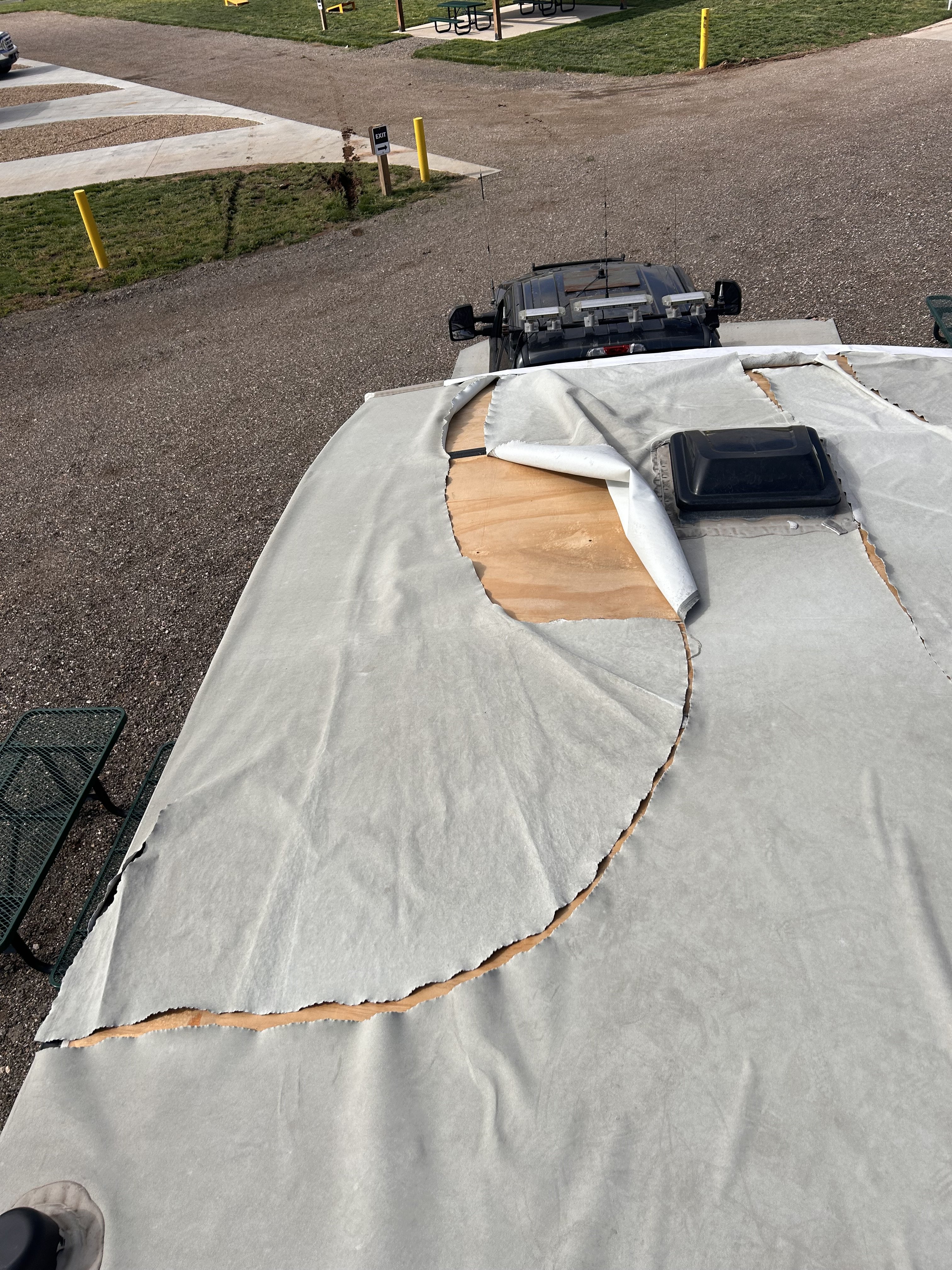

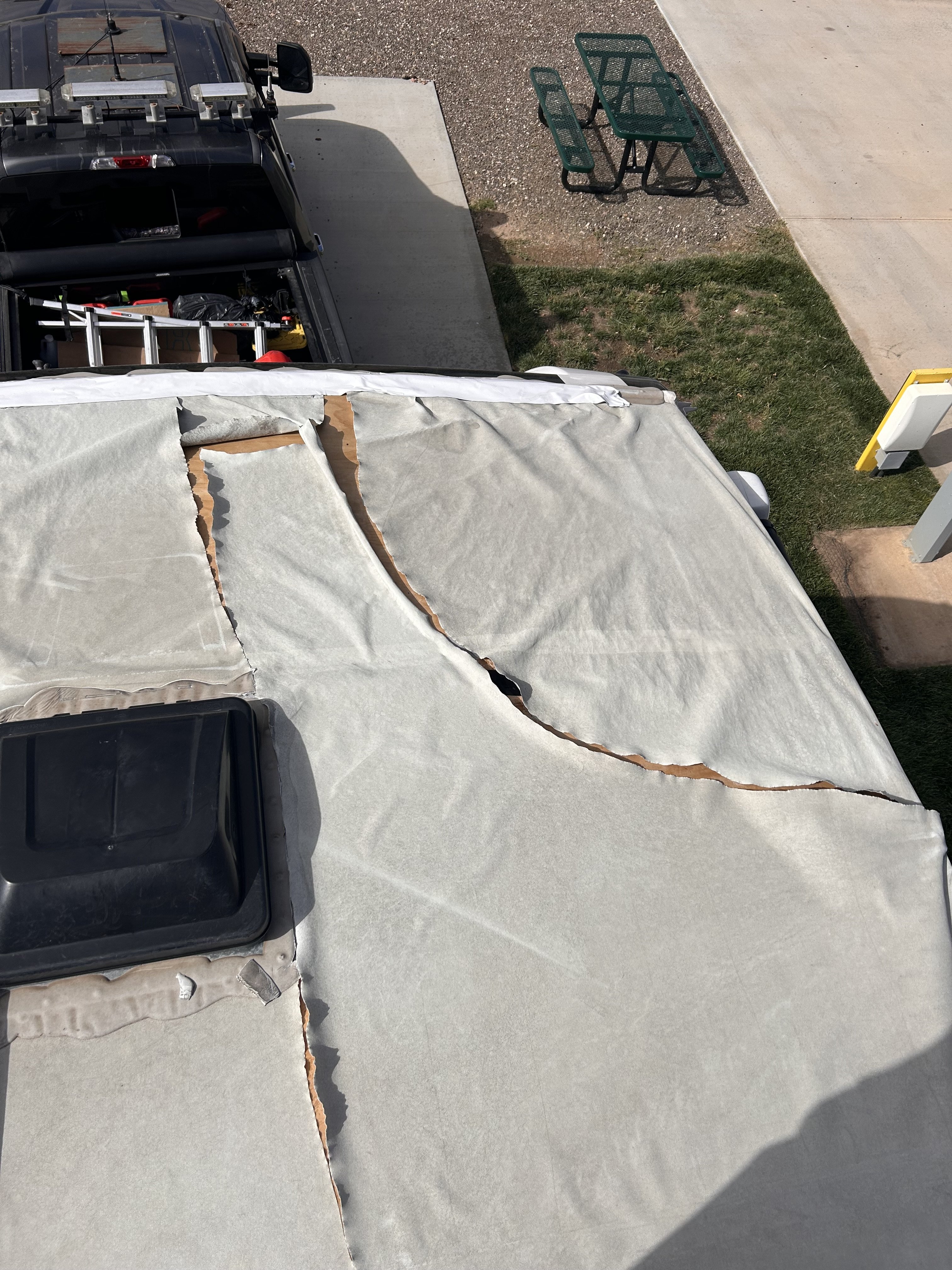

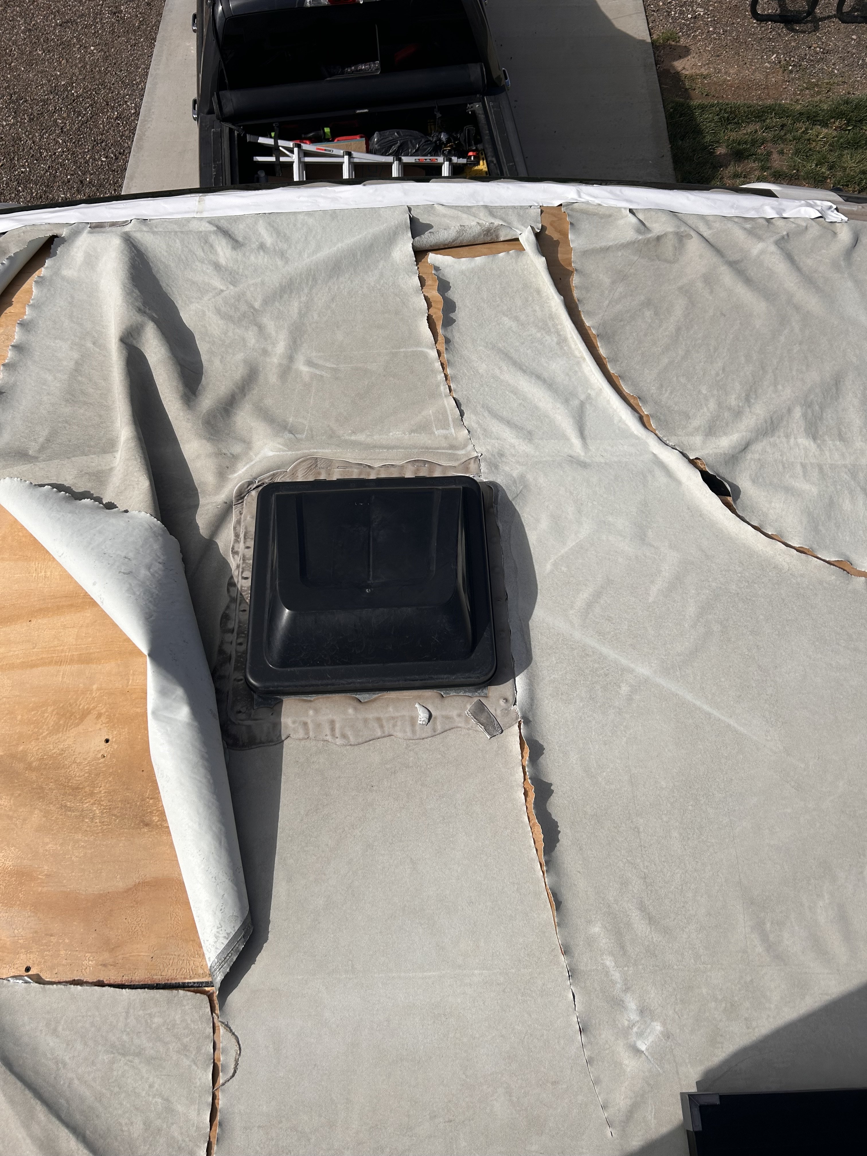

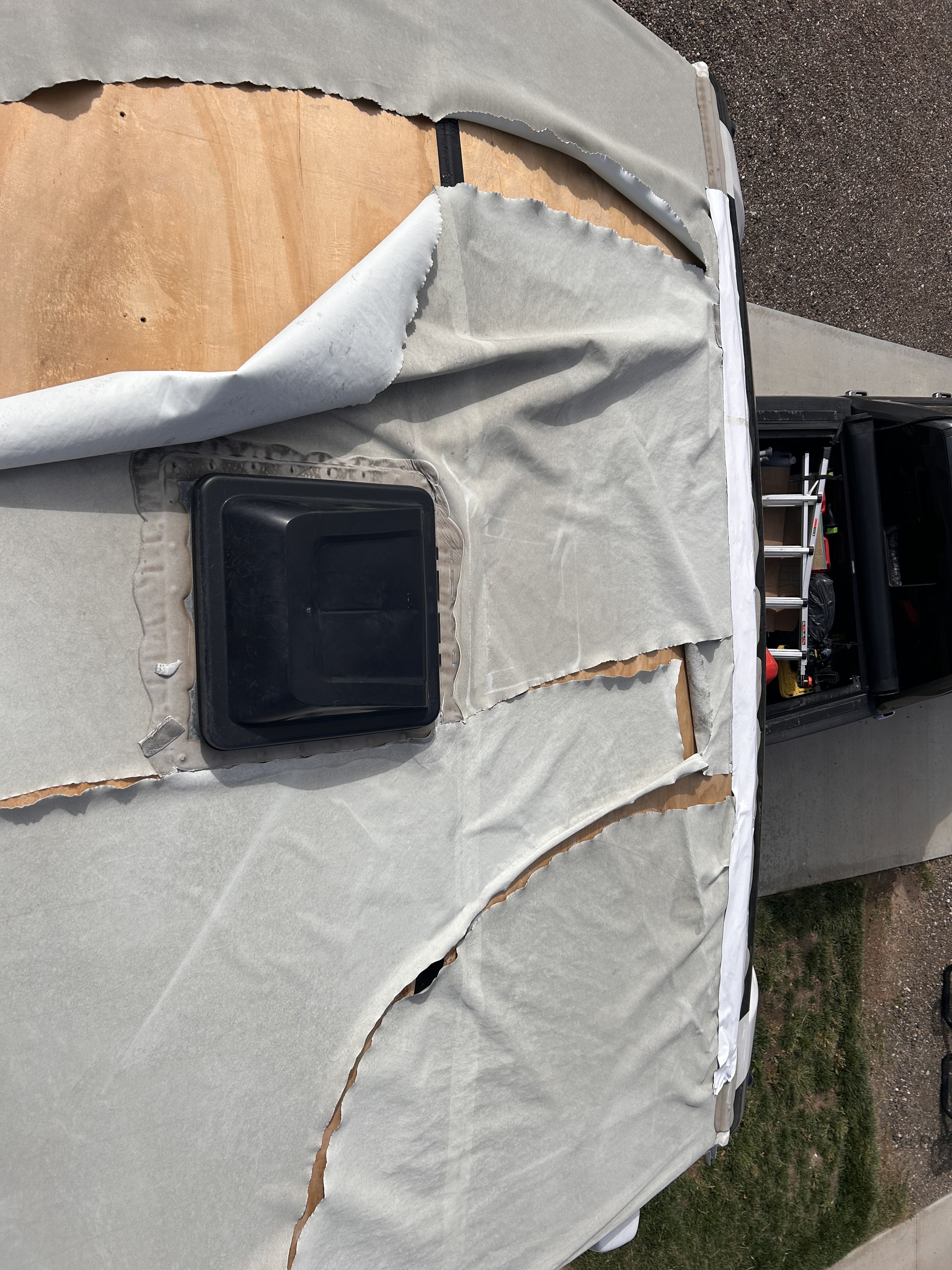

Following a close inspection it looked like the front edge of the roof rubber membrane pulled out from under the edge of the RV’s front cap allowing air to get under the membrane.
I couldn’t do anything at that time since the sun was going down so I had to lie in bed directly under this section of the roof and listen to the torn sections flap in the wind.

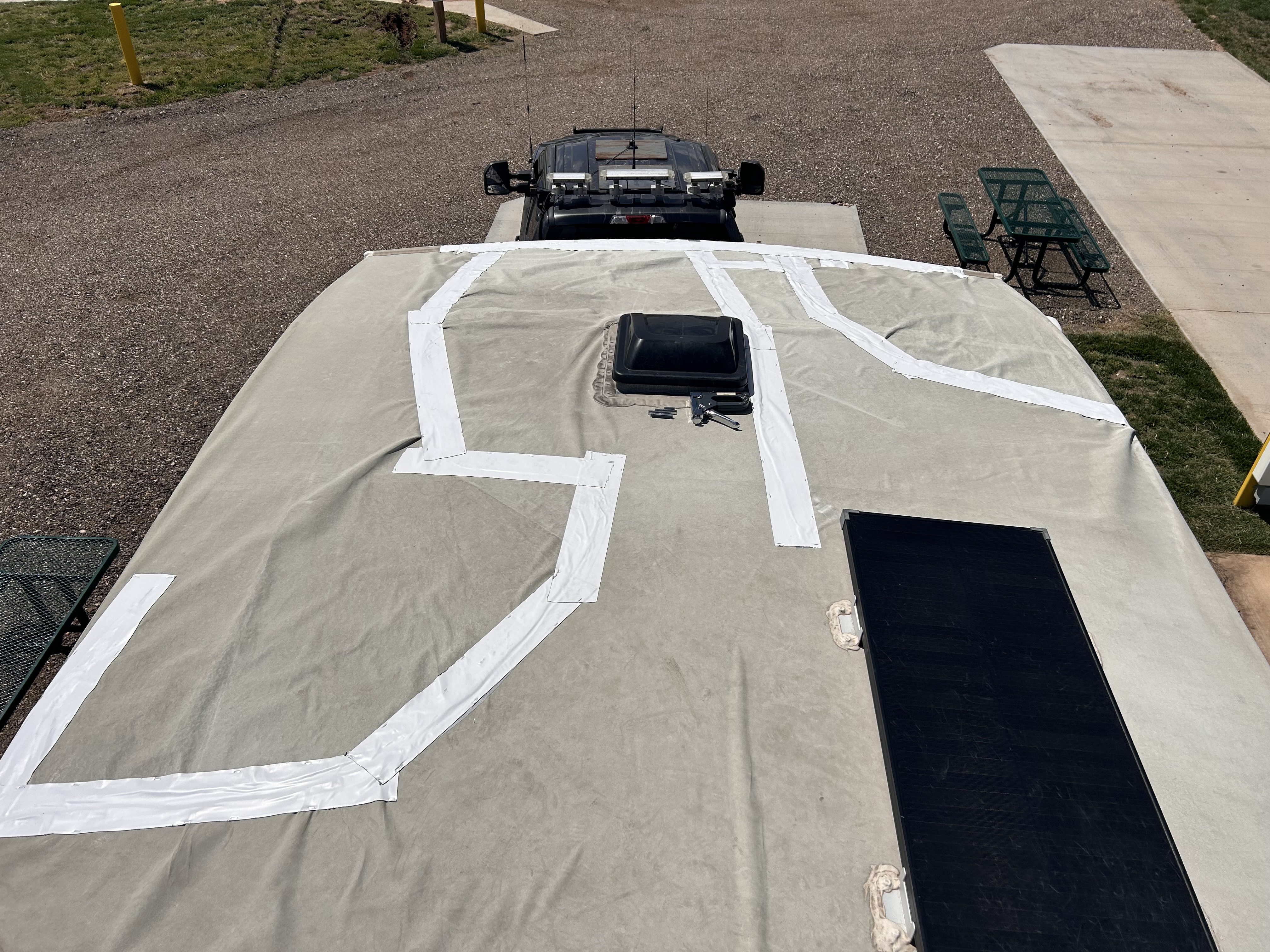

First I used Duct tape to hold down the ripped sections and then I covered all that with 4inch wide Eterna Bond which is an extremely sticky tape made for RV roof repair. I then stapled the EB tape using 3/8 staples on every edge and followed up that with 2 caulking tubes of Dicor which is a self leveling sealant which is used to fix minor roof leaks. I used the Dicor on every tape edge and covered every staple head. 3.5 hours later…….
This picture is before adding the Dicor caulking. You can see how the Dicor looks after it dries by looking closely at the brackets on the edge of the solar panel.
I was told by an RV dealership service tech that the staples were unnecessary but I knew that I needed to use them to keep the roof membrane from lifting up during travel.
I drove 260 miles today at roughly
60-65mph and when I stopped for the night I inspected the roof and all is good.
