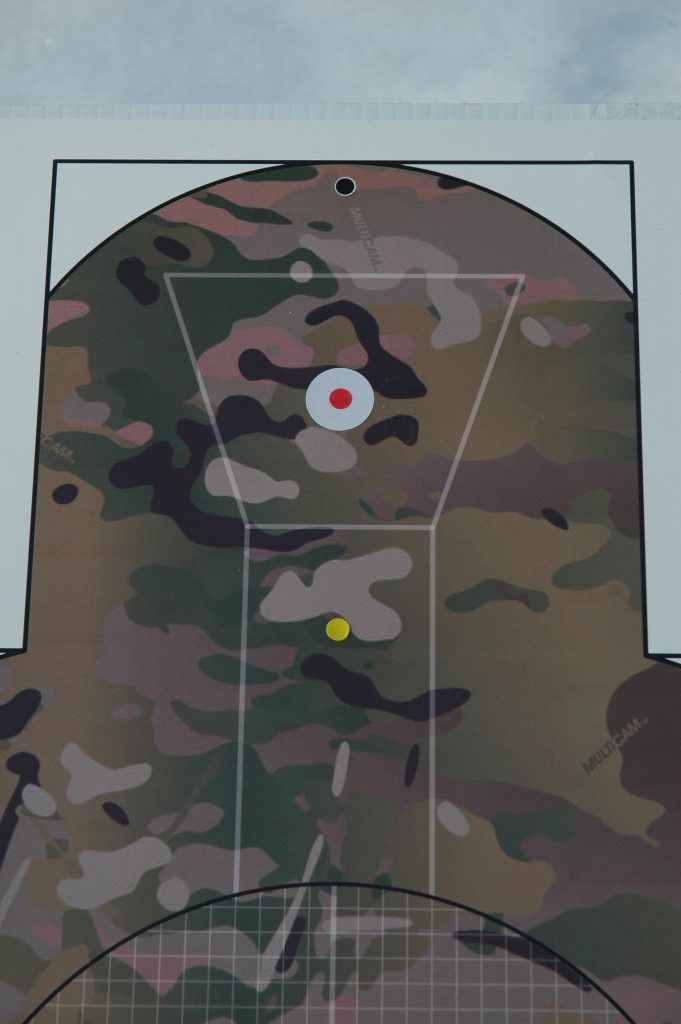

Here's the results of the Pinty $25 at the range today.
Firstly. The earplugs rather than the mu*ff were the answer to being able to see the sight properly.
Secondly. Green as opposed to Red is much better for the eyes..... it's an age thing! :ROFLMAO:
Thirdly. A cross hair vs dot are much better which that too is an age thing.
Fourthly. I can Zero the sight out at 4 yards and then interpolate from there for 3 to 12 yards.
Target pic below..... Top Left 9', Right'12, Center 15', Bottom Left 21', Bottom Right 36'
You may notice that some groups seem to vary left to right. That is because I get tired of
waiting for the target to stop oscillations when it is sent out. We have had different hangers
installed and needs some fine tuning. 🤣 So I get a little impatient and want to go bang and
don't quite give it the full 30 minutes to settle down.
Any ways. I zeroed at 12'. At 9' it drops down a bit. At each distance beyond 12' it rises up
some. A perfect head shot at 30' or so means aim at the bottom of the chin.
Center mass shot means shoot center mass. Hit may vary but will most certainly stop the
threat.
I may try some weight at the bottom of the target to stop the movement sooner.
Still one needs to train on moving targets, don't they?

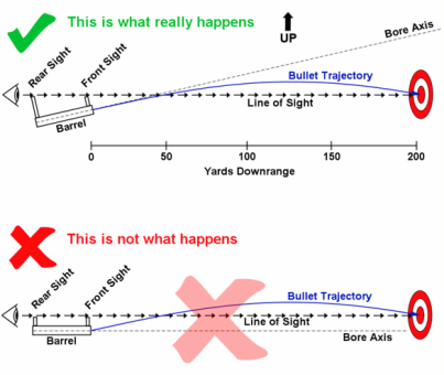

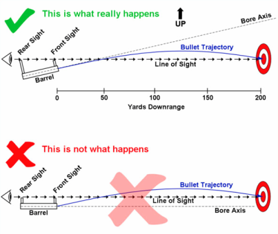

@SMSgtRod - mechanical offset's effects are greatest at distances below 10 yards. As you bring the template closer and closer, that difference becomes more and more drastic.
This is why close-distance zeros are universally not recommended by any SMEs in the CQB arena.
At the minimum, I would zero at the 25 yard line.
From there, it's time to learn the offset of your optic/mount combo at CQB distances, from contact to 25 yards.
The following is written by the late Pat Rogers, and it is probably the most intuitive and yet comprehensive write-up on the subject of mechanical offset I've seen -
^ It's written for the .223/5.56, but the ideas are still the same.
That bullet never "rises" as it comes out of the barrel: that's a physical impossibility - rather, it's the fact that you've essentially tilted the barrel up and you are intersecting bore axis with that of the sight plane, that causes the "rise" in the bullet between the muzzle and the near zero -
^ Taken from - https://cowboytacticalgear.wordpress.com/2014/02/10/so-you-want-to-zero-your-ar15/
To be effective at any distance, you'll really need to zero the weapon system properly. Part of this capability will mean that at CQB distances, you'll absolutely need to instantly and instinctively compensate for mechanical offset.
