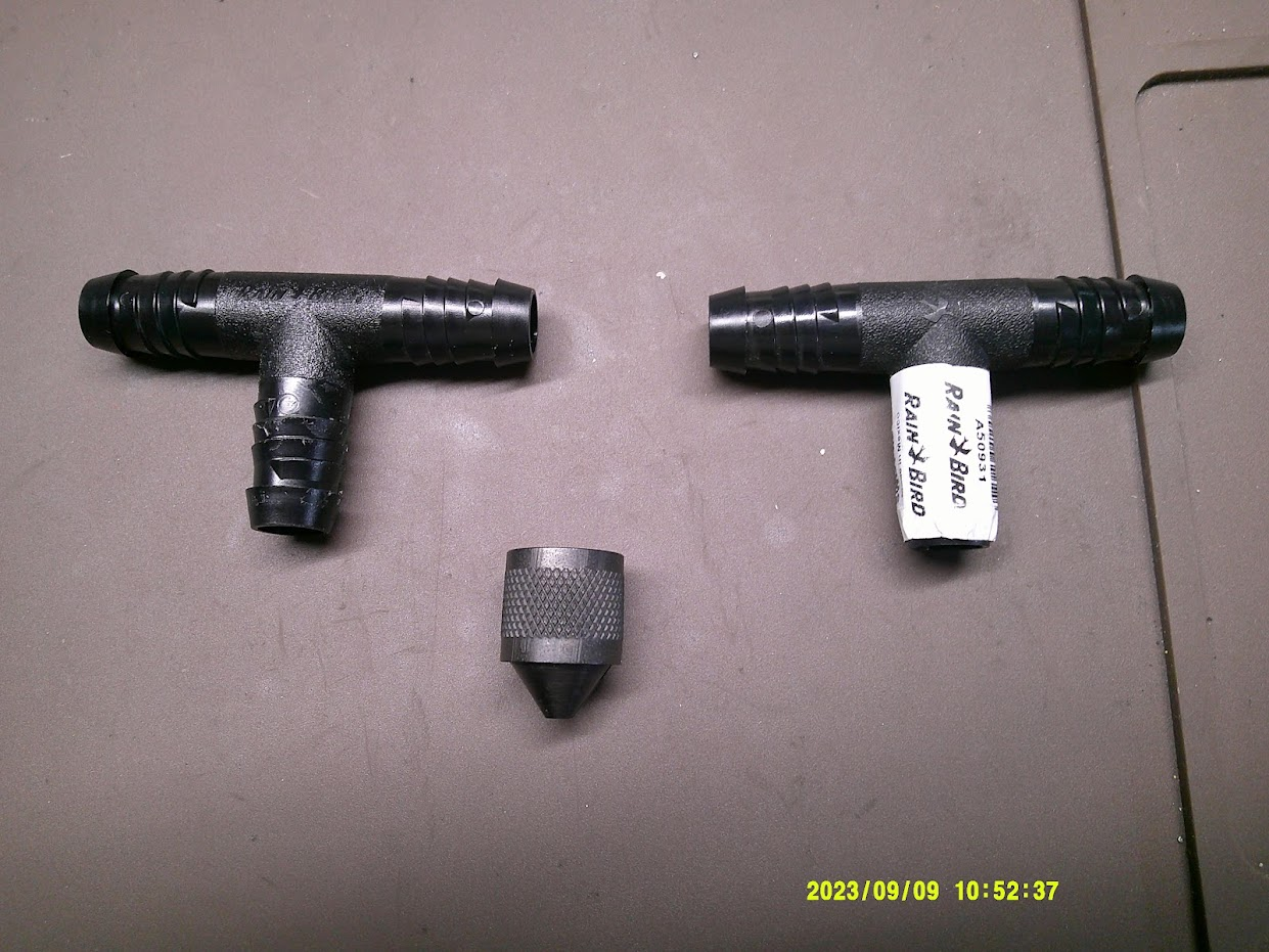

ok, so my Lee swag tool arrived the other day. i went to Lowes to try and find a wooden dowel, to use as a handle. no luck, either too large or too small.
so i get to the plumbing dept, and there i find these 1/2" plastic "T"s......98¢ each, so i get 2.
i wrapped some electrical tape around the piece, and it's a tight fitting hand tool.
i have now about 62 military 9mm casings to "swag" the crimp, i already had success doing 2, and installing a new primer.

Old_Me, that's actually a "LEE" 'Chamfer and Deburring' tool. It's not the tool you need/want to remove the crimp from the primer pocket of military brass. It's used to take the sharp, ragged edge off both the inside and outside edge of a recently trimmed brass case mouth. The trimming leaves a tiny ragged edge around the case mouth that if not removed will at some point accumulate to the point it can cause scarring of the outside of the case by building up inside the sizing die, and can sometimes affect the amount of bullet pull on the projectile if left on the inside. Used on the inside, whether the case was trimmed or not, it will make setting the bullet into the case mouth a little easier by causing a small chamfer on the inside and will eliminate any potential bullet scarring.
To use it you place the pointed end inside the case mouth and simply give it a complete turn but without a lot of pressure. To smooth the outside of the case mouth, you have to use the inside of the tool and use the same process. Unfortunately the way you've added the 'handle' you can't access the 'inside' of the tool.
What you actually want/need to remove the crimp from a military case primer pocket is called a 'Primer pocket reamer'. Most loading equipment/tool mfr's will have one. Some mfr's may even somehow use the same tool for both jobs, although I've never seen it. But "Lee" isn't one of them. Check into it a little further my friend.
NOTE: My guess is you had to push the 'chamfer' tool so deep into the primer pocket to cut the crimp, that the tip of the tool is what caused the oversized flash hole in the case. Regards, jj.
Ooops, I just re-read your post and see that you said it was the decapping pin that made the flash hole oversized. I was under the impression it was the 'chamfer' tool that caused it. Sorry.
