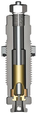

took a que from @youngolddude and ordered up the Lee Bulge Buster Kit, and that arrived yesterday (sat. 2/22/25)
about 2 hours ago i ran maybe about 1,000 45 ACP cases thru it.
some were new/first fired, some were my reloads, some were floor sweepings, so suffice it to say a variety of 45ACP brass.
after a few follies with my press (Lyman single stage) with the ram's support rods being loose,
i ran those casings..
some just slipped on in with no issues, many more were a gigantic PITA, and were more harder to run thru to flatten that bulge..?????..

i dunno, the gunsmith at my club had said that glocks have "unsupported" chambers, where the brass can "expand a bit", near the base, giving that bulge...i even checked this out several times online.
so even given that info, my brass shot from my 1911's and a couple of other 45's other than glocks don't seem to be of any issue.

it was 'interesting" how some brass running thru the Bilge Buster was a PITA, and others were smoother...
didn't matter the head stamp either, Winchester, S&B, Remington, (new once fired) Star Brass, and LPP Federal

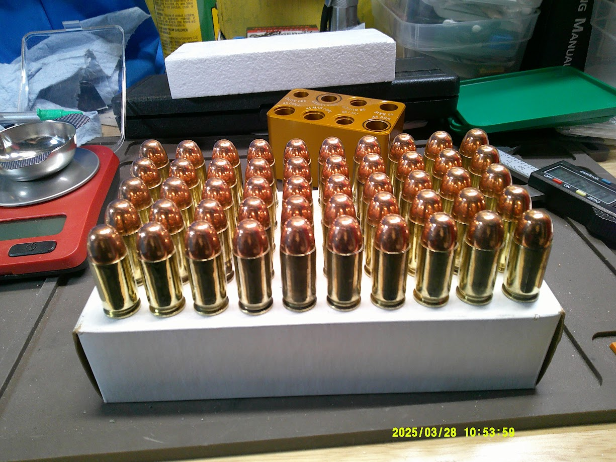

actually after i sent the brass thru the Bulge Buster die, THEN i put a few into the Lyman case gauge block, and they slipped in easily.
until then, only after the reloaded cartridges were being plunk tested and measured for OAL.
before this, the cleaned/polished brass went directly into the storage tin cans.
I like those gage blocks. I have 1 for every cartridge I reload for. It's great for AR's as makes sure the base is small enough.
