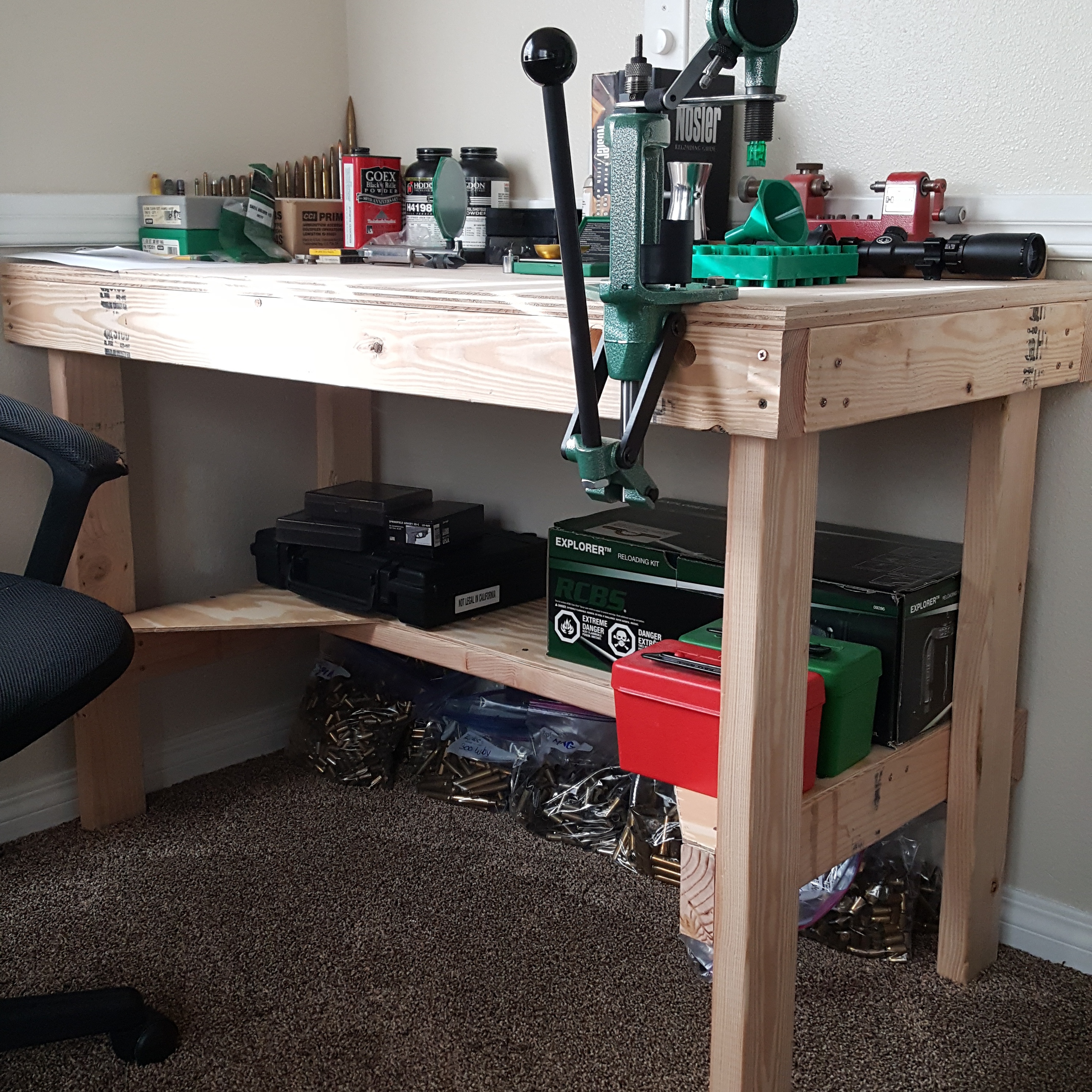

My reloading bench is in the garage. The pool noodle on the edge of the bench is to keep my truck grill from hitting it.
When I first read this my first thought was... is he describing from the belly button up or the belly button down?????? Judging from the height of the stool in the picture, I'd guess it's above.
Sorry if I misunderstood what you were describing !!! ;):D:D
