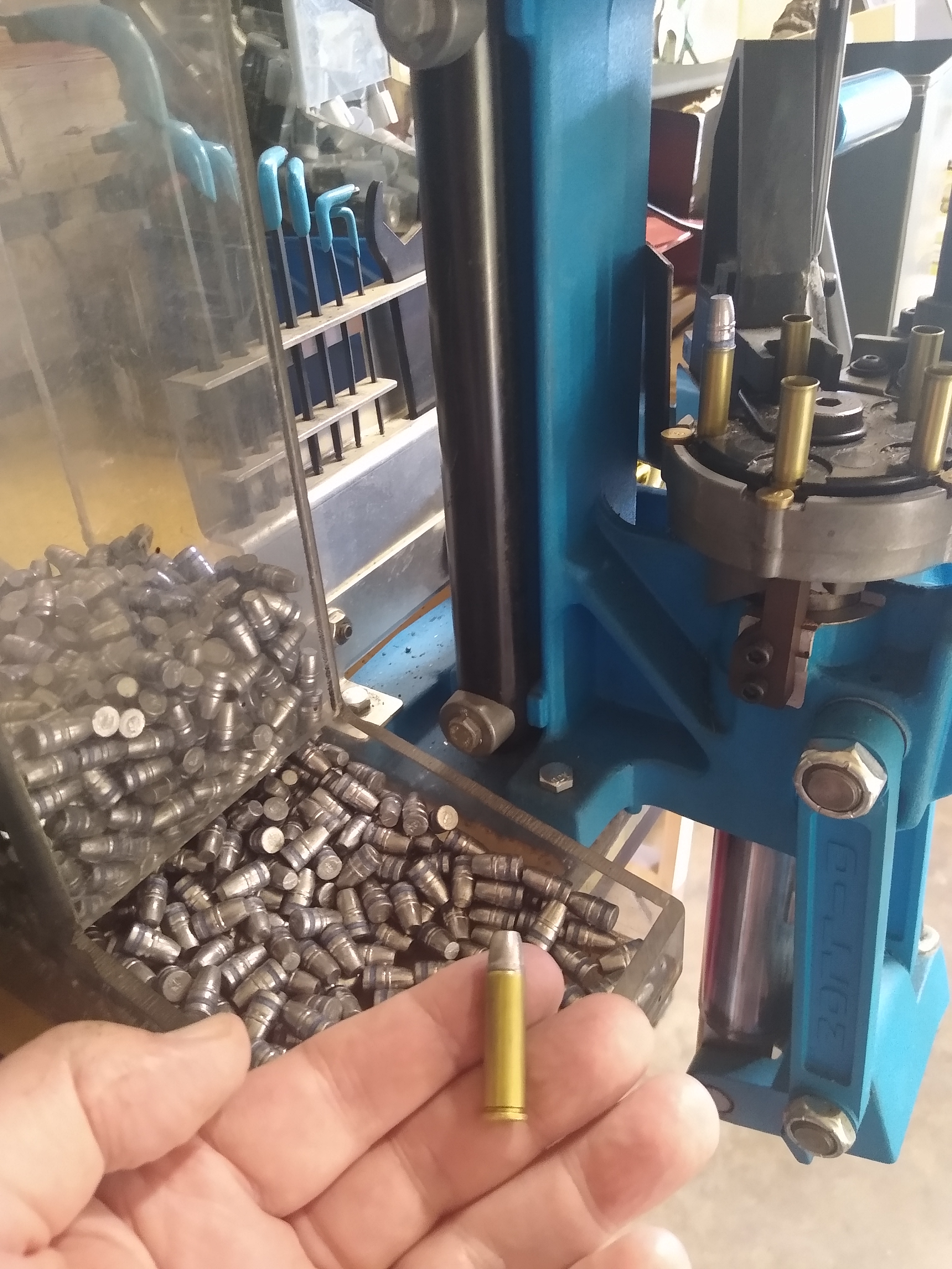

yeah, all of the remaining and past reloaded ammo i have/had was lead bullets. but as i clean after every range trip, i look into the barrel, and cannot see much in the way of a problem.
not that it's not building up to my naked eye, but seemingly clean.

my question though, is why are there different sized .45 ACP bullets?
would the 451 be the most popular?
if i bought the 452, 453, etc, do i have to expand the mouth of the brass more?
this is where i am not understanding, and i haven't found (or maybe i missed it) in the reloading manual that i have.

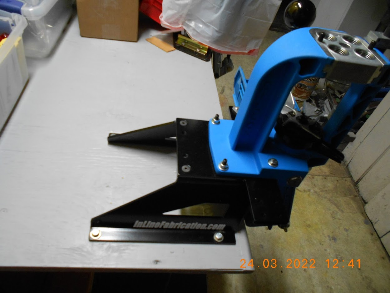

UPDATE: March 24, 2022

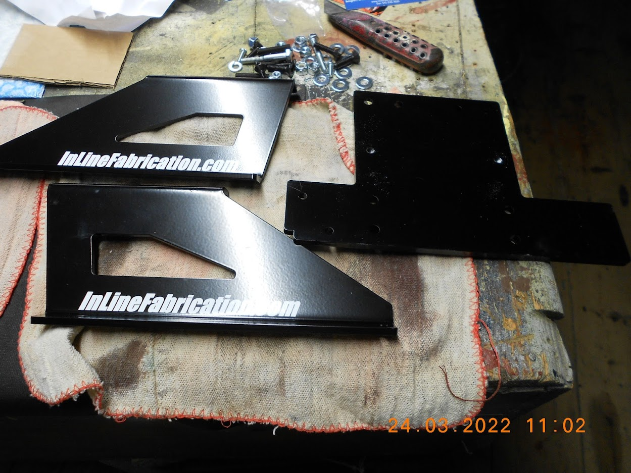

my Inline Fabrication 4" bench mount came in the mail today, actually arrived a day earlier...!!
and from the Post Office....earlier..?????

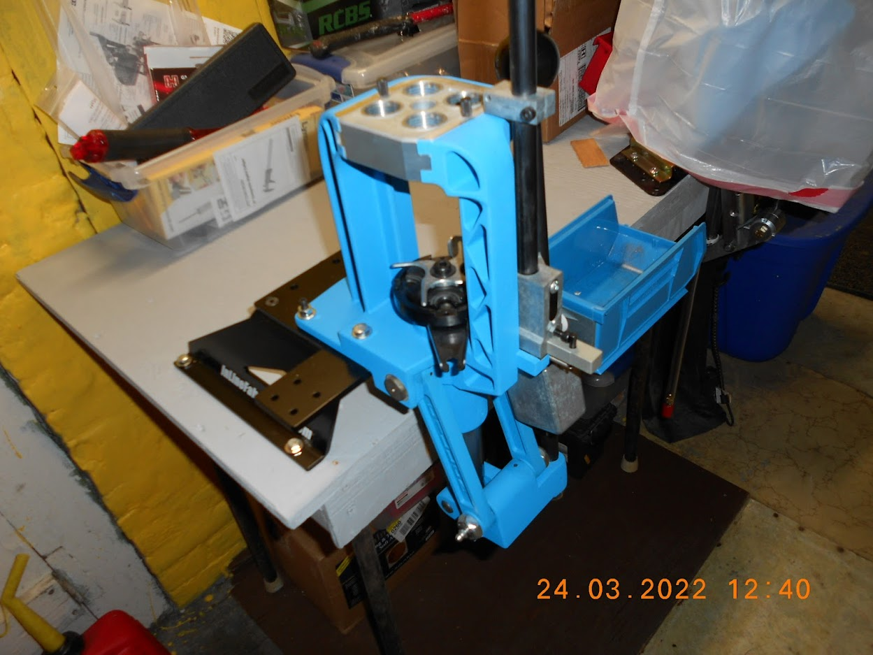

well any way, i just got myself cleaned up. there was an issue of 2 with fitment to the 550c, the pics will explain them.
first, they give you a really neat "sticker" which i promptly attached to my photo back board, and it was lucky for me, that there was a good spot for it.
here it is, out of the box

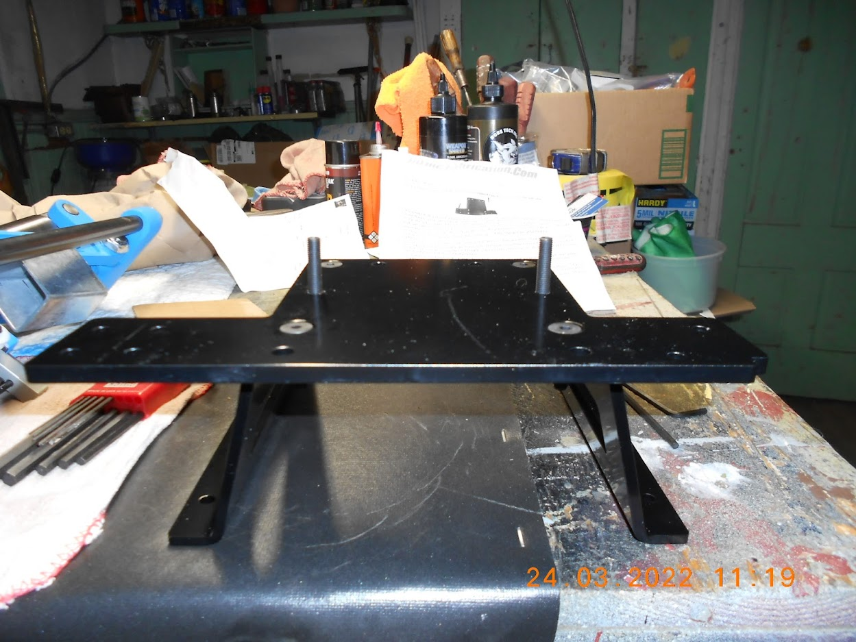

here it is, part way set up, and the first "issue"
see those 2 studs sticking up? well you're supposed to install them first, then mount the press.....however, the hole pattern was slightly off, so i had to very carefully, with a round file, make the left corner hole in the Dillon a tiny bit larger to just get it to mount.

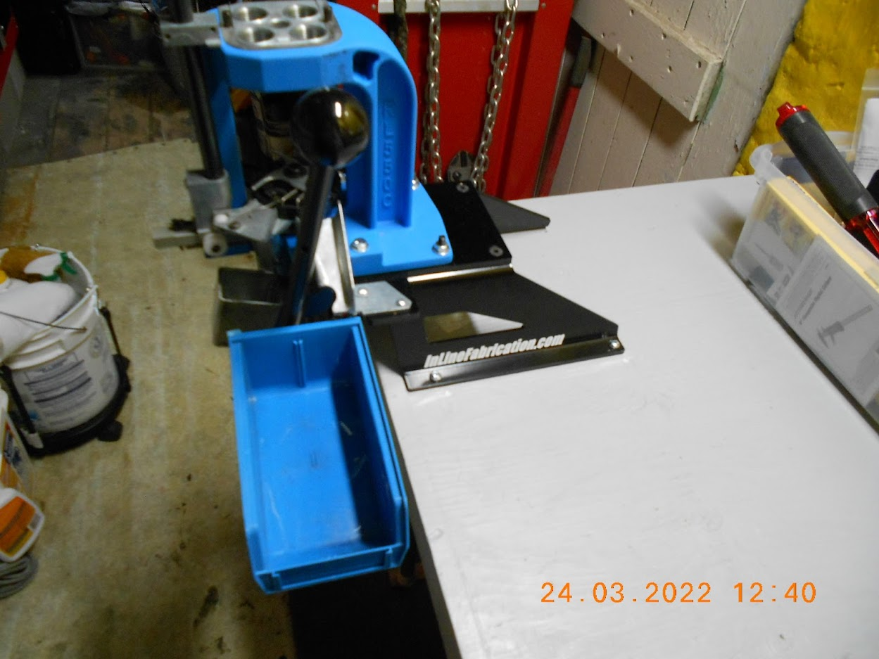

the next issue, was on me. i had to drill holes in the bench, but even though i carefully placed the mount, the ram handle would touch the bench, so i had to re-drill 2 holes, and bring the press forward a bit more
for a Dillon press, the mount has "tabs" on each side. this one on the left to the bullet holder tray, which i might not even get one.
and as you can see, there is also a tab on the right, for the newly finished cartridges tray.
took me about an hour to assemble, mount the Dillon, clean up.
and in the end, for my particular bench, which was home made, this was the best way to securely mount the Dillon.
as i had also bought the mounting plate for the Lee as well, and that shows in previous pics.
now, a few more things to do, and i'll be "practicing" on these presses for a while, before i crank out real ammo.
